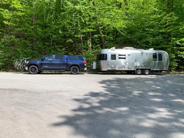

    I have a 2008 Base Crewmax with 1320lbs of payload. Also, your payload includes a full tank of gas.
    I tow a 7,000 camper & have added Blsteins, rear sway bar & “E” rated tires & a Reese straight line hitch. I have over 25K towing this rig. My rig is stable with no sway. Stay away from long grades over 9%(think Teton pass, 10% 6 miles, 10K’...not good) and you’ll be fine. Also, learn how to manually downshift for downhills also.
    I have been to the CAT scales many times & suggest you do the same. You will learn a lot. Stay under your axle ratings and you will be fine. Also make sure your rig is level or a hair nose down after applying weight distribution. Also, your GCVWR(combo weight, tk & Tlr) should be around 16K, so you are fine as far as that goes.
    Here is a pic of my set up.
