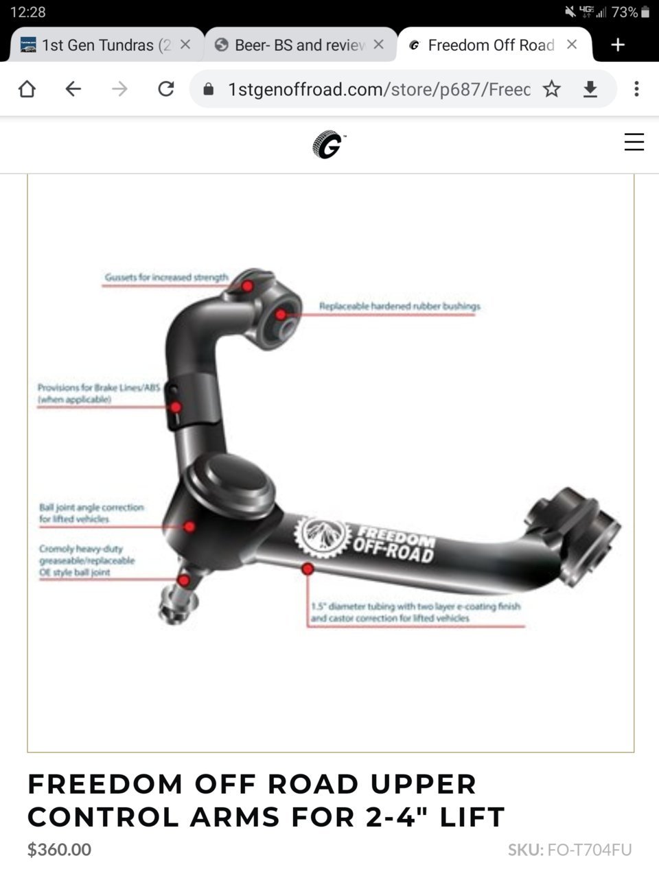

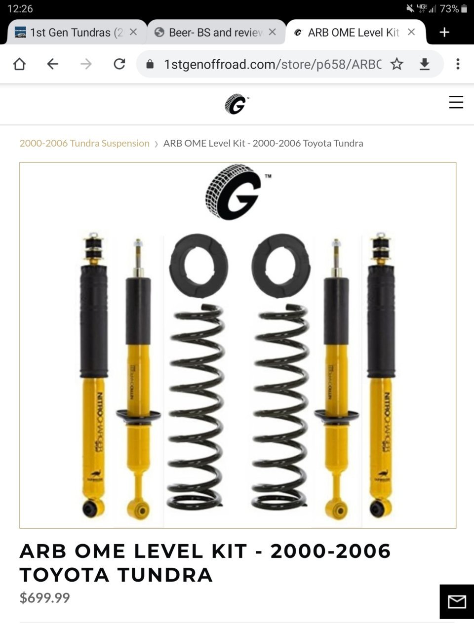

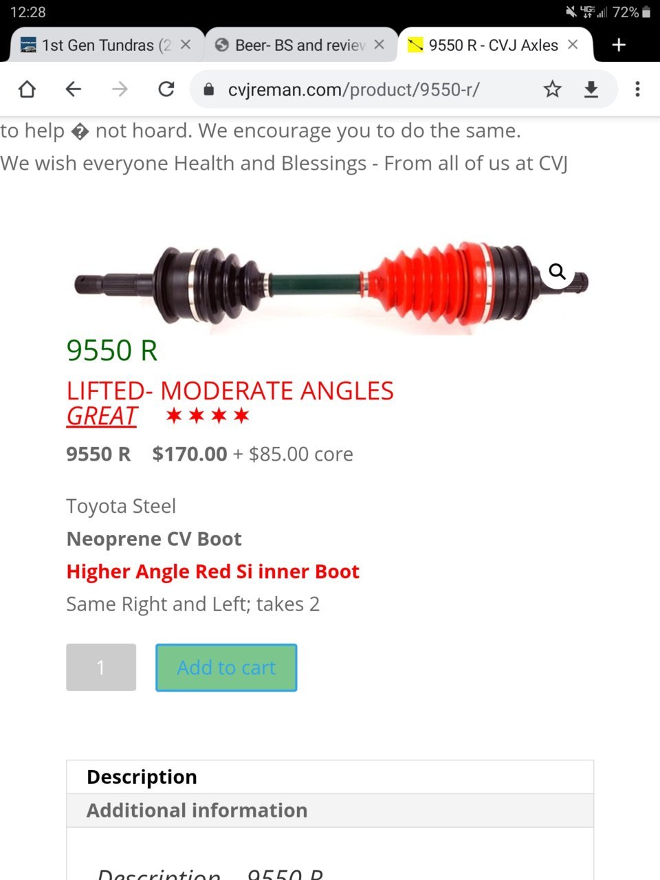

    Ok, I think I've got it fingered out.
    Quick recap:
    I'm after leveled, and do almost no offroad, but would like to be capable if the need arises. I need new springs all around. I dont wanna lift the rear.
    So I think this will be what I do:
    Front springs/shocks, rear shocks
    Rear springs
    If I'm gonna get new UCAs anyways, might as well get good shit.
    My drivers boot is torn so I'll replace both anyways.
    Throw in a new rack and outer tie rods, cam bolts, PS pump, and I think that should handle all my suspension stuff.
    Now, is a diff drop kit neccessary with this? And anyone running the OME wanna chime in?

    imDementeD
    imDementeD New Member
    May 30, 2019
    #31182
    694
    2003 Tundra Limited 4x4 Trd Supercharger
    I think the OME setup is a great option! I did go with heavier springs as I have a winch/steel bumper and plan sliders/armor but I will say the 886 springs lifted higher than I expected. I'm sitting at 23.5" from hub to bottom of fender flare.
    With the 885's and nothing in the rear, I don't think you will be level. Typically 2-2.5" front + 1" rear levels out. I think the 885's will minimum 2.5" up to 3" in the front.
    Still, a great choice but consider a block or AAL in the rear if you want to level.
    Overall, you have a great list put together!

    I'll take some measurements before I order. They also have a kit with 1" AALs for da rear.
