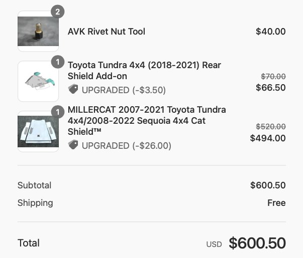

    Thanks for this post ! Have the same truck. Bought the same kit, and used the promo. You saved me $30 with the promo, and undoubtedly $5k+ with the kit. $600.50 out the door for all 4x Cats and 2x Rivet kits.

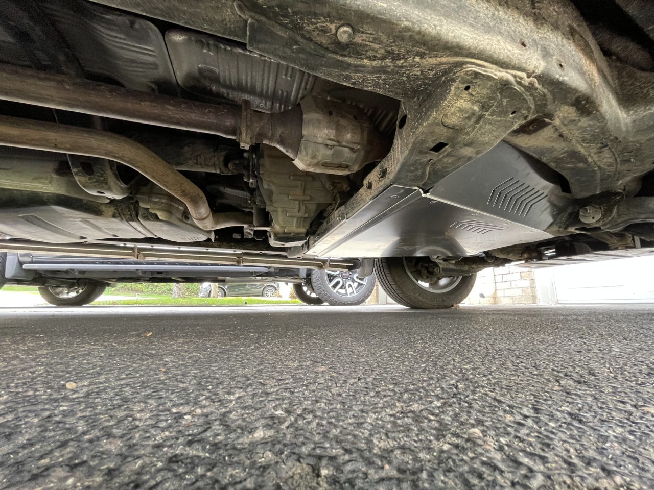

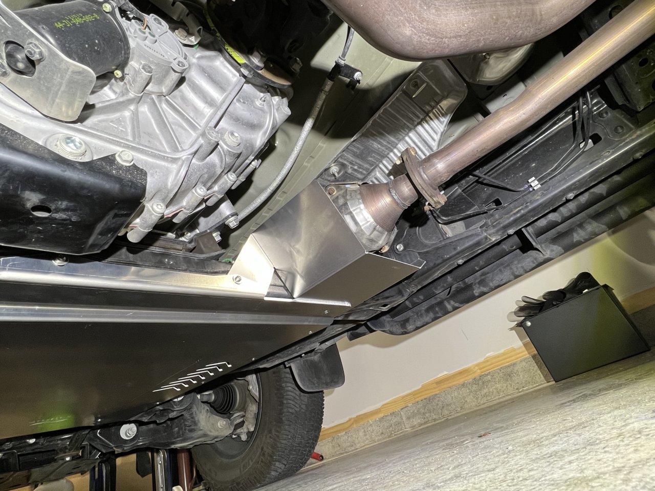

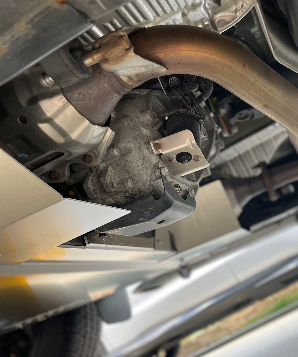

    Here are a couple of shots of the Millercat add on pieces to protect the rear cats.
    Mike59 likes this.

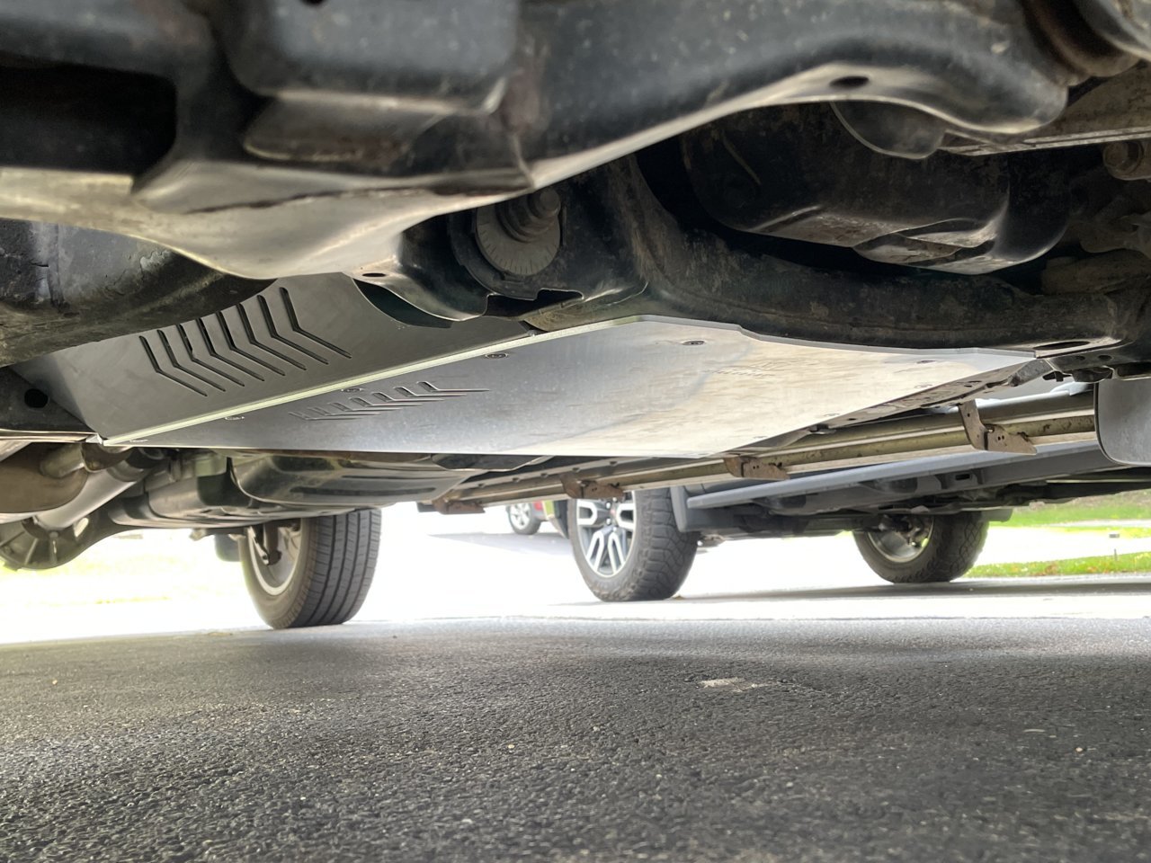

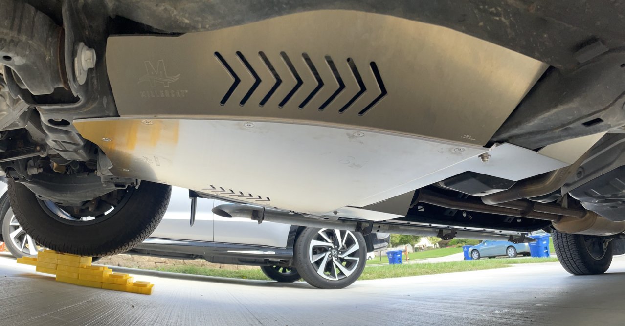

    I installed the Miller CAT plates and rear shields today. Whole job too a little over an hour. I used a skateboard and block to float the plate into position. Then a clamp to jack the 2x 1/4-20 bolt holes into alignment on the read of the plate. Simple one-person job.
    Got everything loose fit. Used the Red Loctite and an impact gun on the security bolts. Really pleased with the protection. I ordered 2x Rivet Nut Tools. You only need 1x.
    My one recommendation is on the rivet nuts; make sure to take a look at the small channel in the rivet nut and make sure its flattened out and the nut is drawn in completely. It'll appear as a curved recess before the threads towards the head of the nut, originally. Once tightened, all you'll see is threads.

    I have the same truck and got the same kit. Thank you ! I also didn't need to raise the transfer case. I used a box wrench on the drives side to tighten the bolt to the frame. I used a 1/4" socket with the security screwdriver fitting on the drivers side main panel rear small bolt as the transfer case was in the way. No need to move it though.

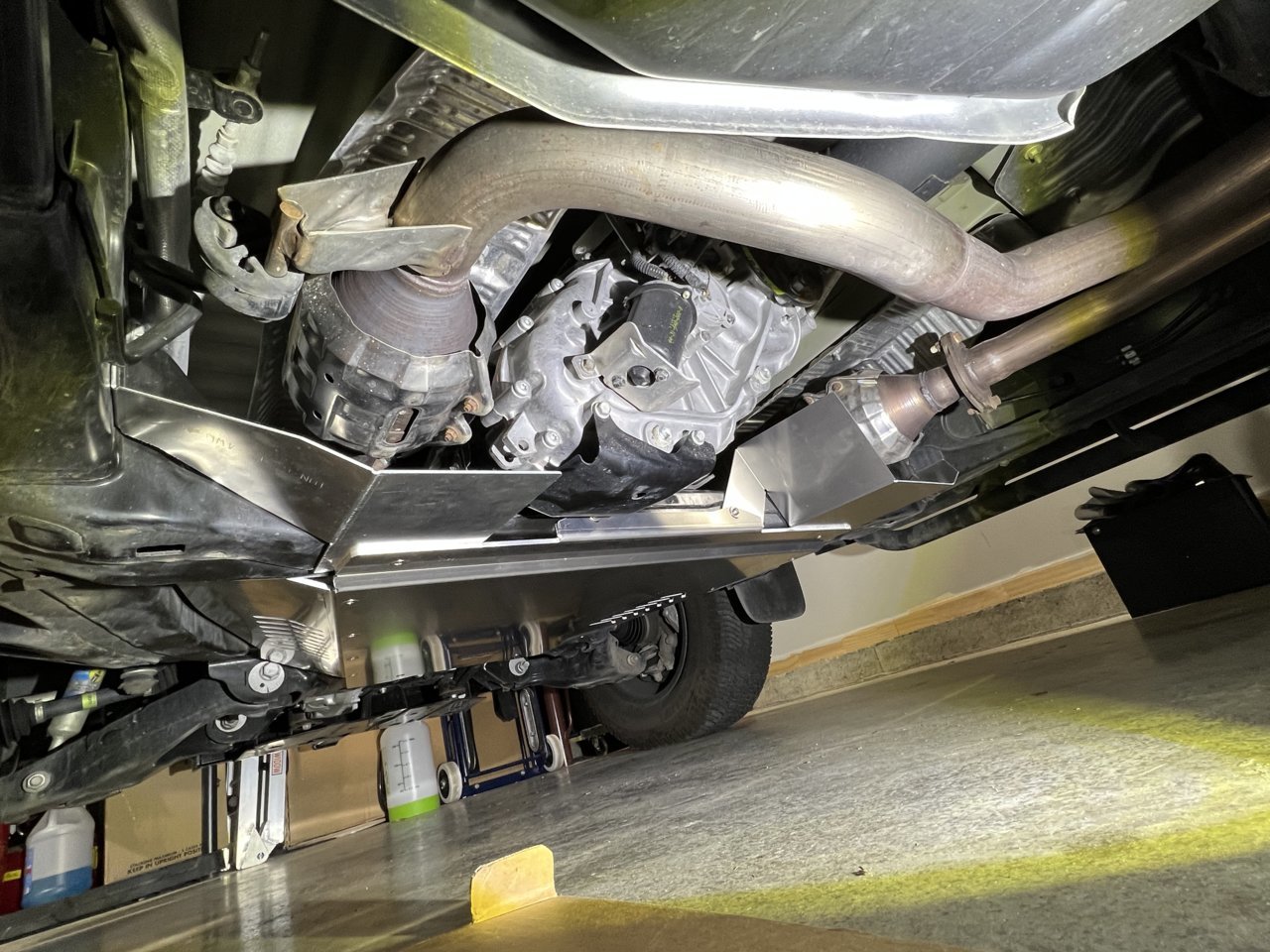

    I just got MillerCat shields installed on my 2020 1794 Edition.
    Getting the rear cat installed soon.
