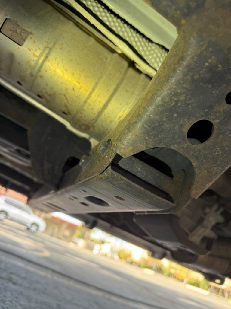

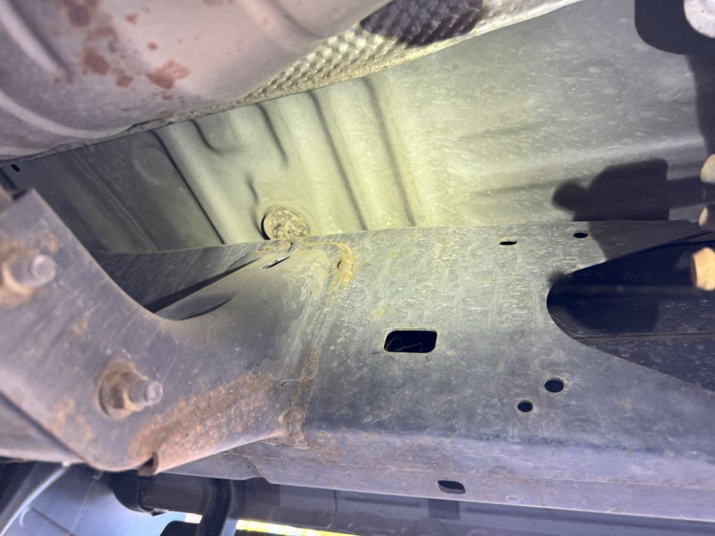

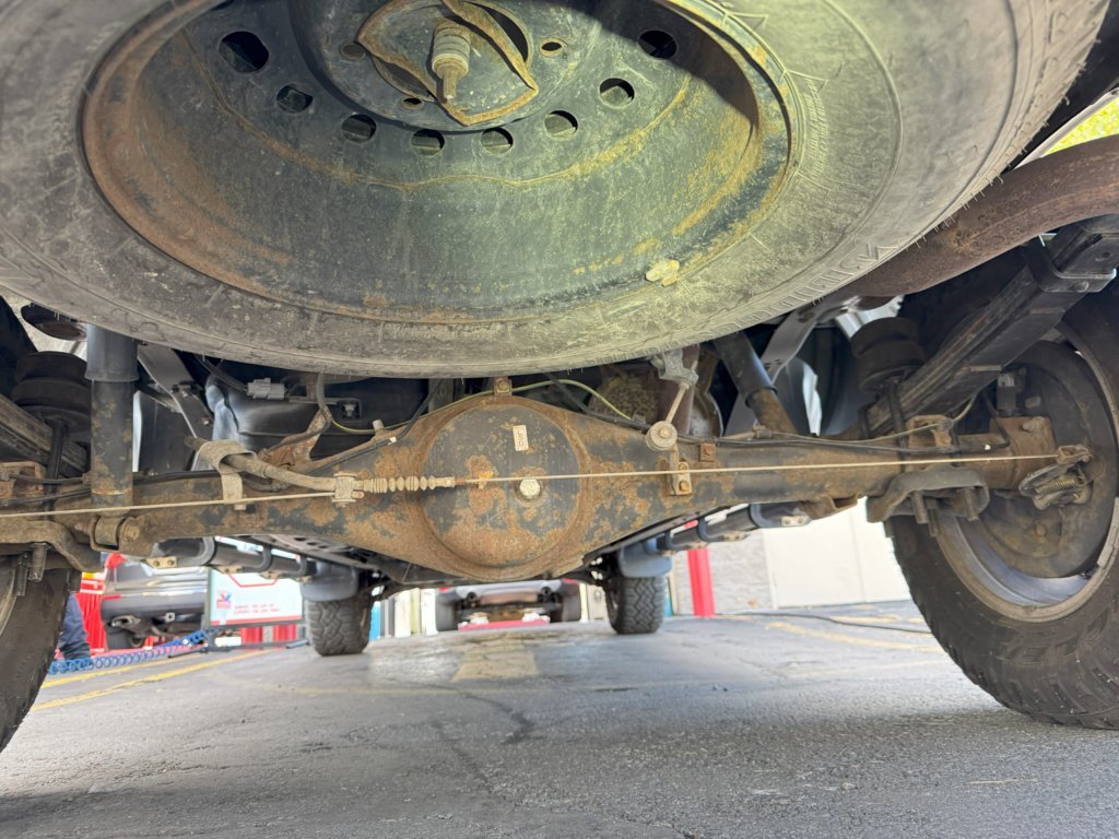

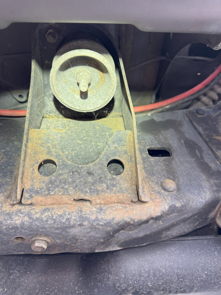

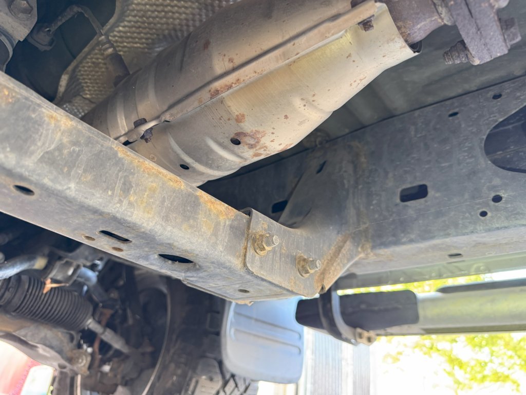

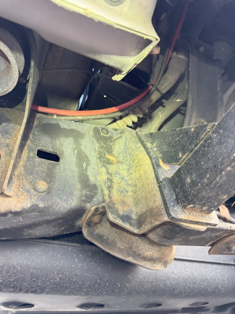

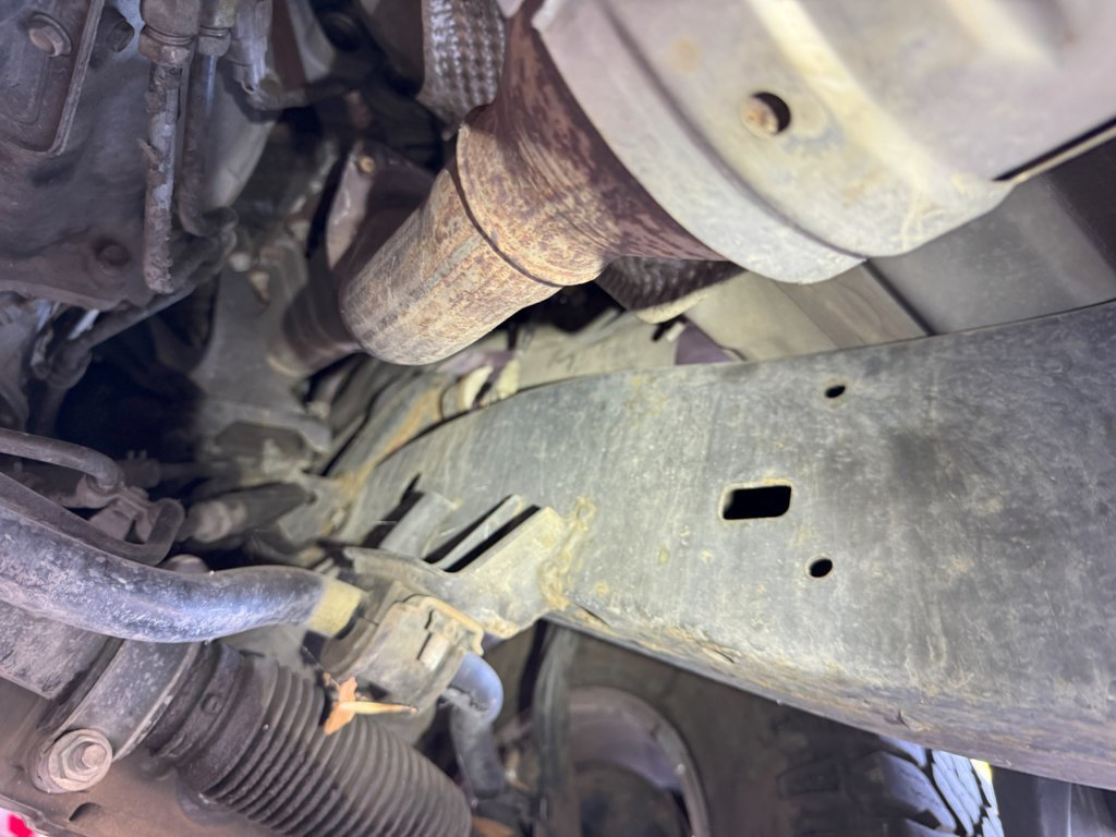

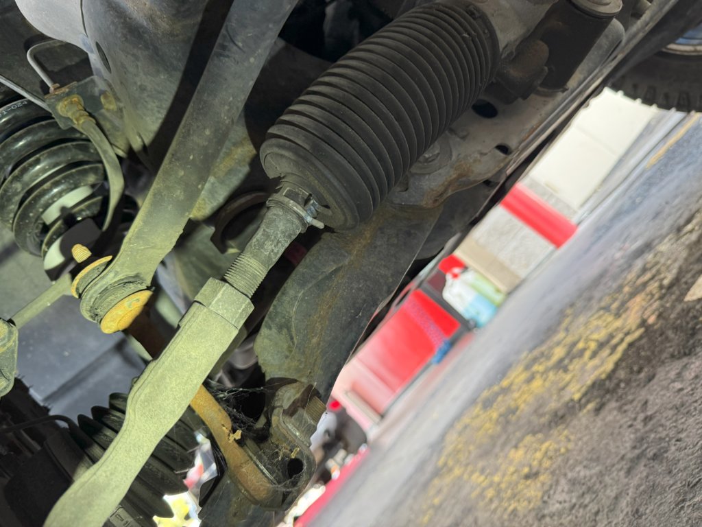

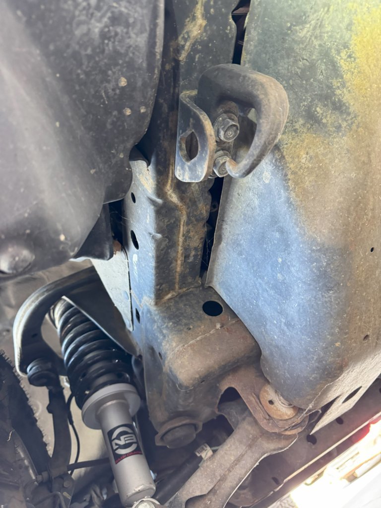

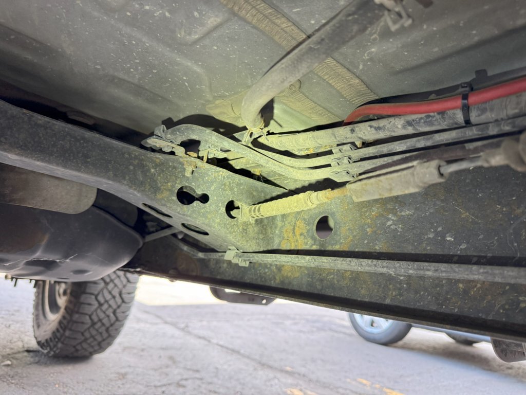

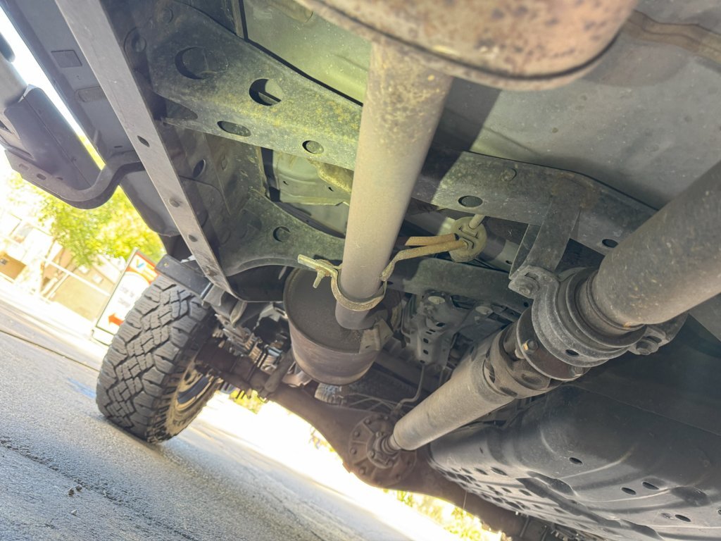

    Hi all,
    This is a Nevada 2005 that I'm hoping to purchase today. Does this level of rust look normal/ok? Just checking because of all the forum warnings about frame rust.
    Thanks in advance for any advice!
    Paul

    Surface rust. You’re fine. Your rear pumpkin is probably the worst and that’s easy to clean up.

    That is likely in the top 10%
    Not bad at all
    Easy to touch up with some rust converter and a good coating of paint or undercoating.

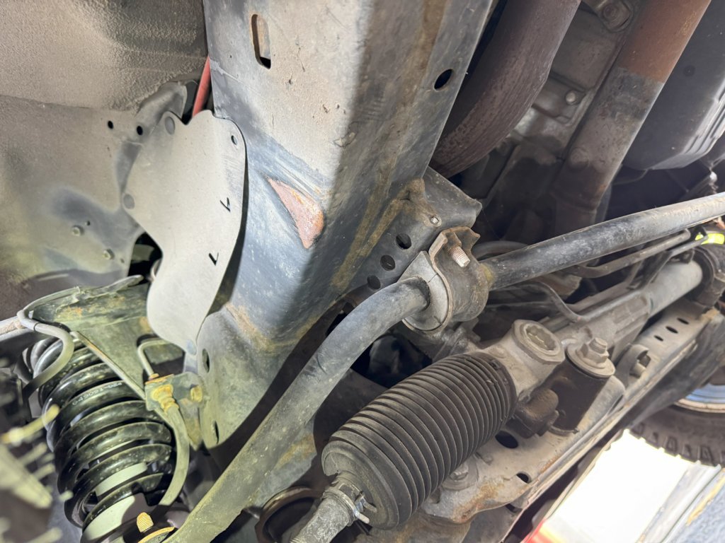

    No problem. Other than the Rough Country suspension. Easy switch though. Also looks like you might have a leaking seal in the steering rack. What is the asking price? More pictures are always good.

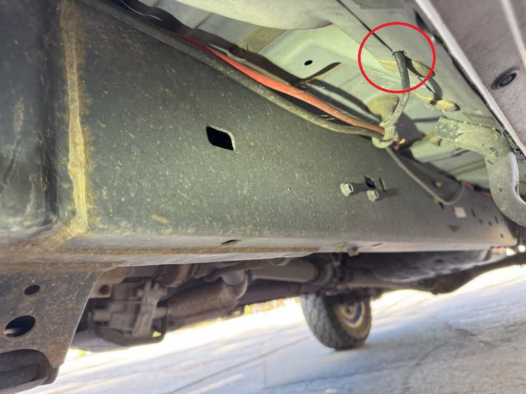

    Looks fine but deal with that rear axle housing.
    Note someone has been wiring random shit on the truck. And there is a large gauge power wire, unprotected, unloomed, just zip tied on.
    Also, you have LSD rear and need to be careful about what fluid goes in the rear diff.

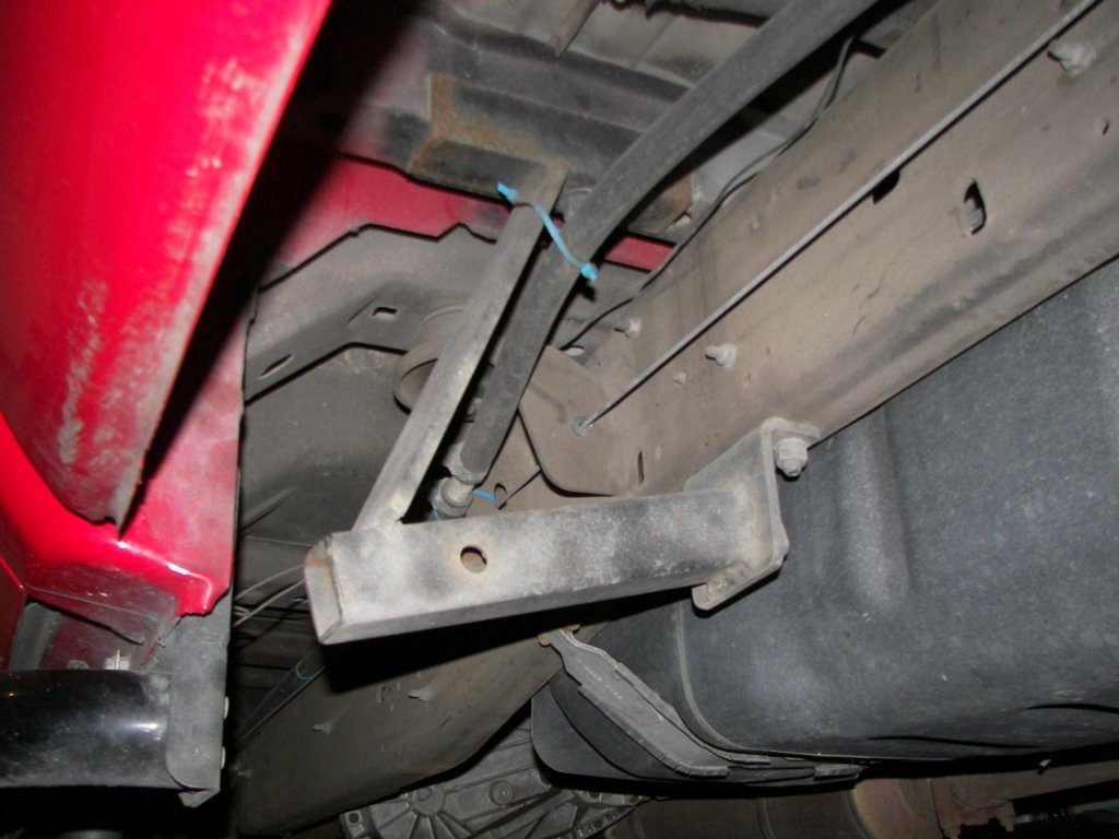

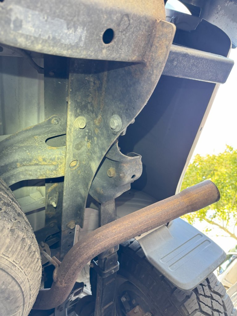

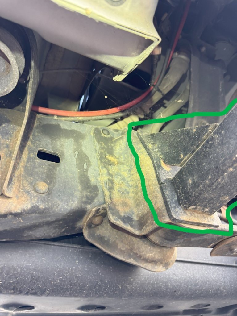

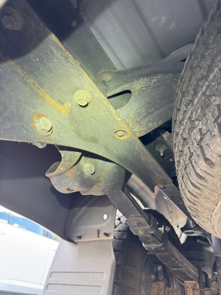

    I'm curious what's going on in these pictures below. It looks like someone welded some tubing right onto the passenger side front spring mount (driver's side as well, perhaps, but there are no similar pics). I thought perhaps a slider, but the OEM step mounts are clearly visible.
    Also, your rear leafs appear to have been upgraded at some point. You may also want to evaluate the tire/wheel combination, since it appears to be rubbing.
    Ditto on the red wire...do you have a camper top perhaps? Let's see some pics of the outside!

    If you look close you can see that what you are pointing out is a 2" receiver hitch welded in. If you look closely you can see there is one on the trailer hitch as well.
    My guess is, with the big rear springs, big rear bump stops, front lifted struts/shocks/springs, and big 2 gauge wire running to the bed, that this didnt have a snug-top, it had an actual camper, the big wide ones that slip into the bed. The big 2 gauge wire probably ran a 3000w inverter and then my thoughts are that the 2" receivers at all 4 corners of the bed were either for a slide in extension that you then ratcheted the camper top down to, or it was for someone to slide in the 2" receiver steps so whoever could slide in a step and climb up over the bedside more easily. I am going to lean more heavily towards big slide in camper tie downs though.

    What rack leak? That's nothing horribly noteworthy. AT-205 will refresh the seals and shore up things, but it's barely wet, I doubt you really have a serious, highly-active leak. My bellows are similar.
    The KARR alarms fucking suck. Dealer add-on. I'd make it a priority to get rid of it. Can get instructions if needed.
    Fobs are easy enough to program for the system that'll be in your truck. Figure out which method to use for entering programming mode (there are a couple for the DC) and go from there.
    The Rough Country struts up front are garbage. Also, clearly the wheel/tire combo and alignment are shit because you can see rusty rubout on the frame.
    Swaybar bushings are over-compressed and probably need replacement.
    No pics of the lower ball joints. I see one in the background and it looks like everything around it in condition, so I'm going to assume they've never been replaced, other than under the recall. I'd make it a point to replace with new OEM LBJ ASAP, and remember 8 fresh bolts (4 per side). This is not a place you can trust aftermarket, and if they're using Rough Country struts up front, rest assured, the previous owner was a tightwad with money, or didn't know any better.
    Now I'm on a computer again, this is an example of scary as shit wiring. They drilled straight thru the bottom of the cab to run this wire, didn't bother to grommet the hole (!!!!!), have unprotected voltage-carrying wire (the red wire) just zip-tied to random ass shit, and I don't even know what the hell that wire is dangling down by the framerail. I'm going to assume they drilled the cab in that spot to run a backup camera but ... dude, there's literally a plastic plug on the other side of the framerail from here, making this pretty egregious fuckery.
