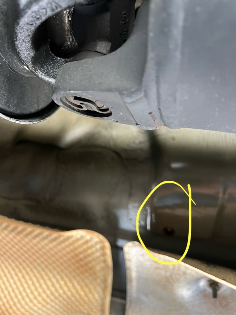

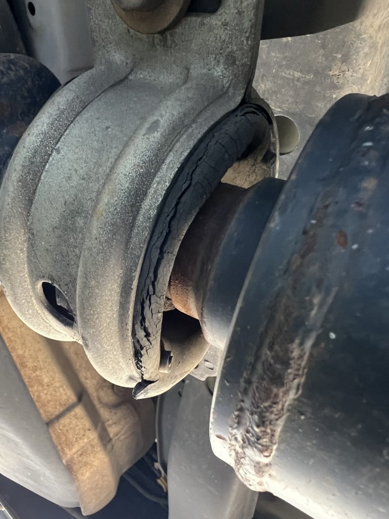

    I'm sure this has been discussed before, and thinking about just firing the parts cannon at it but thought I would document this anyway to see what the consensus might think about it.
    Recently, just in the last week or so, I've noticed a new shudder - not sure I'd even call it a vibration and certainly not a clunk - that only presents when accelerating slowly between a dead stop and about 15 mph, then it all smooths out. By shudder I'd describe it as if the truck is rolling over a subtle cobblestone road, and I can feel the bumps through the whole truck.
    What I know so far:

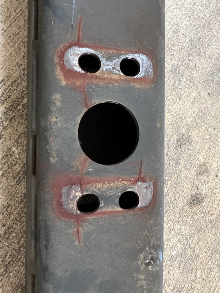

    • My transmission crossmember is cracked - it's been cracked since I first had a popping issue some 7 or 8 years ago, I tightened the bolts then and never heard/felt said popping since. I just checked the bolts and was able to tighten them another 1/8-1/4 of a turn. I have not driven the truck yet today. I'm at the point I'm fully willing to just replace the crossmember, knowing it's cracked even though tightening the bolts "fixed it" so many years ago

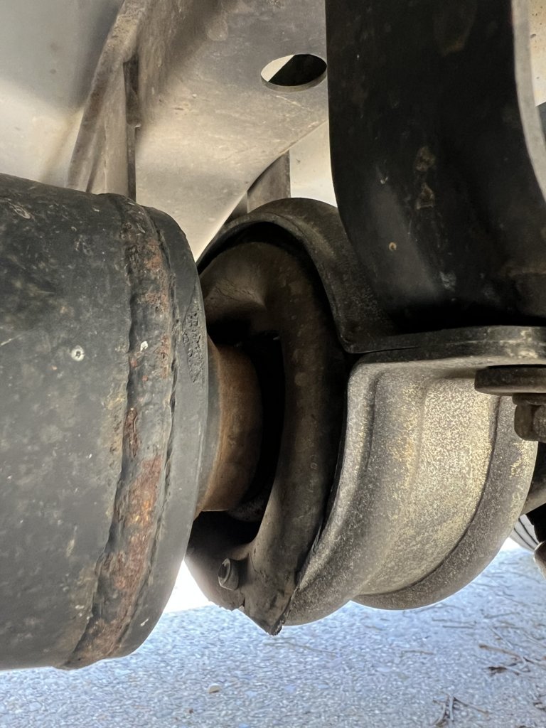

    • My carrier bearing looks bad, and the driveshaft is visibly not centered in the support as it's sagging, but I've also read many threads here talking about just how awful theirs looked but replacing it fixed nothing - I still figure it should be replaced
    • U-joints - I'm a 2wd, so no grease fittings, and since I don't have constant/more frequent vibrations at higher speeds I'm inclined to think these are fine - but the question to the group, I'm at 194K miles - if I am already down there pulling the driveshaft, should I just replace all 3 anyway?

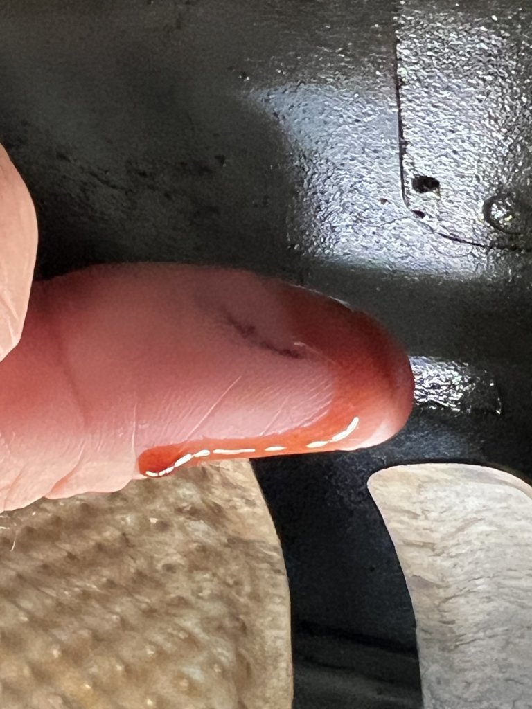

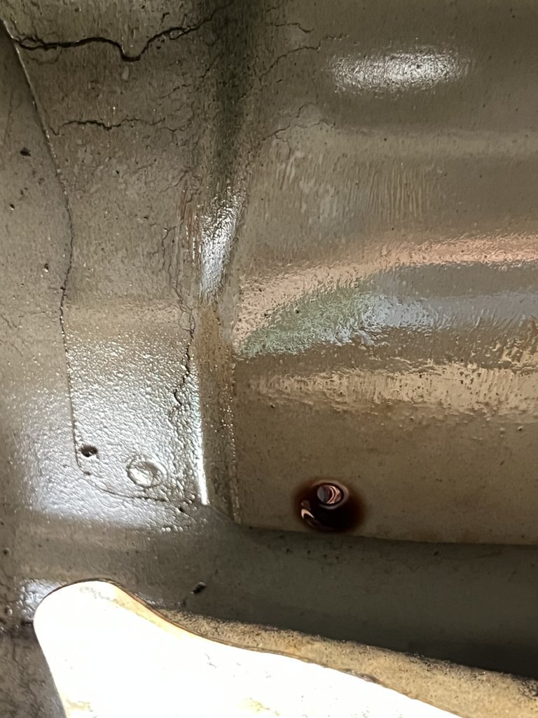

    • Transmission fluid - hate not having a dipstick - I see fluid on the tunnel, so I can only assume I might have some seeping out of the tail of the transmission and maybe the front U-joint/driveshaft is slinging it onto the tunnel. So today I hope to check the level of the fluid - did I mention I hate not having a dipstick - and if low I will add fluid. For what it is worth, there are no drips hanging off of the tail end of the transmission, and I have never seen a single drop on the ground anywhere under the truck.
    • I am likely due for a drain and fill anyway as I last did it in 2018 about 65K-70K miles ago - if I do feel like there is a leak at the output shaft seal, hopefully would become obvious when I remove the driveshaft, I'd replace that too but not sure how common that is and if the fluid I'm seeing supports that theory
    I think that's all that's crossed my mind - again, I'm not really all that hesitant to do all the things - drain and fill (and change the output shaft seal), replace all 3 U-joints, replace the carrier bearing and replace the crossmember. The ol' girl deserves it anyway - but just want to make sure I'm not overlooking anything in the process, or how my train of thought tracks with those here who may have experienced this.
    I'll add pics in the next post.

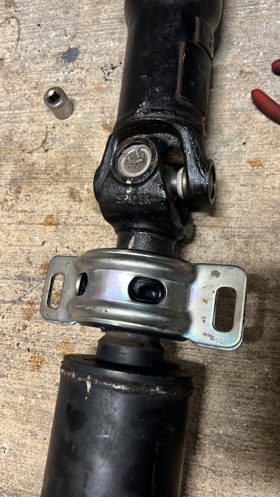

    1st things first, that carrier bearing should be replaced. Get Spicer (/Dana) replacement, Spicer is the OEM that Toyota used for the driveshafts, carrier, u-joints. Note there are two part #s for our trucks, be sure to get the correct one. Be sure to mark the driveshaft positions so the two driveshafts get reinstalled clocked the same way in conjunction with each other.
    Crossmember, the TSB is in the megathread sticky (search for the word "TRANNY") and the part number you need is in the TSB.
    If you do replace the u-joints, 200k is a really good lifespan, it's about time. Again, Dana/Spicer, and your option whether to do sealed or zerk'd. Again, mark your driveshaft positions, although, frankly, I have a driveshaft shop near me that will replace u-joints for about 20% more than I can get discounted parts, and same is true for the carrier, and they only use Dana/Spicer, so ... maybe you have the same, if you don't feel like doing the work.

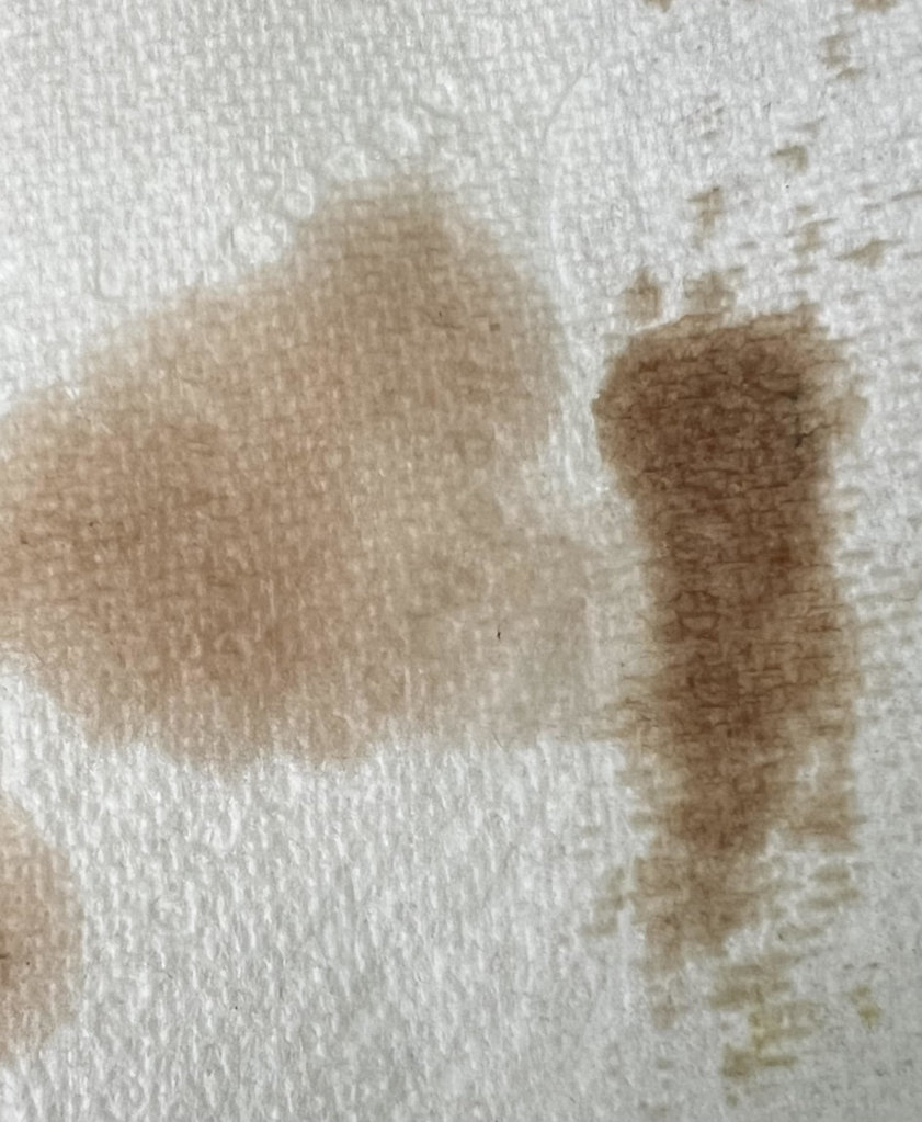

    Transmission ... I can see an output seal potentially dropping fluid, but you should be seeing it under the truck, and the valve covers and half-moon plugs are more prone to leaking than that sealed trans is. But I'll tell you, if that is transmission fluid, that's awfully brown/burnt looking. Does it still look brown when wiped on a white paper towel, or does it look more burgundy, any red hue at all?

    Definitely planning to replace the carrier bearing, but was surprised to read in several other threads how frequently despite looking like mine or worse, it wasn't the solution to the vibrations the users were experiencing.
    I haven't found anything about two part #s for the carrier bearing, unless you're referencing 2wd vs 4wd trucks - can you confirm/elaborate on that?
    Oh I 100% have oil leaks as well - again, it's never been enough to see a single droplet on the ground and my dipstick never reads low in between a normal 5k change interval, but the engine is a general mess from at least one if not multiple places. I plan to try and have that tackled at my next timing belt change within the next 6 months. So I did consider this may be engine oil just finding its way down to the transmission tunnel, and in fact find that to be most likely given the lack of any visible drips off of the yoke shroud at the tail of the transmission.
    Here's a pic based on what I rubbed off of the transmission tunnel (which is not exactly clean) and laid alongside some oil from the dipstick which has about 4k miles on it. I think there's a bit of a red hue there, would argue it's definitely not new but it's not burnt either. This transmission fluid is almost 7 years old with somewhere in the neighborhood of 65K miles. Again though, never seen a single drop on the ground of any fluid of any kind so any leaks I have are seeping at best. Worth noting perhaps I also changed my radiator about 8 months ago which may have resulted in a little bit of transmission fluid loss, but should not have been much. Either way like I said I'm due for a drain and fill so I'll make sure to do that soon - I just want to ensure if there is a seal leak I take care of it at the same time.

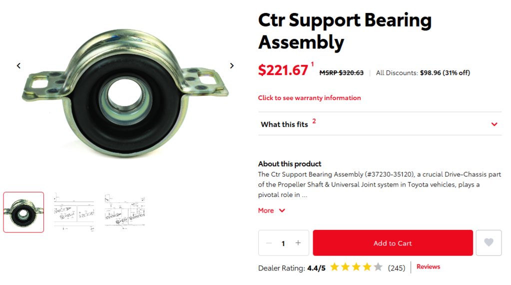

    2WD and 4WD are different parts, and almost none of the online vendors get it right, and they don't even give you the truly correct part# out of the (three? four?) Spicer parts that will technically "fit". So there's two places for them to screw up: 2WD vs. 4WD and there are two or more variations that will show in systems as "fitting", although not all of those are OEM-equivalent fitment/function.
    If you wanted to buy from a dealer (read this reply in full for big discount info), the OEM carrier for 2006 part numbers are 37230-35120 (with 2WD, any cab) and 37230-34030 (with 4WD, any cab).
    Spicer equivalent is 5002334 for 2WD and Spicer 5002007 for 4WD. The main difference (I think?) is the donut/seal is only on one side in 2WD and on both sides in 4WD? I think? But either will fit, I think? I feel like @des2mtn or @The Black Mamba was walking someone through this recently, maybe one of them can clarify that interchange point.
    All of those hyperlinks are to legit parts sources. Never buy parts on scAmazon/fleaBay/WallyMart/Temu/etc. The risk of getting counterfeits is far too high, regardless what storefront they say you're at, or who is selling. If you prefer not to use RockAuto, who usually has the best pricing, Summit Racing is similar after taxes/ship/etc. but that little extra coin buys you real humans for customer service.
    And before you say, "BUT HOLY FUCK! $320 for a carrier bearing?!!" please note: If you use the Toyota Parts site I linked to, when you select a dealer near you, each local (participating) dealer gives you a discount. I checked pricing with all three through the national parts website, and this is the standard price **IF** I initiate the order through the Toyota Parts site. If you go up to the counter, they're gonna charge you the full price, no discount. Starting your order at the national parts site is a fast and easy way to unlock 10-60% off instantly.
    If you're in/around Auburn as your name and location may suggest, I don't think Allen Turner Toyota (formerly Lynch Toyota, which is where I got my 1st gen) participates in the Toyota Parts Program, your nearest participating dealer will be in LaGrange GA, I think, which is like 15-20 or something miles over the border, right off the interstate. If you're not in Auburn, a few other participating dealers are Toyota of Montgomery, Toyota of Sylacauga, and Sunny King Toyota, Sunny King is where my truck was sold to its 1st owner.

    Got it, thanks - I'm familiar with the Toyota online parts discount process, just ordered my crossmember from Ourisman this morning, but typically my local dealer (Palmer's, I'm in Mobile now) is pretty close and I'll just order things and pick them up in person. And yeah, I saw the $320 carrier but even at $220 discounted, I'll take a Dana/Spicer for $60 from RockAuto - the only place I buy parts other than from Toyota - all day everyday.
    I am now wondering if both the 2wd and 4wd versions will fit, why wouldn't I want the 4wd one with double seals?

    Hmm, I do like a good science experiment. But I'll just be content to kick the can down the road another 194K miles and go with the recommended part for my truck. Plus the 4wd one is $80, and 20 dollars is 20 dollars. :cool:
