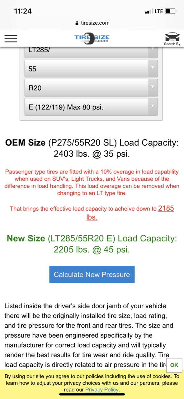

    Also, with upsized tires, the pressure will change ESPECIALLY if you’re now running a 10ply! Somewhere in my house I have the TIA book regarding proper psi for weight of vehicle versus tire size....

    And please! Use a tire sizing calculator for the proper pressures! That could fix it real quick! The tire you put on is a 10 ply (load range E) correct?
