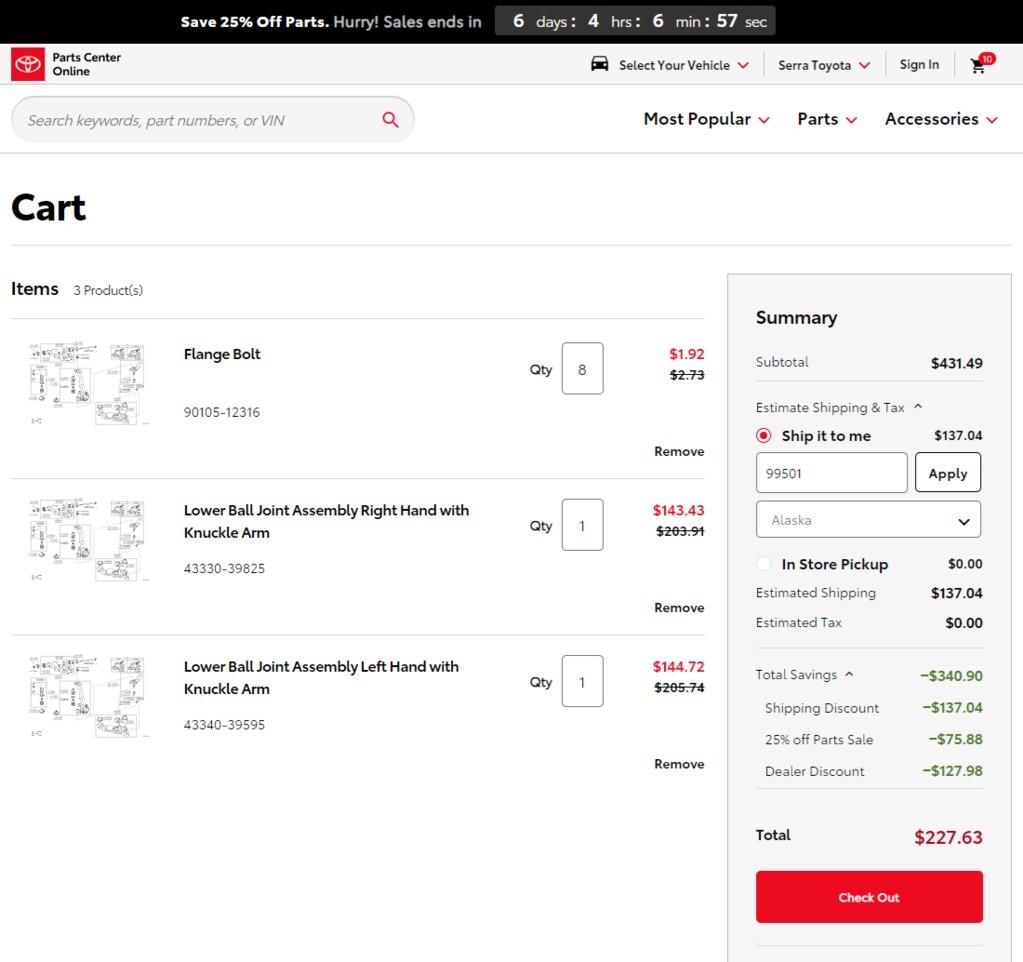

    Take the part numbers above in my image over to https://autoparts.toyota.com
    Plug the 1st part number in, search, and when you go to 'add to cart', it'll force you to pick a dealer local to your zip code.
    If you have multiple dealers, click the first one; view the price; then click the BACK button in your browser, and click the next-closest dealer; view the price.
    Go with whatever dealer has the best discount, some will be different. I have two dealers near me that charge full MSRP, like I'm walking up to the counter. I have two other dealers that give 18% off and 20% off, respectively, on most parts.
    Here's the thing: If I go directly to the parts counter, those same two discounted dealers charge me FULL MSRP. Lesson to learn: Always start your shopping experience thru the online Toyota portal. You can then order at a discount with many participating dealers, and pickup at their parts counter for LESS than what they'll charge you (sometimes hundreds of dollars less) if you simply call them or walk in off the street!
    The only caveat is, make sure you got your part numbers right. I'm 1,000% confident my part numbers linked above are correct for your truck.

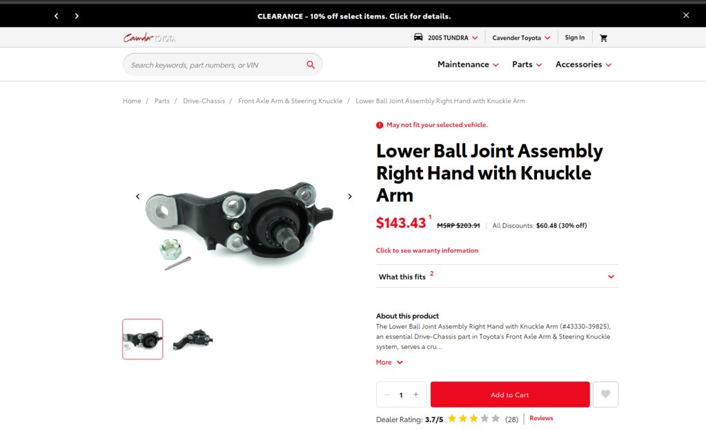

    Any idea why it would be saying that it might not fit my selected model which is my '05 Tundra?
  15. Nov 8, 2024 at 3:36 PM
    Jack McCarthy
    Nov 2, 2020
    #54409
    10,268
    Bill
    North of Boston
    02 Tundra AC SR5 V8 4x4
    Try another Toyota site and enter your VIN to confirm.

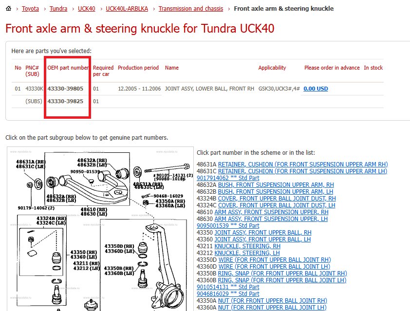

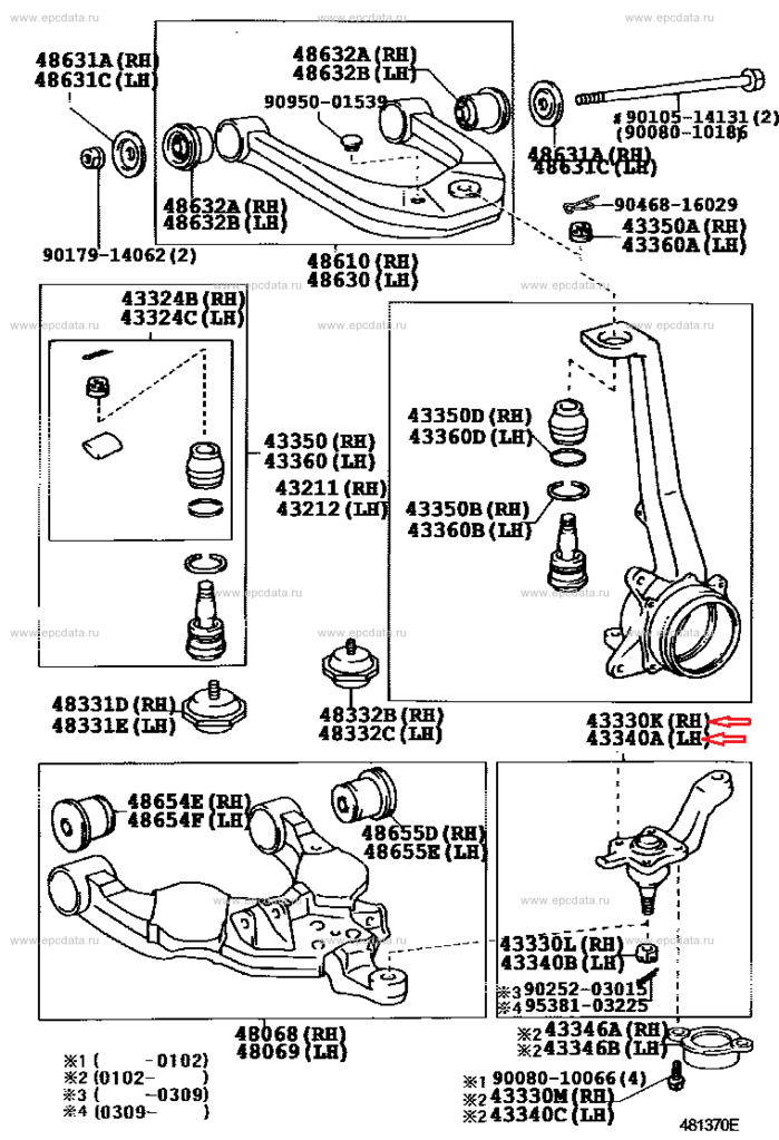

    Did you input your VIN to the Search before beginning to look at parts? You got the right part numbers, should be:
    Passenger: 43330-39825
    Driver: 43340-39595
    Bolts (you need 8): 90105-12316
    But if you want to doublecheck, do this:
    • Go here: https://toyota-usa.epc-data.com/tundra/
    • Plug your VIN into the search box, and click Search
    • Click the "Transmission and chassis" link
    • Next to the 2nd image, click "48-02 - FRONT AXLE ARM & STEERING KNUCKLE"
    • In the image they show you, click the "RH" to get the passenger part number for your VIN, then click the "LH" to get the driver part number.
  17. Nov 8, 2024 at 4:40 PM
    shifty`
    shifty` I'm having daydreams about night things
    Jun 20, 2020
    #48239
    28,433
    ATL
    '06 AC Limited V8/4WD
    For example, when I click the "RH" link inside the image, it coughs up these two part numbers. Both parts technically fit, the "SUBS" (substitute) number is the most current part number, the one ending '05' is older.
