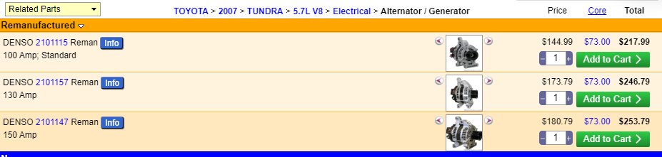

    Also, any reason not to go with the max amperage available? Rock auto carries 100/130/150 (edit: 150A it is).

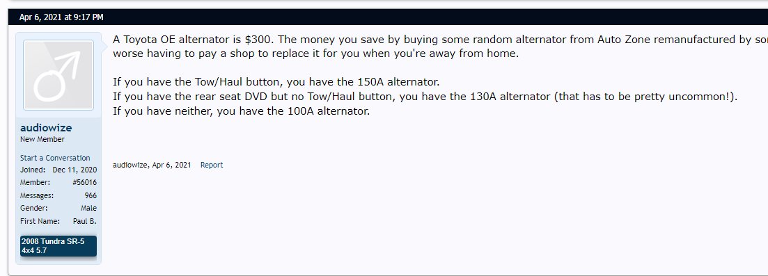

    Looks like 150A for me. Handy notes found in another thread:

    Ordered a Denso reman 150A off rockauto for $285. The local Toyota parts desk had a reman OEM for $400. They would arrive at the same time. I've always had good luck with Denso so that's the way I went.
