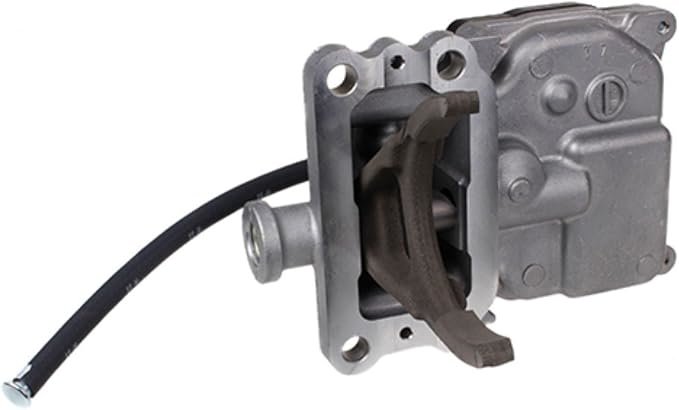

    This is the actuator. Take a look at yours for any corrosion on the actuator and wire connectors. If you need to replace get AISIN which is OEM supplier. You should be able to find it for $180-200.
