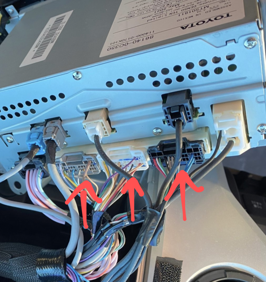

    I have 3 identical sized connectors on the Toyota headunit, gray/white/black, and this Phoenix harness only has room for two. Can someone ID what these 3 connectors do? Maybe one is not used.
    2020, p/n 86140-0c350, non JBL, factory amp

    I just installed the Linkswell Gen 6 into my 2020 Tundra within the last 2 weeks, the black / grey connector was unused in my case and confirmed with Linkswell, I know different manufacturer name but basically the same unit. I'd also bne interesed to know if the parking sensors work on your new radio screen when in reverse. i.e. mine work in the dash, but not on the radio display with the reverse camera view.
    Just noticing your post was months ago, my bad :)
