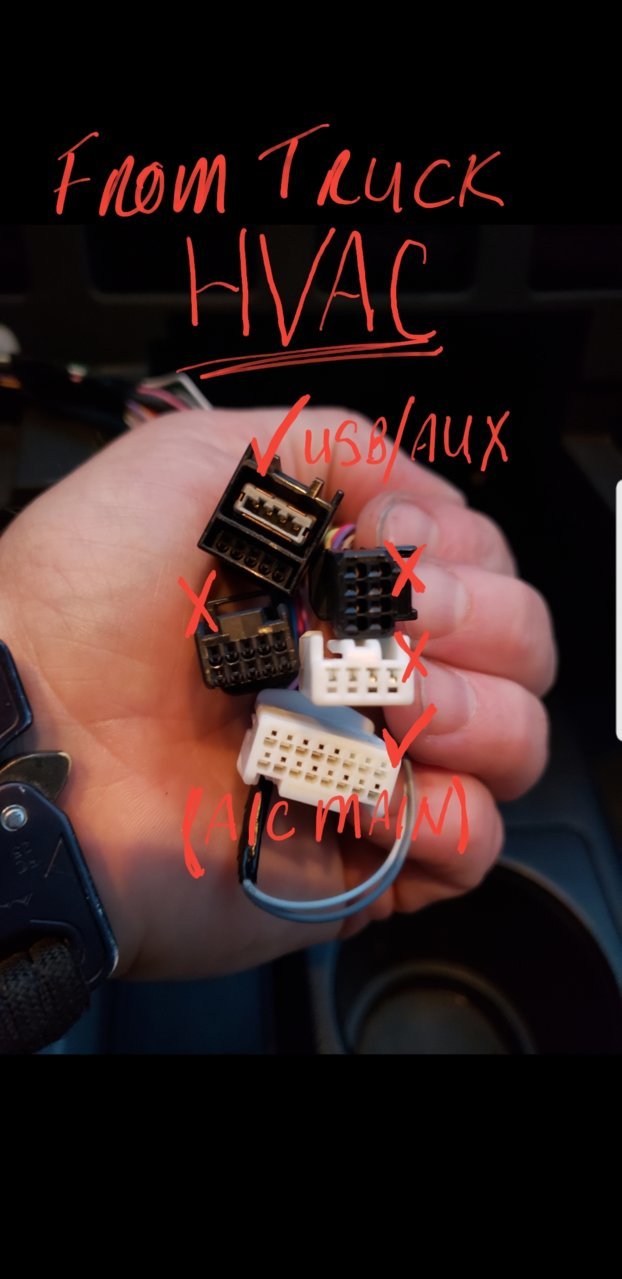

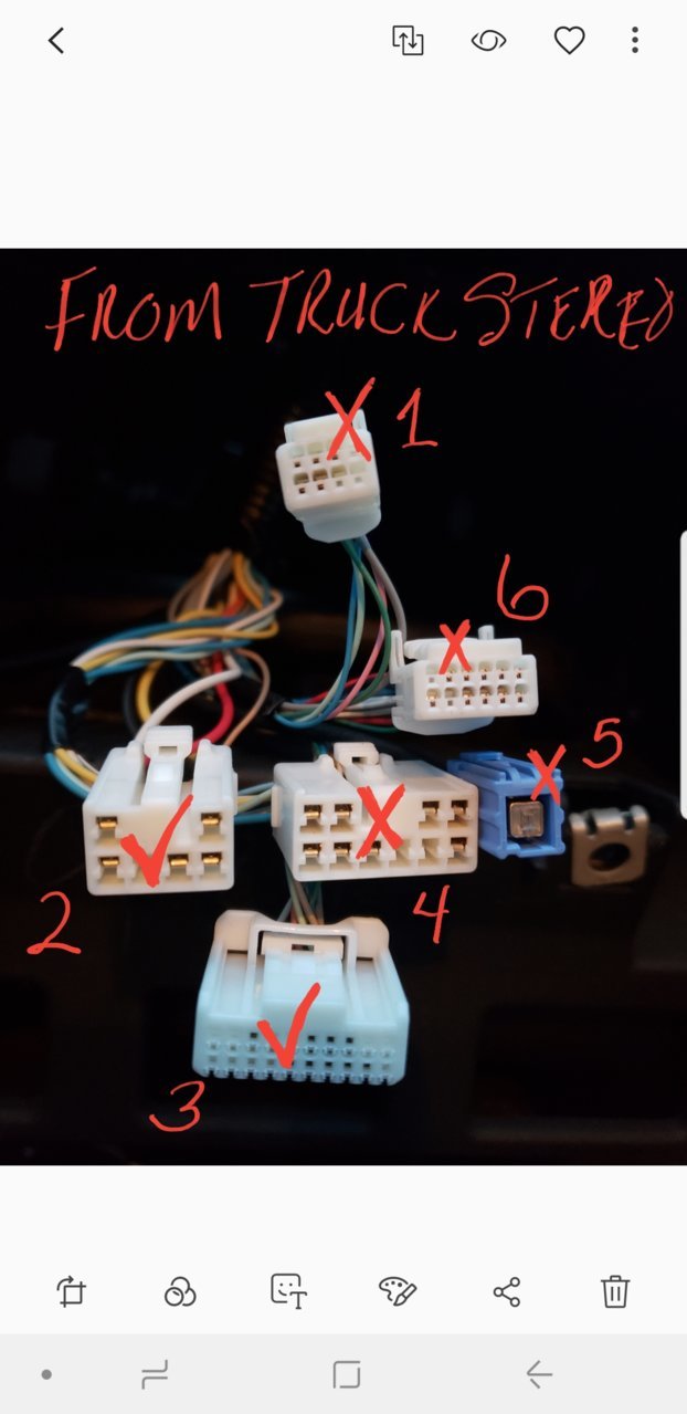

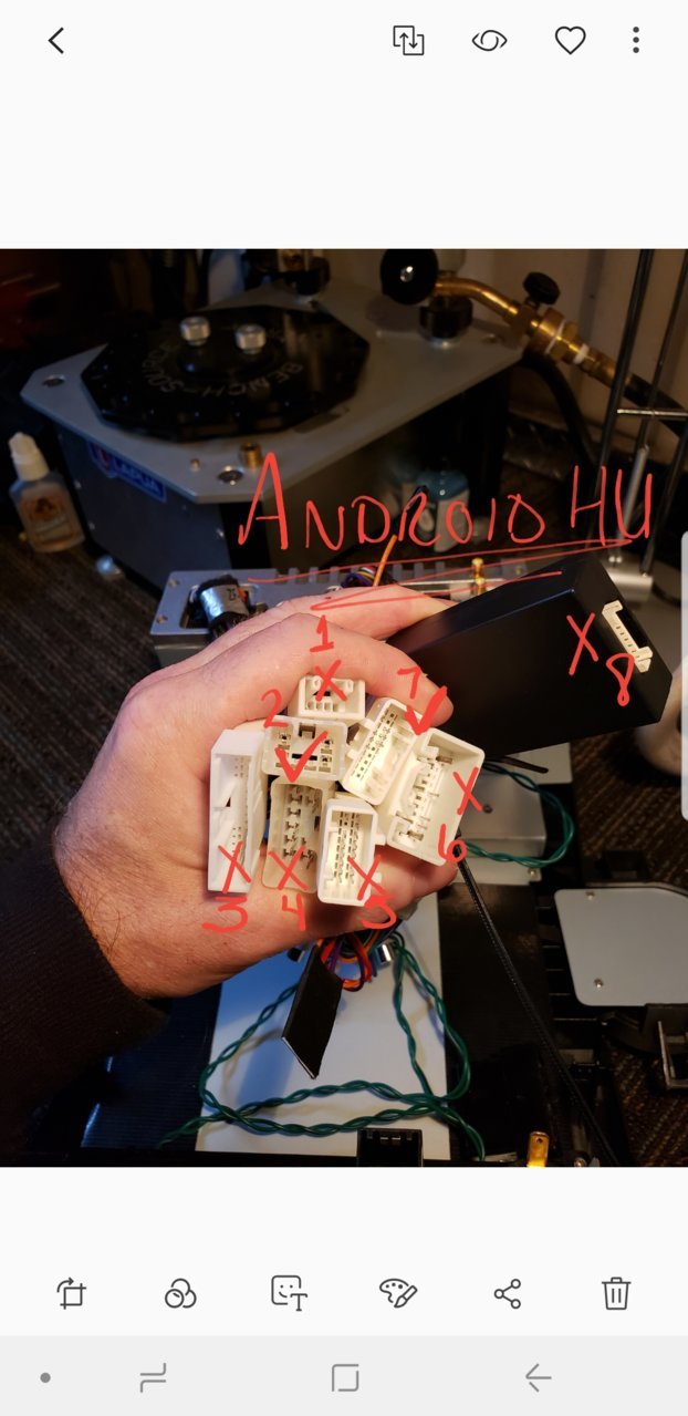

    So I installed mine...no worky...unit doesn't boot, but passenger airbag indicator light lights up for a few seconds before going out.
    H E L P please if you can. See below. I numbered each harness connector from both the truck and HU sides. If you have this installed on a 2007-2013 Tundra, and can fill in the blanks below as to whether they need a connection or not, please reply. I have emails and calls into Phoenix, nothing yet. I've poured over here and the FB pages trying to see some answers or insight.
    2012 SR5 double cab, non-JBL.
    I'm not sure if I'm missing something, but the attached pics below is what I have for connections. A "check mark" means there was a mated connection, X" means there's no mate for a connection found. Besides the provided OBDII and GPS tether connectors (not shown), I feel like maybe something was not shipped with this unit.
    From the truck HVAC:
    1) USB/AUX - Mated
    2)
    3) A/C Main Harness - Mated
    4)
    5)
    From truck stereo:
    1)
    2) Mated
    3) Mated
    4)
    5) This one doesn't make any sense to me that didn't have a mated connection from the Android HU. It's a very specific-looking connector. I feel like I'm missing a harness from Phoenix on this one...
    6)
    1)
    2) Mated
    3)
    4)
    5)
    6)
    7) Mated
    8) Excuse my ignorance, but what is a CAN BUS and why doesn't my pickup harness give something to go in this big black box?
    1)
    2) Yep, GPS got it lol. But, do I have to use the supplied Android's GPS tether, or is there a factory GPS connection on my SR5's factory stereo harness that you see (or know of that I'm missing) that can be used?
    Thanks for any help!

  4. Feb 24, 2019 at 4:21 PM
    #2314
    ttttttttttt
    ttttttttttt New Member
    Jun 19, 2018
    #16287
    16
    2018 CrewMax Limited
    Try disconnecting the USB to the truck. Mine won't turn on when that's connected.

    Hey thanks for the reply!
    Do you mean disconnect the Android's connection to the factory USB/AUX?
  6. Feb 24, 2019 at 4:29 PM

    So the little blue optical-looking cable (#5) from the factory stereo harness...what is that? Doesn't that need to be plugged in to the Android for something??

    I don't remember that one but my truck also a newer gen...

    Nope, didn't turn on...

    I hate it for you. Check the truck connectors and the one with the android . Make sure all of the pins are straight and that none are bent.

    Is there a fuse anywhere on the back of the HU?

    Pins look good, connections are clicked in hard, fuse is good on the back of the unit, unit has been checked and verified for power. The harness from the unit showed up with one wire (orange) that had been cut and left bare on a connector that I taped up but do not see another end where it should go (see pic). Not f'n cool...
