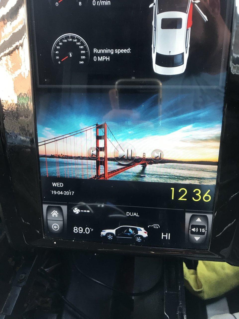

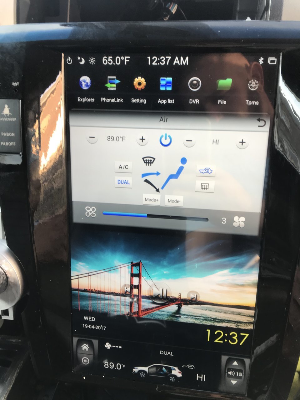

    I thought the one you have was the gen 3????
    That’s nots the fast boot 7.1 system??

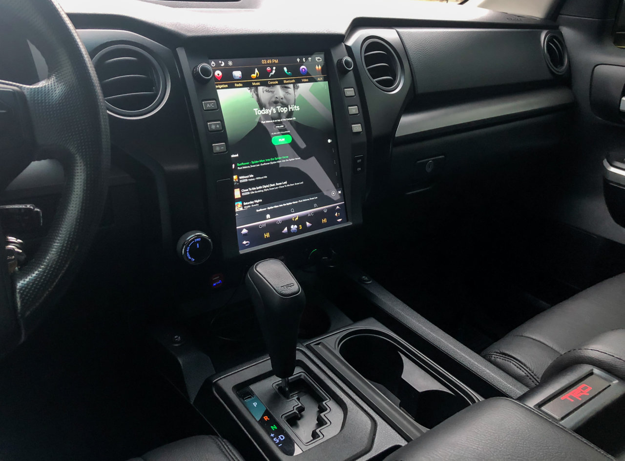

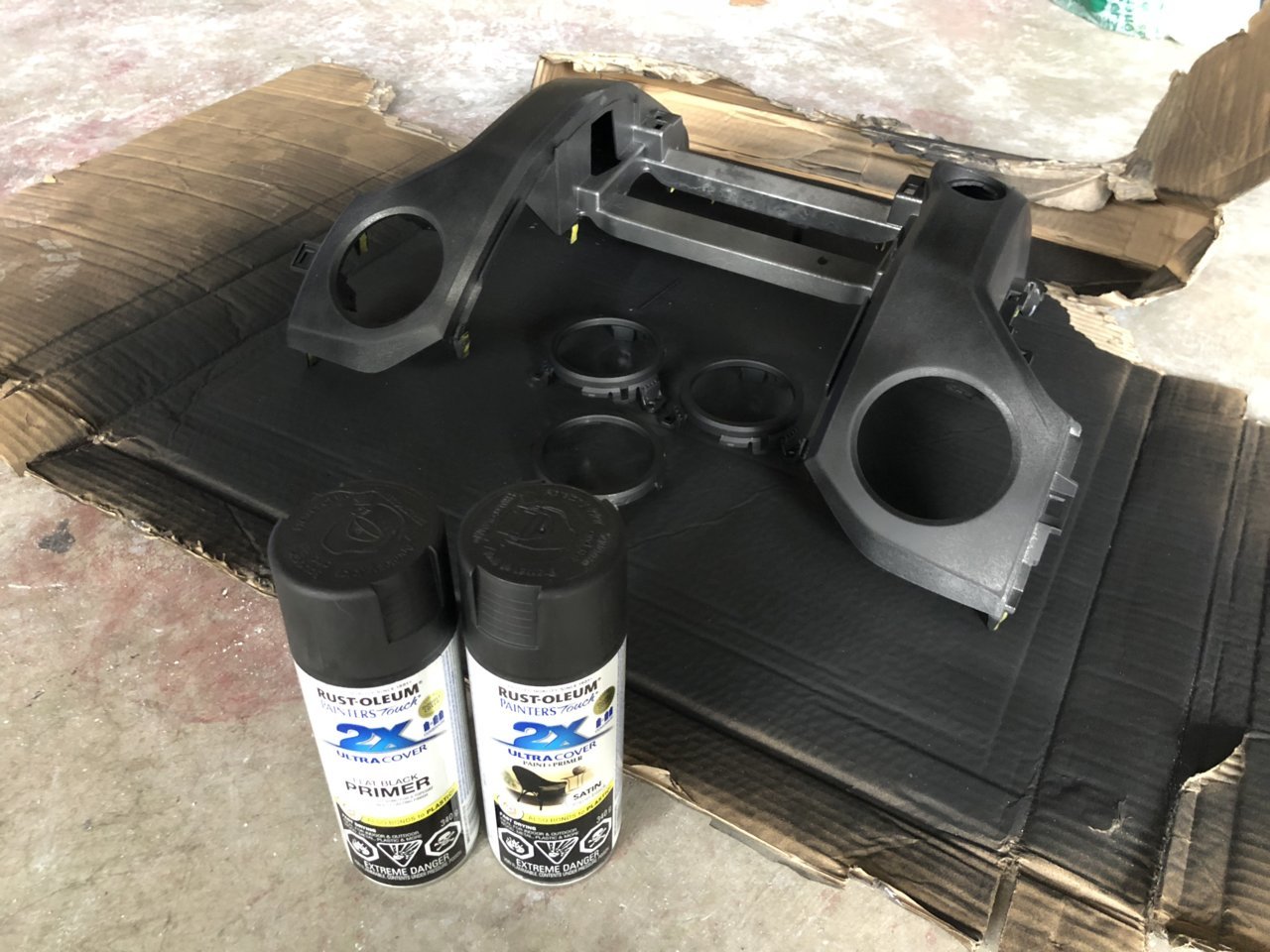

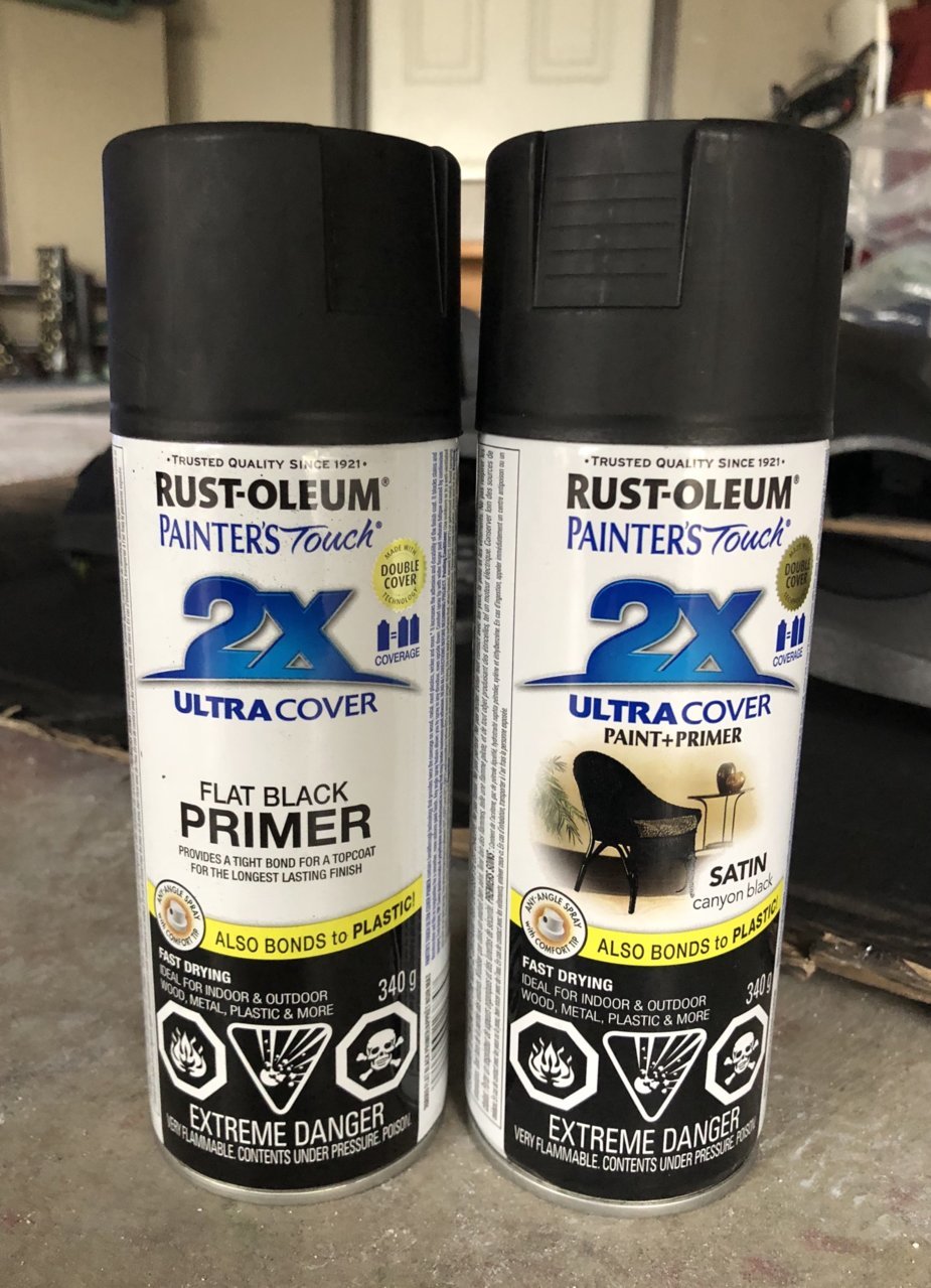

    What did you black out the plastic with? Is your a/c vents blacked out with the same product?

    Yes mine is gen 3. Fat fingered that post.

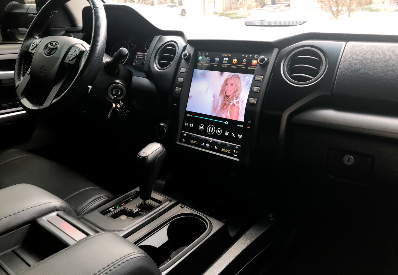

    The vent rings and steering controls only have the flat primer to change up the contrast from the satin around the HU

    I NEED to do this, and the gear shifter panel... drives me fckn Crazy getting blinded.. any link on here how to take apart so I don’t break shit :eek:

    Deal was supposed to end Jan1, no idea now. imho, don't get the one with the big manual knobs at the bottom, that's gen1 (not to be confused with the gen of our trucks) and slow boot. The kid in his basement, actually I don't know who's doing it, isn't making software updates on them anymore. And don't get the gen2 with no buttons at all. If your HU f's up for any reason you lose all control, literally.
    I have an SR5 too and I have the one in the screen I posted, gen2 with buttons. The top right knob controls the temp. The left two buttons above hazard control the +/- on the HVAC, and one of the right buttons controls defrost, they still work while the unit is doing a full boot. If you start the truck within 48h, it boots fast, otherwise it's gotta cycle on from the beginning.
    There’s a noticeable improvement in SQ, the factory SR5 HU is gimped.

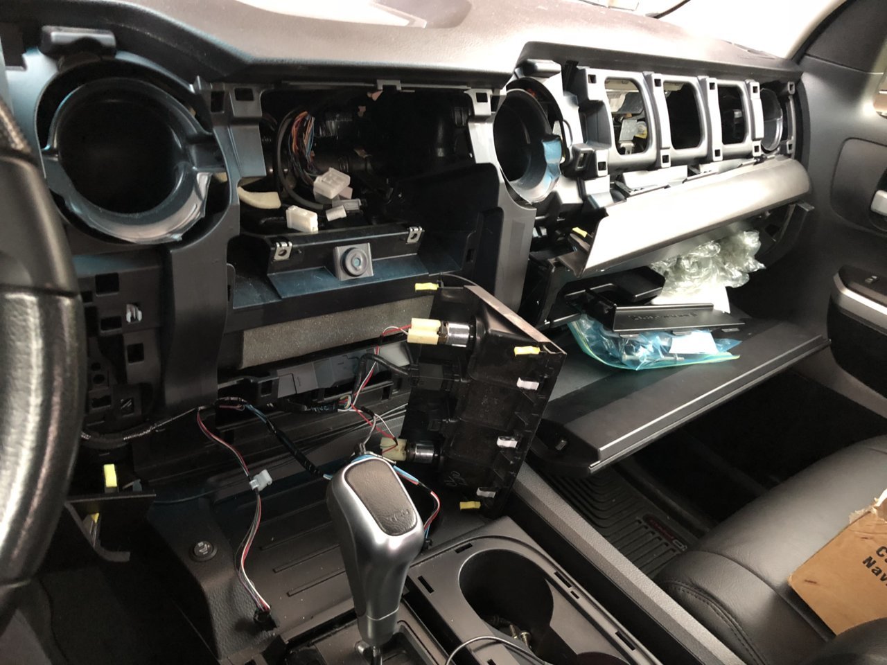

    Get some decent plastic pry tools from Amazon, ya there’s a few YouTube vids how to remove the HU and trim. It’s mostly plastic retainers that pull and pop off, not hard.
    Zoom in, it’s those yellow clips that wedge the trim pieces in. I think you can buy them if you lose any.

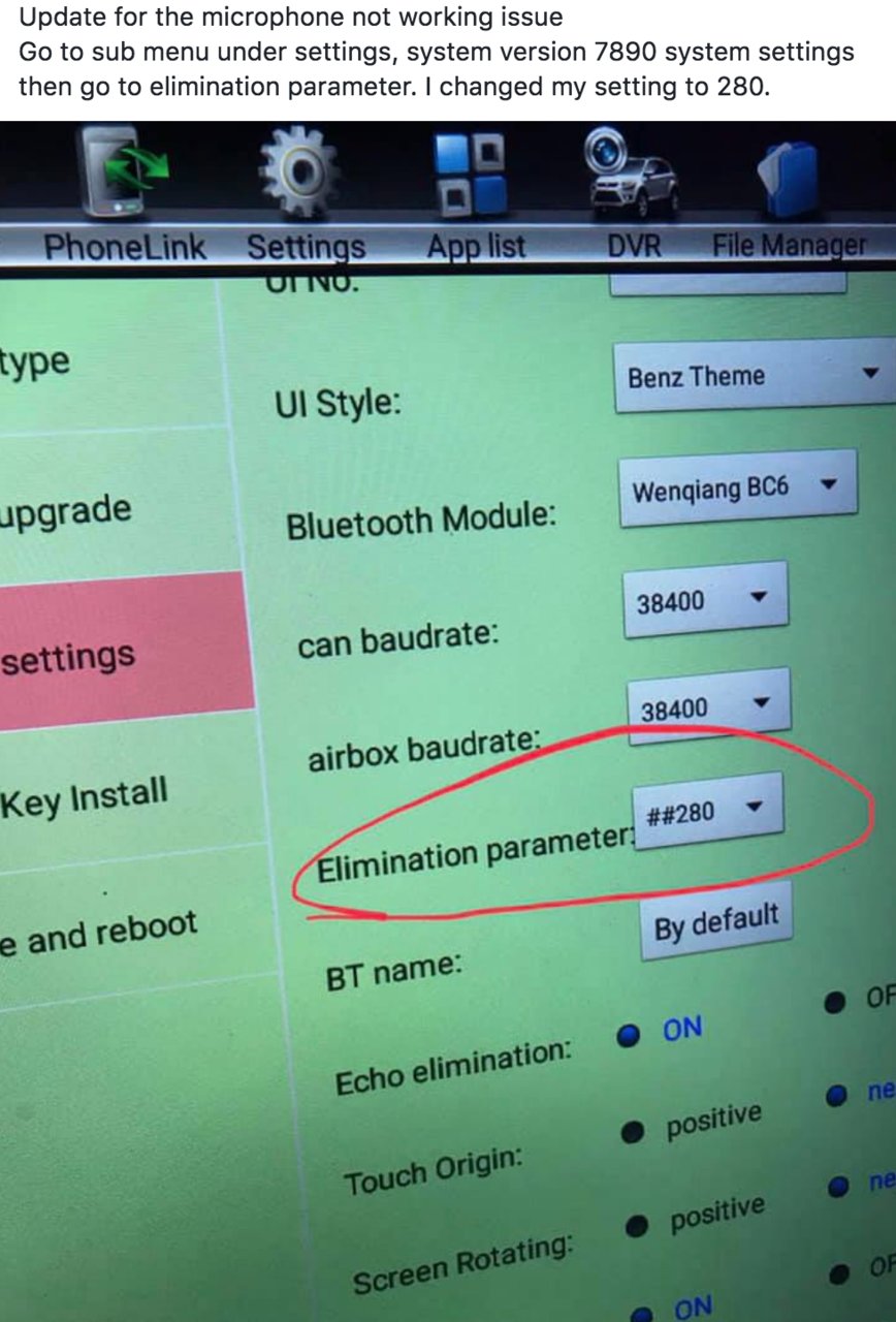

    I’m mostly an Apple user and I find this thing can mess up easy like any android if I play with the settings. It’s the opposite of an iPad having things locked down because we can control so many aspects of the UI. Once dialed in, I’m more than happy.
    Buy you’re right, I’d enjoy a tried true Pioneer, Kenwood or Alpine HU with CarPlay just as well too. It just can’t do all the things an embedded android tablet like this can. Can’t have both.
    I would say if someone doesn’t care for video, games, being able to use any GPS app whether local map storage or data, Netflix, streaming Spotify or Pandora, etc, skip this.
    Did you do the recent MCU update? I wasn’t having any mic issues but I read on fb it was a fix.

    Did you adjust the elimination parameter to 280?

    How do I do that?

    Many reports on fb this fixed the mic issue on the few who were experiencing it.

    I can definitely confirm it does. Much more likely to keep this thing now. Added a hot spot today for easier connectivity. Seems to be working better.

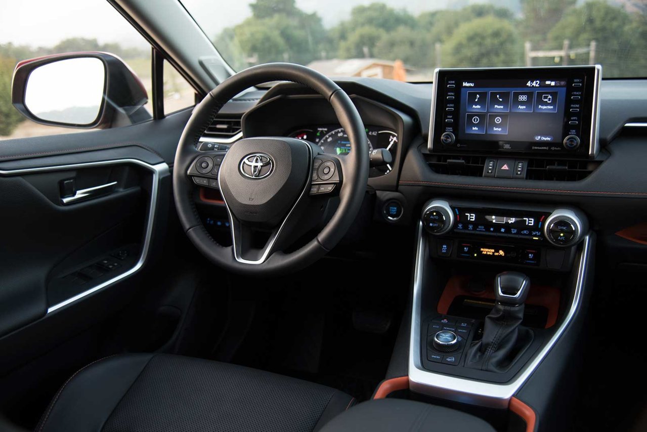

    Not too much luck there, saw a sneak peak on one of the other websites and the new tundras appears to have the same old same 7-8” head units

    The 2020 Taco, Tundra, 4R and Sequoia is said to have CarPlay, Android Auto, and Alexa. That should satisfy a lot of tech users. They should really update the Tundra screen so it sits partway above the dash like the 2019 RAV4:
    And the sound quality, the current stock HU is so weak. Adding the 12” Android HU was a surprising improvement, probably the same feeling if you added a branded HU.

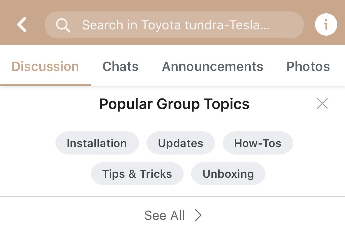

    The Facebook Tundra Tesla Tips & Tricks Group (there’s only one) has really evolved, these topic links are gold:
    Clicking installation leads you to a series of YouTube vids:
    And asking a question there gets you an immediate response easily from half a dozen people. I wish that existed even when I installed last fall. I’d buy again, and won’t go back. It’s like having heated seats in cold winter, you always want it going forward.
    It’s really if you’re willing to put in the time or know someone that’ll install it for you. Understandably not everyone wants to go through it. The drop out return rate is pretty low now. So while it might look intimidating that every other post is a problem solving issue, those are newbies, there’s probably over 2000 owners in the group quietly enjoying their units.

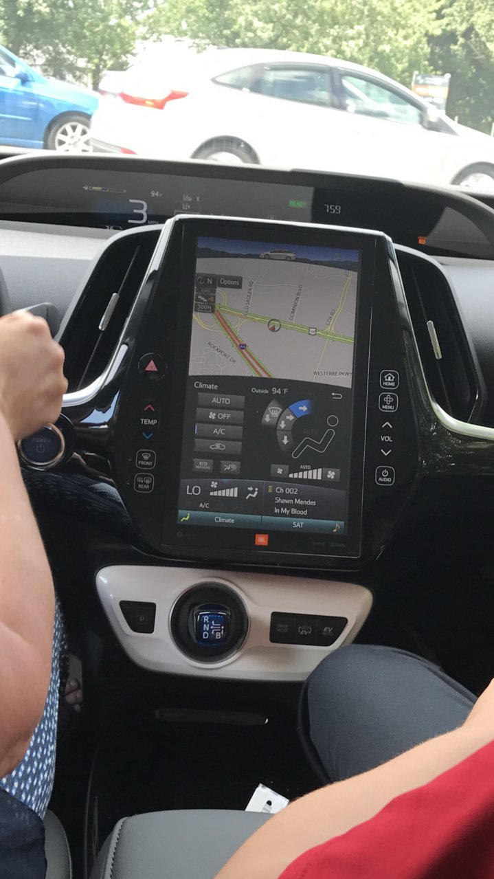

    Toyota knows how to do it because they offer a big screen in the Prius. It’s actually a pretty good HU

    Lol that looks redicilous in that small car.
