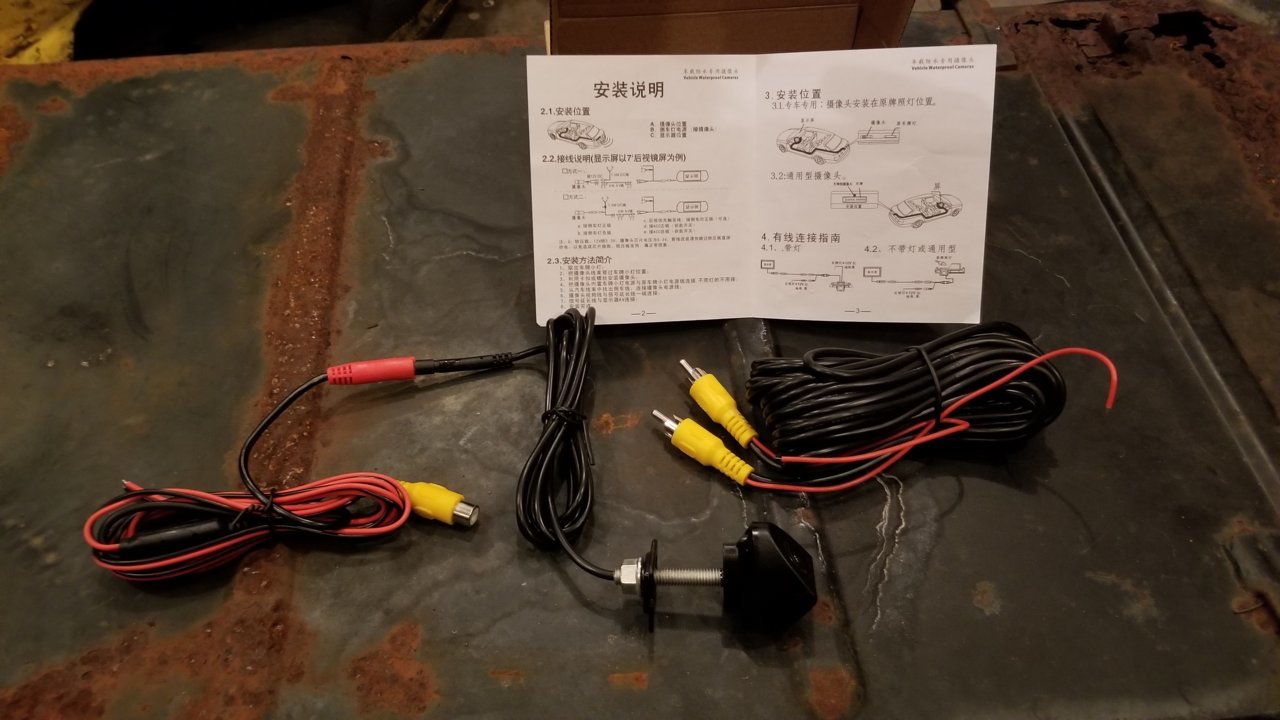

    Kent, that is the cam that I used. I have had no problems with it so far. One main thing to remember is that it is plastic and not to over tighten the nut, you could tighten it by hand and put a little silicone on the threads to prevent rust and to keep the nut from backing out. The other thing is that if you look in the picture the black washer has to be flipped around for mounting to the emblem. Good luck on your search.
    To this day I still have the shipping protective shield on the Phoenix HU, 6 and a 10 year old boys.

    One thing I can't find is a 12v power wire from the HU for the front cam, first gen had one. Anyone deal with this yet?

    Right on, now where is the power source for the front cam.

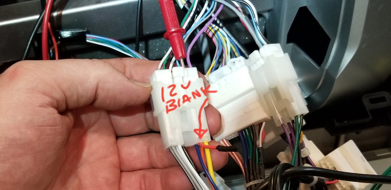

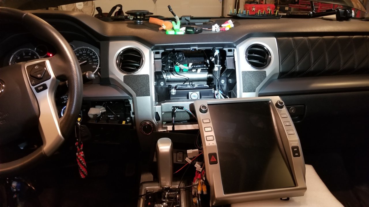

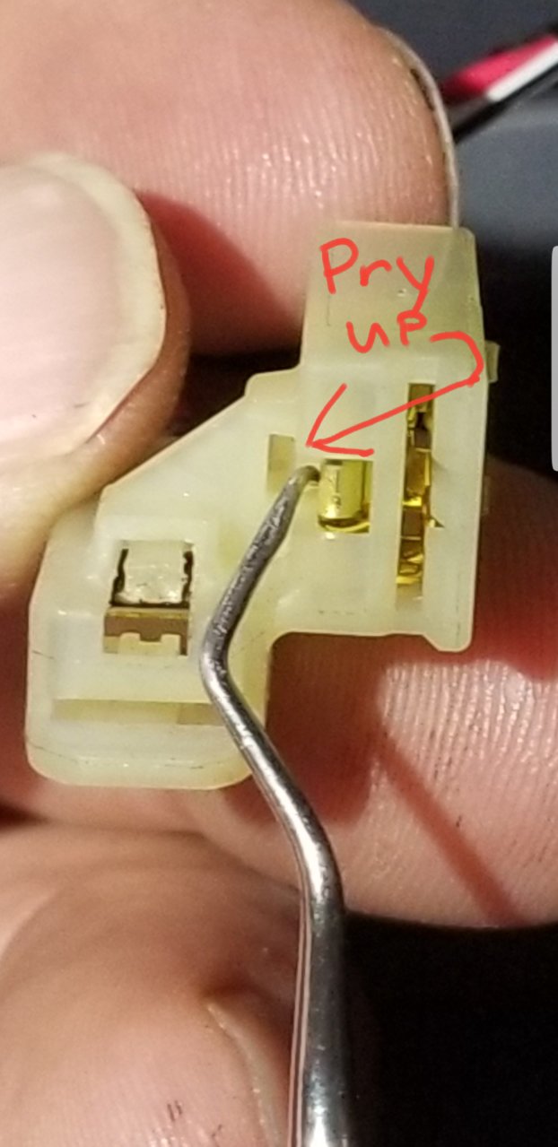

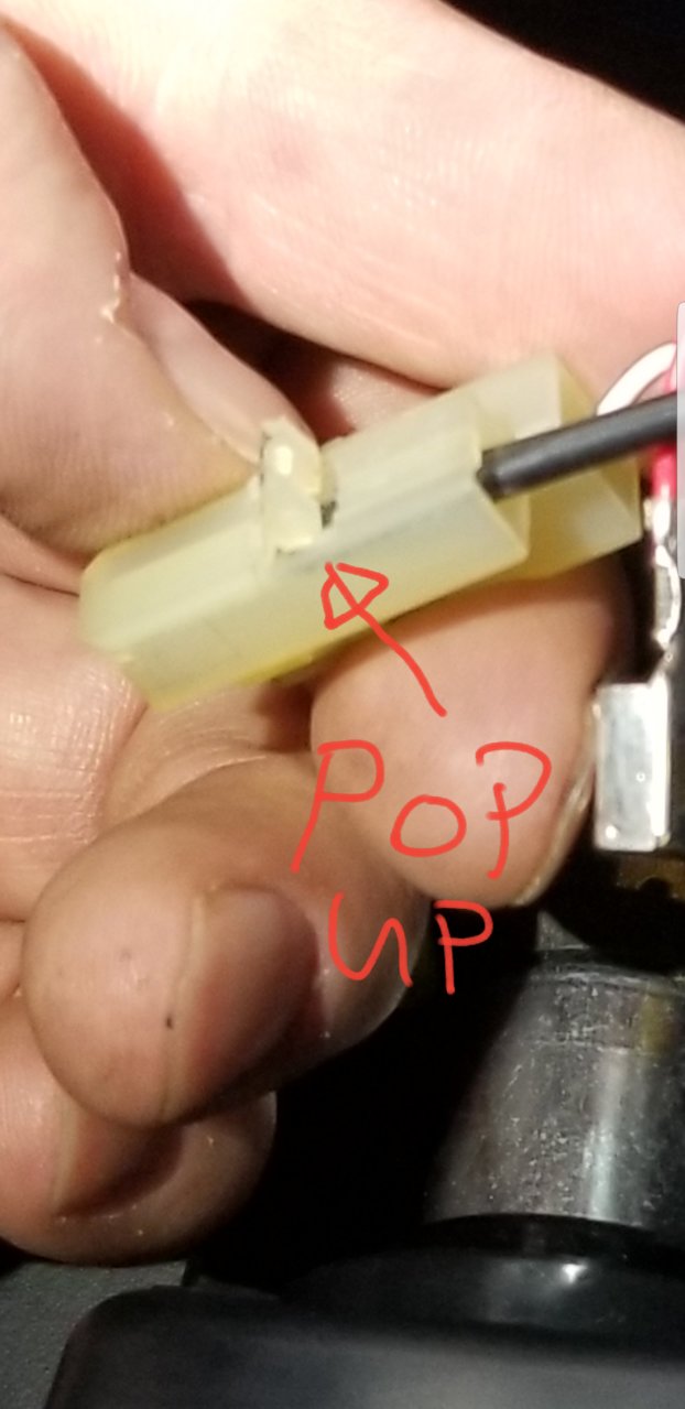

    Well I installed my gen 2 last night, the first gen was quite a bit easier to install to me (wires marked bettor). On the 2nd they do not provide a 12v power wire for the front cam like what was on the 1st gen. With that said I temporarily robbed power from the cig lighter like someone else did, getting the plug apart to solder another wire is possible, it has two lock points to the plug.
    After all that work I found this blank 12v wire not used from the HU plug.
    Another thing I might want to mention is to keep the radio antenna wiires away from all the rest, on my first attempt I had all the wires bundled together and noticed reception would fade when installing the unit in the dash. After getting the rest of the wires bundled up put a small piece of foam around them to prevent wire ends from rattling on duct work.
    Don't forget to recline the drivers seat (helps if you have to get under dash)and move shifter back before disconnecting battery. Without power you can pop the plastic cover off at the shifter and depress the shifter unlock also.
    One other note, the first gen would power up on ACC but 2nd gen only powers up in the run position, don't forget to put a charger on when you are testing/setting up unit.

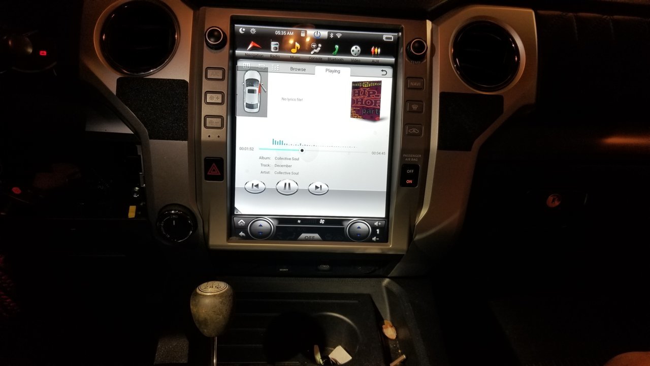

    Changed the boot logo.
    And changed the launcher, custom widgets to what I use most. Nice big digital speed readout if I’m driving alone, or my kids hijack the screen with a movie.
