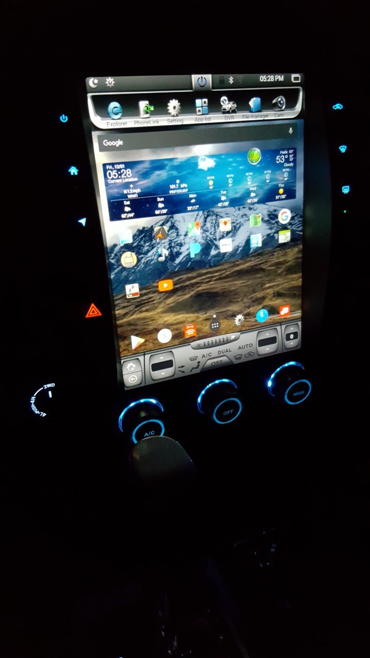

  2. Dec 1, 2017 at 4:44 PM
    #782
    guyp2k
    guyp2k New Member
    Aug 9, 2017
    #8973
    128
    That really turned out nice! Damn shame it doesn't come like that and looks like that is my next project.

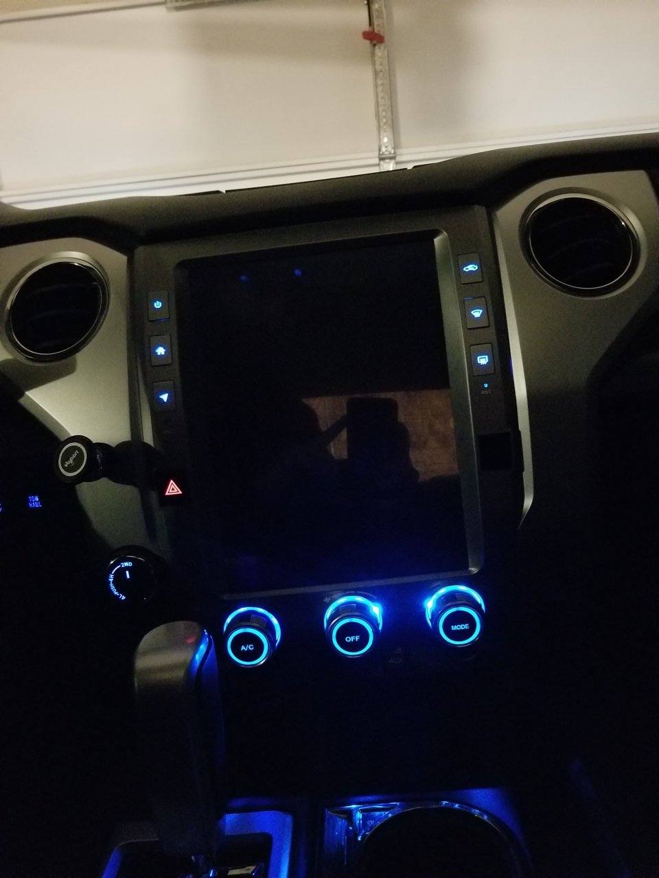

    its pretty easy guys you probably take more time washing your truck the what it takes to do this mod.the buttons don't look blue like they are in person

  7. Dec 1, 2017 at 7:28 PM
    #787
    ZPMAN
    ZPMAN 2nd place is the 1st looser
    Nov 1, 2017

    Great looking fab job 1971sport.

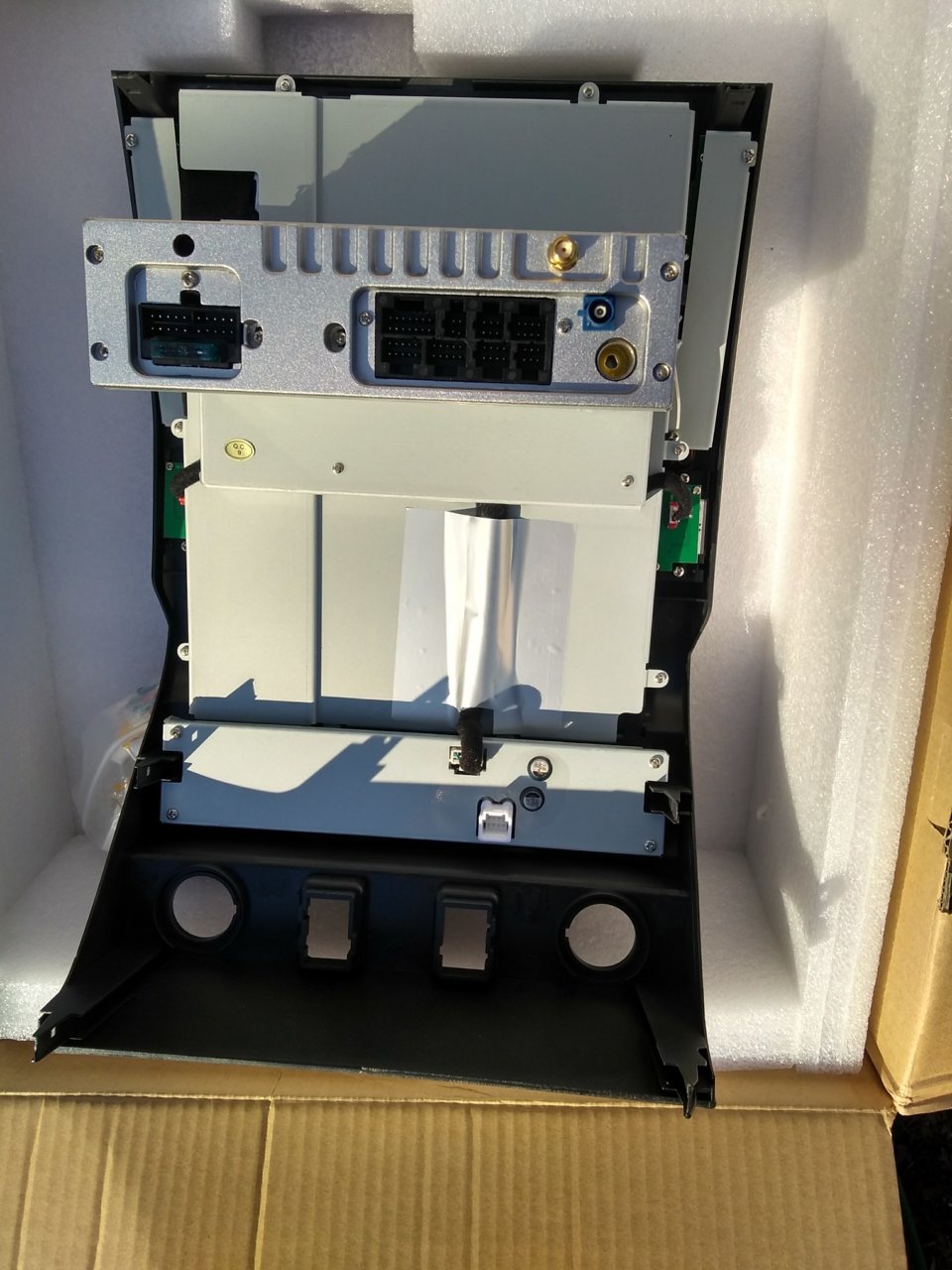

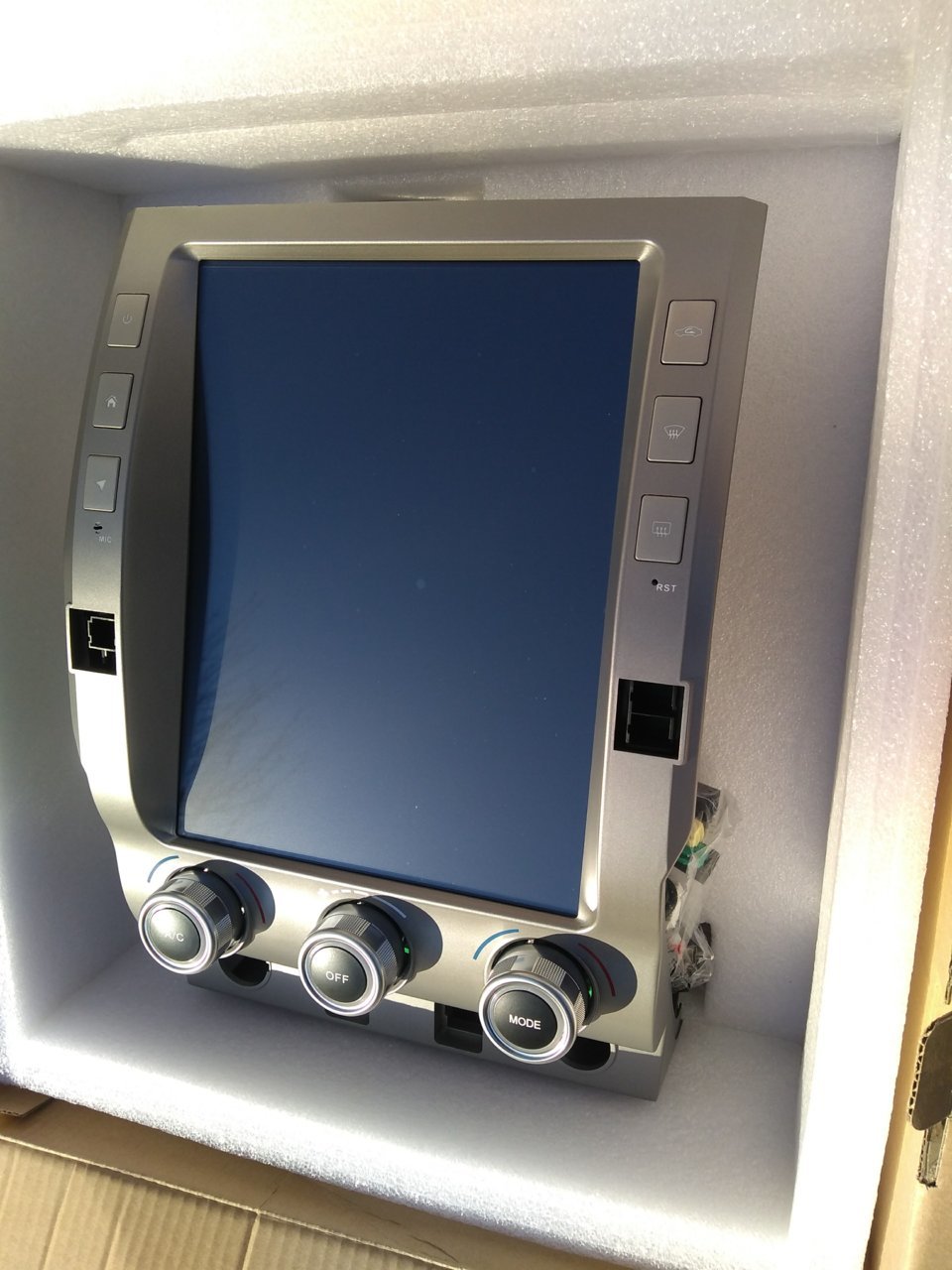

  10. Dec 2, 2017 at 4:23 AM

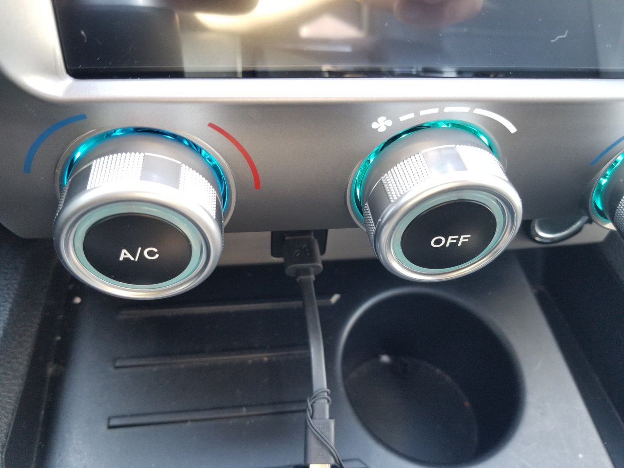

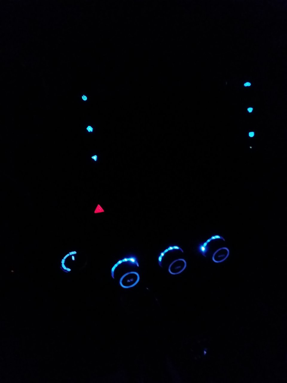

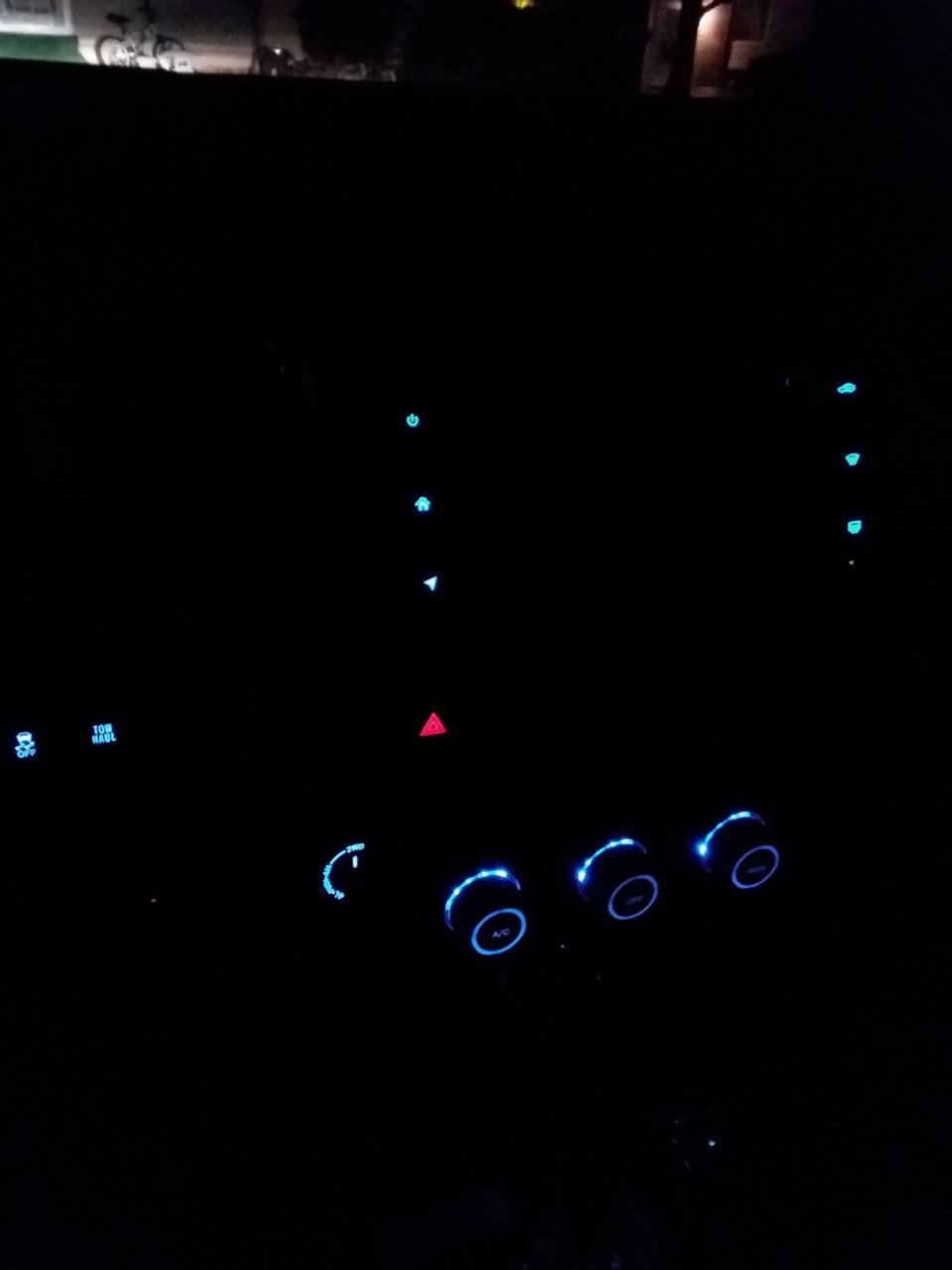

    Well I jumped into the LED project. The buttons with the blue tape was simple. And now I am messing with the acrylic rings and while I was cutting them and sanding I thought why not use a blue sharpie over the leds so I did it to one knob a day waiting to see how it looks at night. 20171202_133138.jpg 20171202_133258.jpg

  15. Dec 2, 2017 at 10:42 AM
    #795
    1971sport
    1971sport New Member
    Nov 11, 2017
    #10898
    150
    Did you cut those yourself? The guy I ordered from cut them to size outer and inner no charge

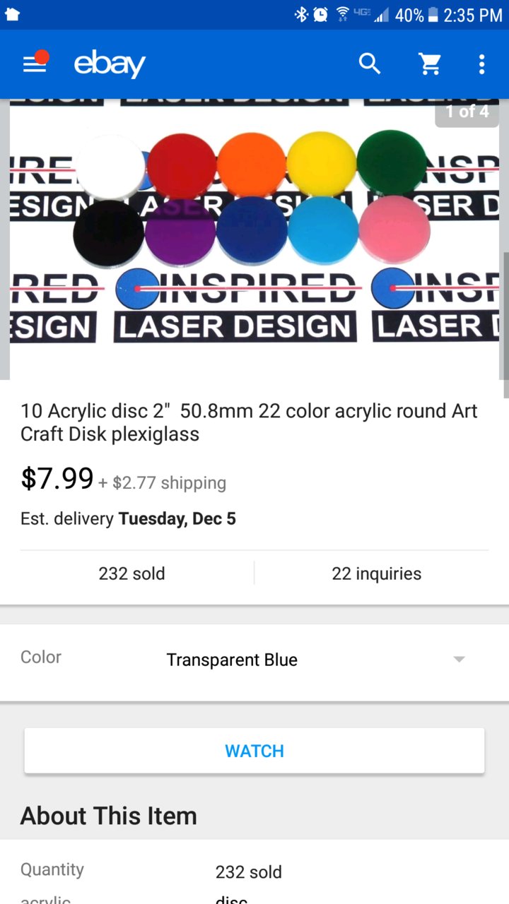

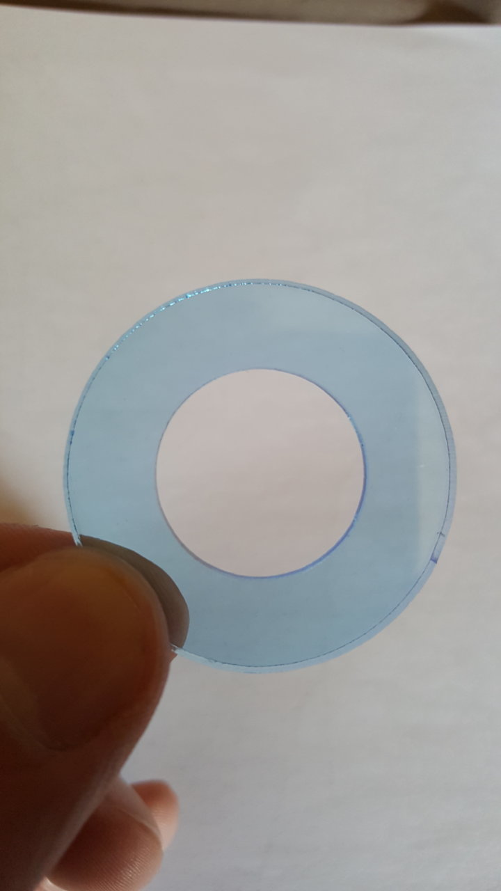

    I am cutting myself.. Where did you order from.. What size did you go.
  20. Dec 2, 2017 at 11:54 AM
    #800
    1971sport
    Nov 11, 2017
    #10898
    150

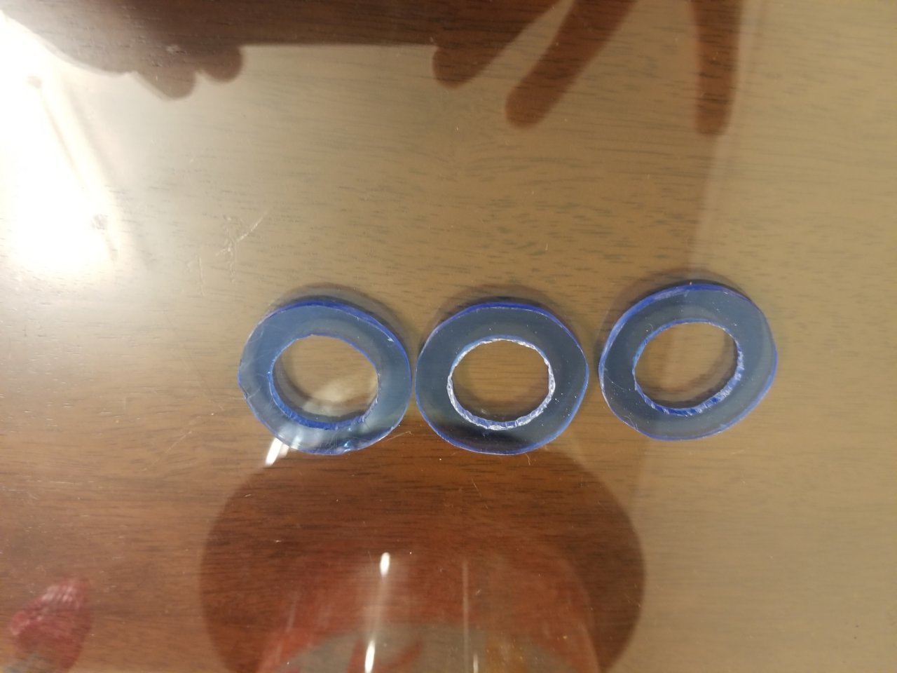

    39mm outside 22mm inside outside fits great inside needs just very little material removed on inside evenly with half round file. So it can freely slide on center post.
    That's too much work to cut it yourself i wouldn't even do that. here is what they look like after he cuts them

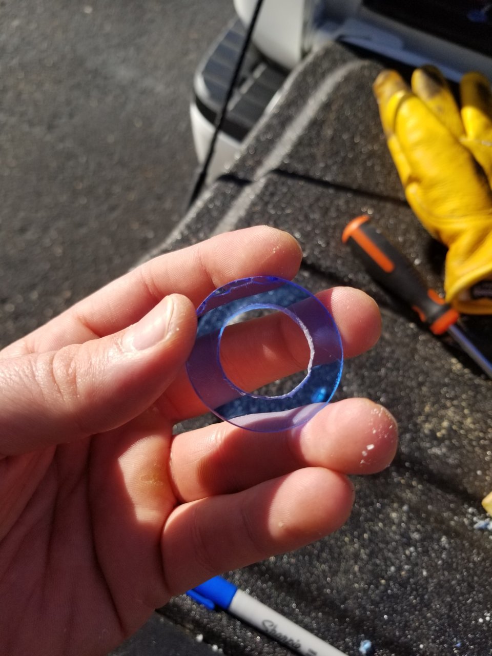

  21. Dec 2, 2017 at 2:09 PM
    #801
    AK-in-MI
    AK-in-MI New Member
    Sep 17, 2017
    #9706
    335
    Joey
    Michigan
    2015 Platinum Crewmax
    D.A.P. Tune Bilstien 6112/5160 33x12.50xr20 Toyo Open Country M/T 20x9 Fuel Coupler TRD Exhaust
    20171202_170652.jpg It has been a pain but I got them.. Just have to get some fine sandpaper and touch them up a little.

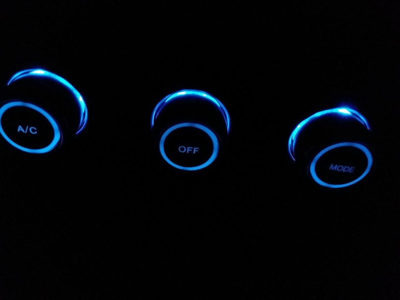

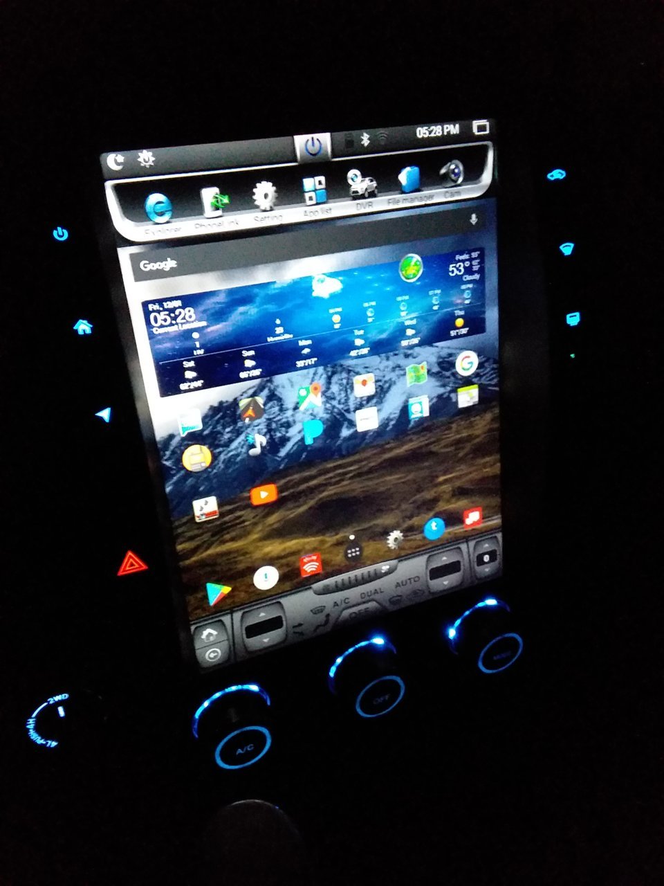

    Well the installation is complete. I went through the entire thread and prepared. (I will post my notes later today)
    I installed the black tape (gorilla tape) to block the side light bleed through. (Reference Post number inserted here later)
    I used plain old blue electrical tape over the button led's. It made them less bright but I like that. I am looking for a glow vs brightness.
    I put the GPS sensor under the center dash speaker grill. It may not stay there because it really does not fit well and causes one corner of the grill to want to pop up occasionally. (A later refinement)
    I plugged in all the wires and secured them along with the orange box ON TOP of the HU housing. That is because when you physically install the HU it sits just above the mounting brace of the old unit and there is no room.
    Also for the OBD connector routing there is a direct path from my center speaker (where GPS is installed) down through the dash to the plug under the wheel. I did not have to try and snake it around any panels. You want to pop the speaker grill up then get on the floor and look up through the dash and you will see the path easier.
    I did have one issue on fit. The two tabs on top of the unit would not snap in because of two screws on the HU not having enough clearance with a piece of trim. I used a razor to cut notches in the trim so the screws would not rub. Very easy because the plastic is kind of soft. There is a post about this. (I will find number and insert it here.)
    After installation I replaced my center console cover and fired it up. Everything worked!!! I have an SR5 and the HU was already set in the TANTU LOW configuration. My HVAC worked perfectly as well.
    The audio sound is WAY better than stock. BT audio is much better as well.
    Now I got to get those acrylic rings to install around the knobs. Those LED's are blinding! I am thinking of getting the non transparent rings because I really don't need the "HALO " effect. The center LED would be enough for me.
    All in all a very good decision. I am quite pleased so far. I am sure I will find some small things after the "New Toy Euphoria " wears off.
