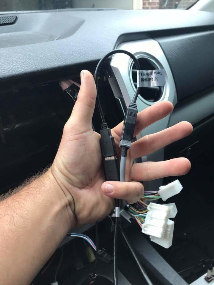

    Even though everything works so far, does anybody know what the male USB is for? I know what the 2 females are for but I'm not sure what the male is used for.

    You plug the male USB into one of the Female USB provided. Once you do that your factory USB plug in next to the cigarette lighter will work and read info on the Unit.

    Anyone have a pic how that looks? I thought my stock usb would work

    How it looks plugged into the back of the unit? Your stock usb will work if you plug the provided USB adaptors together FB_IMG_1511889231816.jpg

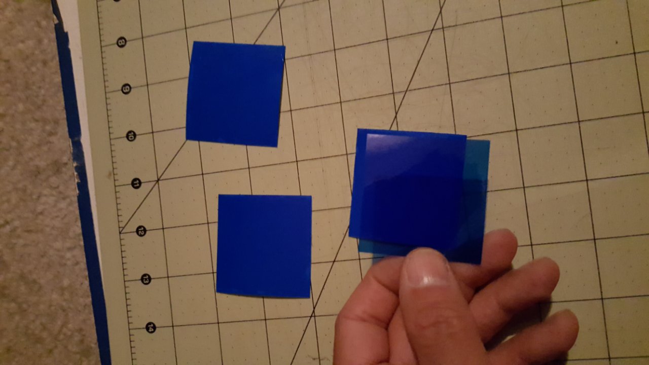

    I have been successful in changing the color to blue been busy haven't been able to follow up.but here it is i ordered these plexi rings cut to 39mm outside x 22mm inside the out side fits really close and inside fit really snug on post so i opened them up with a half round file barely so it would slide on freely.he can cut them very precise within .3mm . For the buttons i found 4 layers of the tape is the best to dim them enough for my liking. The rings need 8 layers of the tape to match. The 3 sheets of vinyl tape is plenty to do the whole project. cut into 2 inch sections . I only applied the tape to one side and i lightly sanded the other side to fog the clarity to diffuse the light better. I cannot get a good night time pic for some reason but trust me they are alot dimmer and Blue . took me around an 2 hours to do the whole unit.The inside of the knobs need 4 layers of tape also for the worded part of the knobs.You might have some minor light bleed on the outer edge of the plexi rings i just got a large thin rubber o ring to fill the gap.Infact there is enough material to do 2 mabey 3 units if someone wants to share the cost
    20171125_185001.jpg 20171125_185250.jpg 20171125_185454_001.jpg 20171125_185454_001.jpg 20171125_185843.jpg 20171125_190329.jpg 20171125_190409_001.jpg 20171121_112649.jpg Screenshot_20171128-143629.jpg Screenshot_20171128-143555.jpg

    :ohsnap:...keep up the awesome fixes. You guys have some great ideas here. Once you get everything working right, please forward that information over to China, so they can get the android radio correctly working and everyone else can enjoy your hard work.

    You do use the original plug. You just have to connect it using the cable they supplied to have it working.

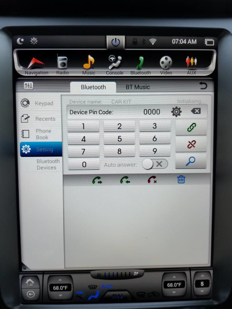

    Well, my bluetooth stopped working. Its stuck on initializing. I've factory reset it twice and made sure all the connections in the back were solid. Still nothing. I've contacted the seller and waiting for a responce.f08362604f249574f04512e9b82c624e_ab0d23f797d28ffdb09ce43273faf10a618120b3.jpg
    Update: looks like I accidentally changed the BT Model when I was browsing the different themes. It's now fixed.

    What's the name of that theme you chose
  29. Nov 29, 2017 at 6:23 AM
    #719
    Fr0gburp3r
    Fr0gburp3r New Member
    Jul 3, 2017
    #8398
    225
    2017 Magnetic Grey Tundra SR5 Crewmax 4x4
    The UI Style (bottom panel) is Classics Theme and the UI Number (Top panel) is Classics UI.

    Here is the best pic I can without the middle knob lettering change for color comparison20171129_065036.jpg
