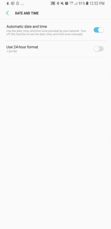

    Is there a setting enable for automatic time zone, time and date when connected to your phone and GPS like on an Android phone?

    Yes, but it never stayed, maybe now since I got the right time zone.
