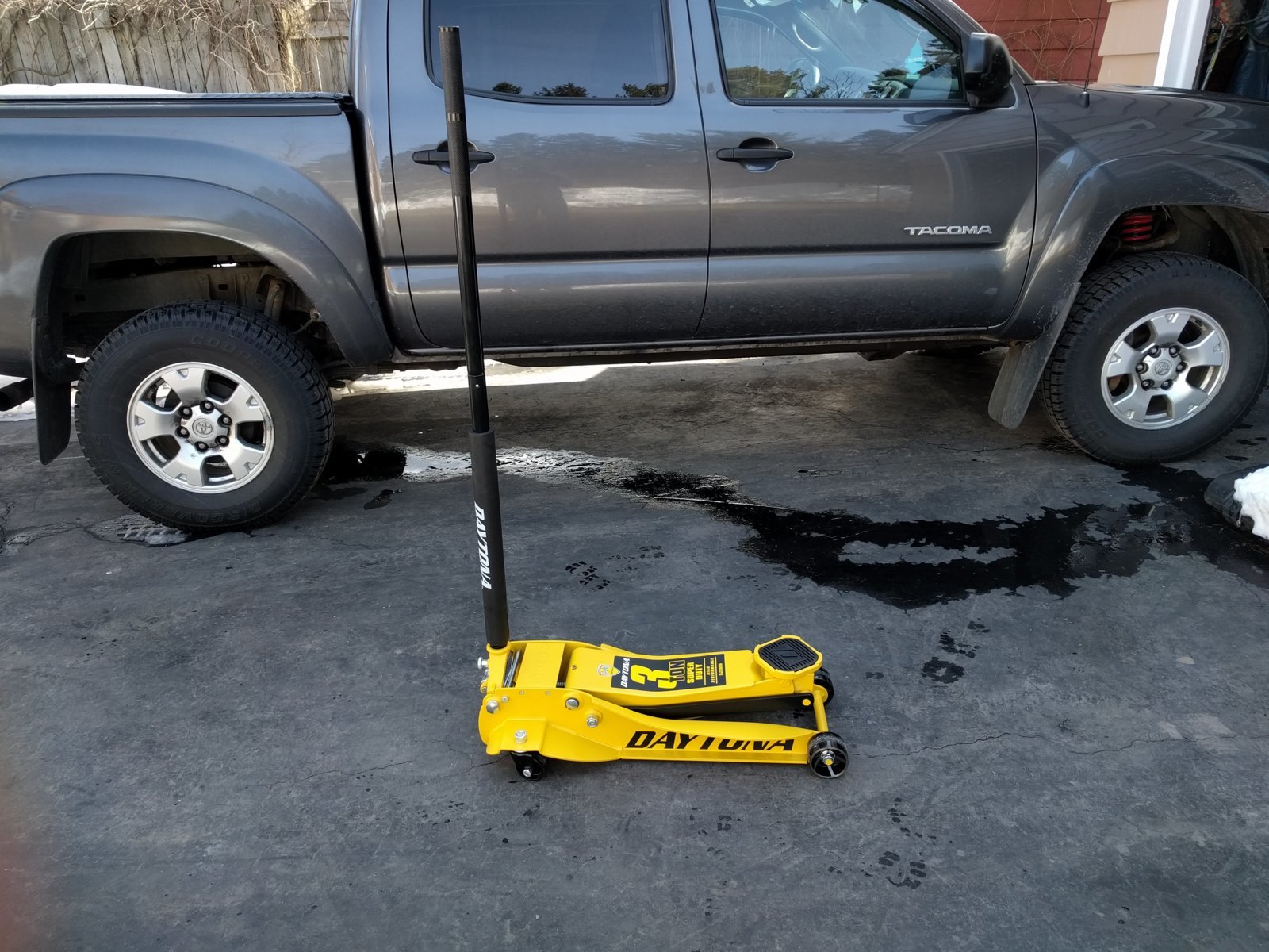

    I am a huge fan of the Daytona jacks from harbor freight. Been using mine for a long time and if it ever does fail I will definitely get another as long as they are still making it. The picture I posted is the day I brought it home and that was in April of 2018

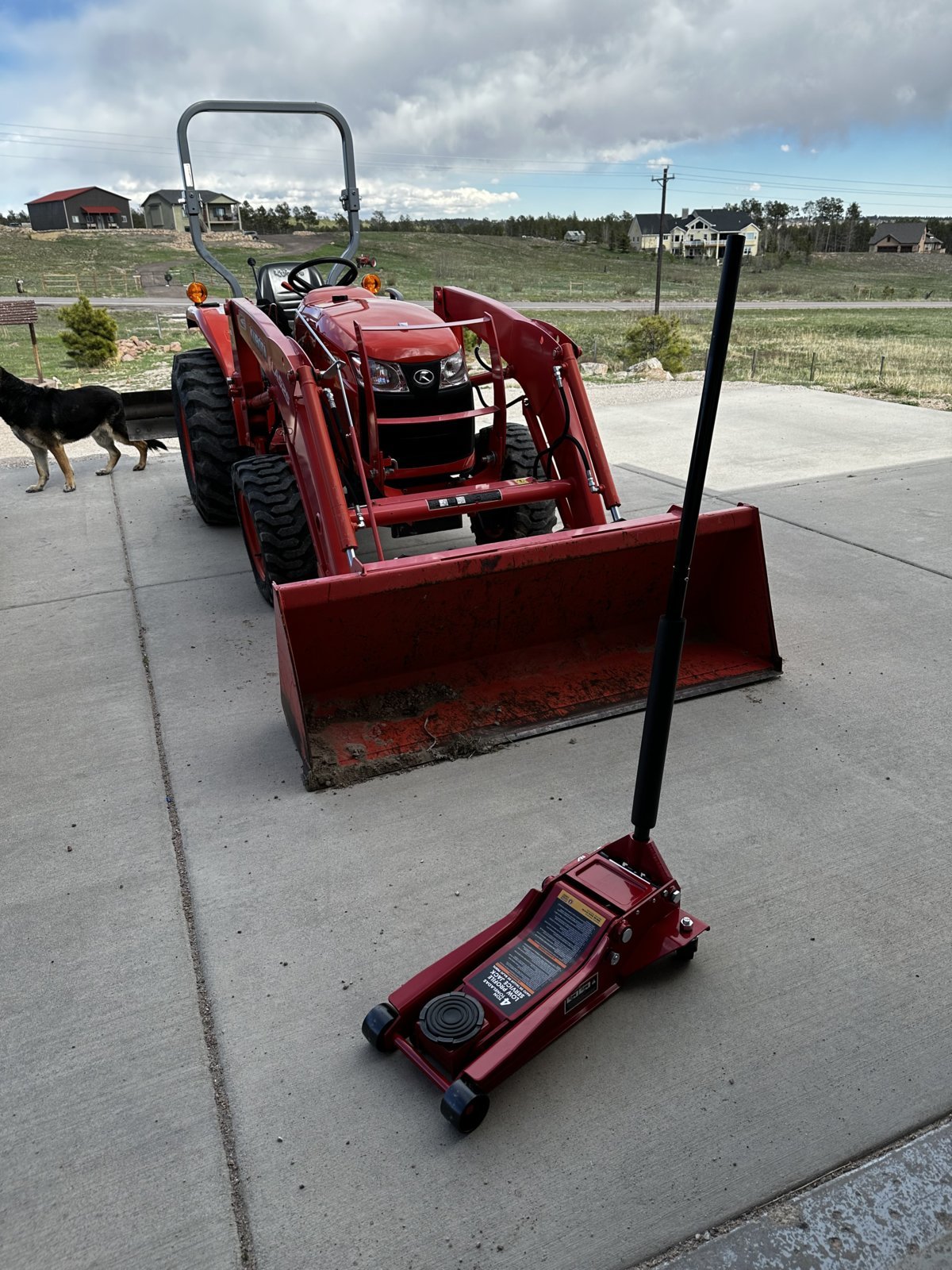

    Well ordered a jack that should last. This has been a bummer. I had a Michelin brand 3 ton jack that lasted 18 years without issue.
    Looked around and did some research and looks like the Big Red Torin 4 ton was always in the top two.

    Jack and torsion keys came in. The "big red" is no joke. They had a lift when delivered at my front gate. I figured it wouldn't be an issue picking it up and walking up my 7* grade driveway.
    Nope. That is one heavy floor jack. Tractor made it easy.

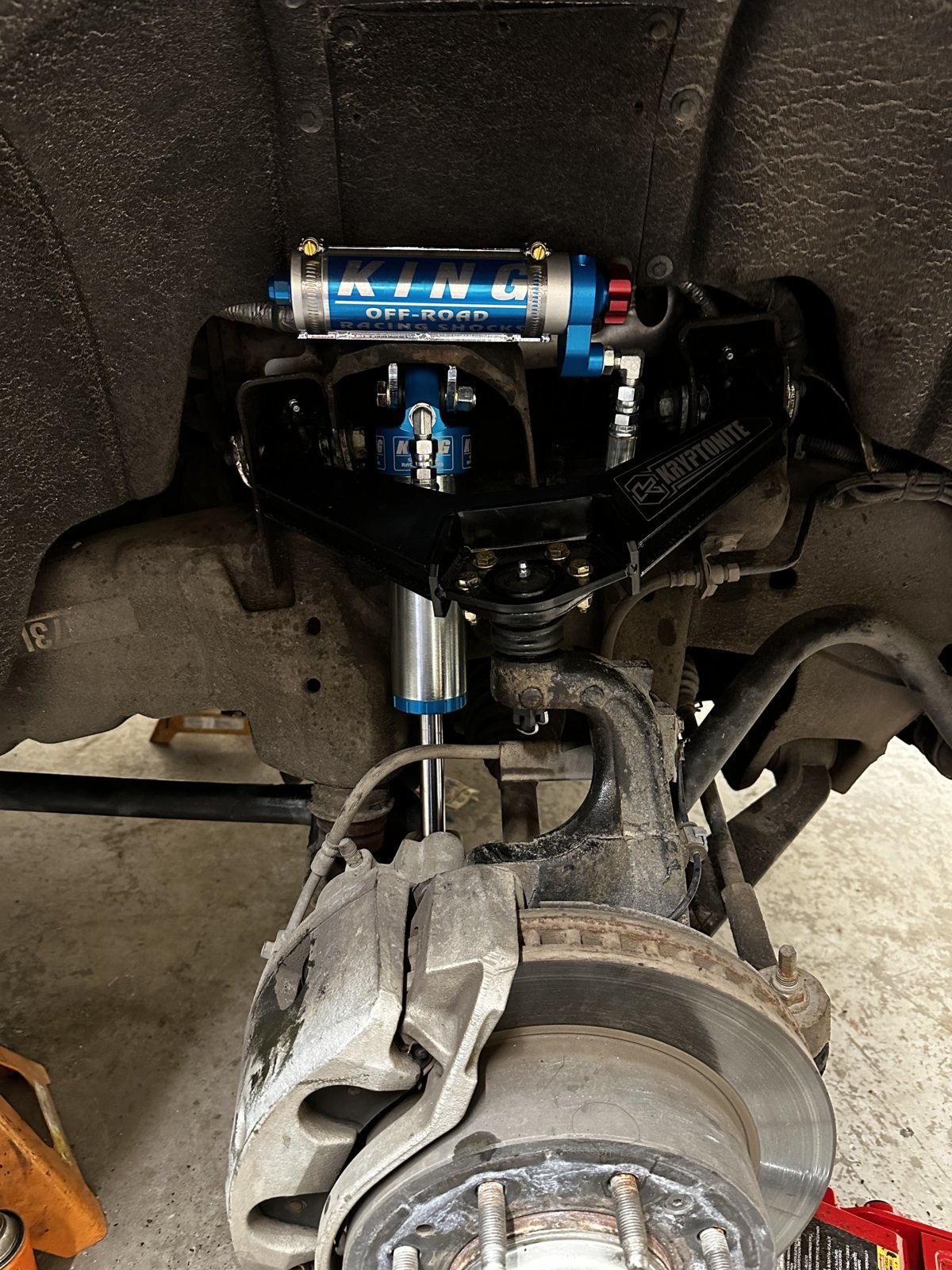

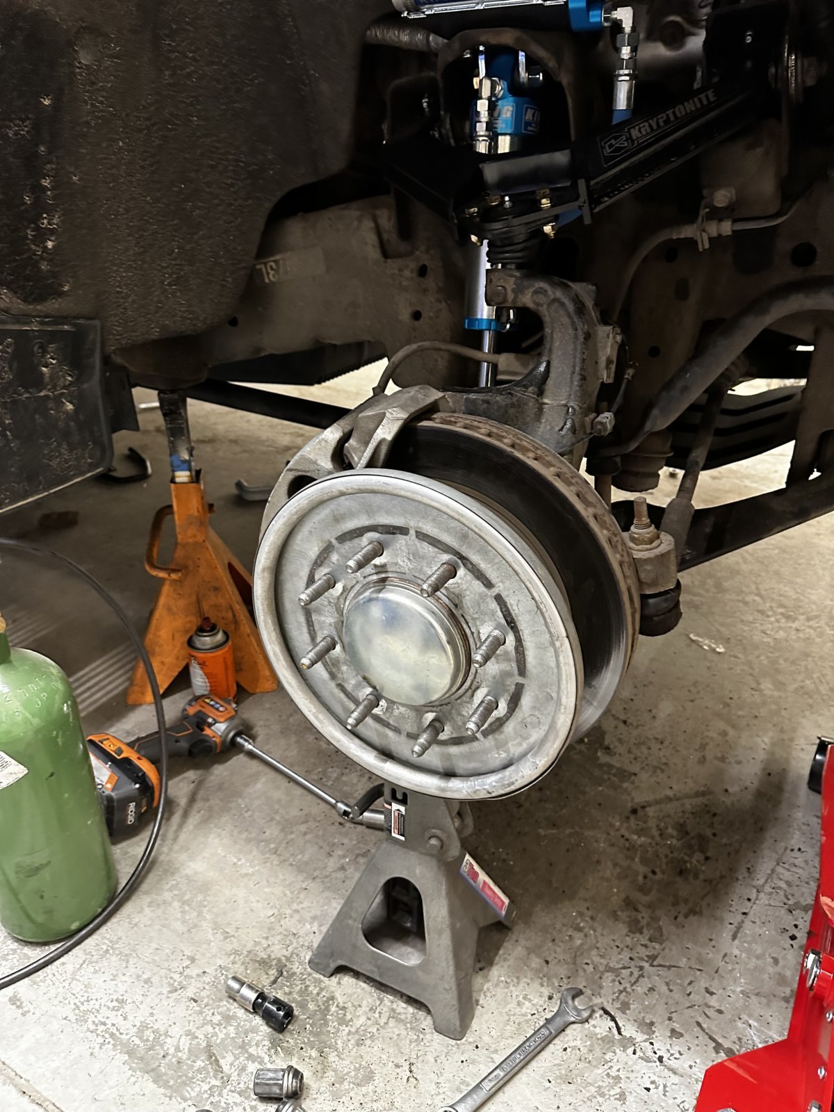

    Upper control arms and Kings installed, and aligned.
    Now to fine tune the front and rear for empty, 50%, and 100% load.
    Took my wife out for a ride and she was shocked. :eek:
    Driveline vibrations are gone and the truck just absorbs these craptastic roads in CO.
    The good and bad:
    Start with bad. Price. This isn't a cheap upgrade. Is it worth it if affordable? Hell yes.
    Rear shock adjusters. For the couple times per year I may adjust these it may not be an issue.
    As you can see, the adjusters are not easily accessible. I will have to roll under the truck and make adjustments. I may remove the wheel well liners and use my super duper 4" hole saw and make an access point with quick 1/4 turn tabs. Now I can spend 300.00 and swap out the piggy back reservoir to a remote but mounting still might be an issue. More likely I will make an access port.
    Raising the front will hit me at the fuel station.
    The good.
    Looks great.
    Ride is amazing. All my HD trucks in the future will have performance shocks. To me, it is worth the ride benefits.
    Lifetime warranty on upper control arms and grease points. Ball joint is super easy to swap out.
    This also raised my fuel tank a bit. That 62 gallon tank hangs down a bit. Having a bit more clearance makes me feel warm and cozy.
    The alignment tech said my tie rods were a little difficult and wasn't surprised. 8 year old truck and they have never been touched. Yes, I have only had one alignment in 103K miles until this mod. I had it checked regularly but was always in spec and tire wear was always even.

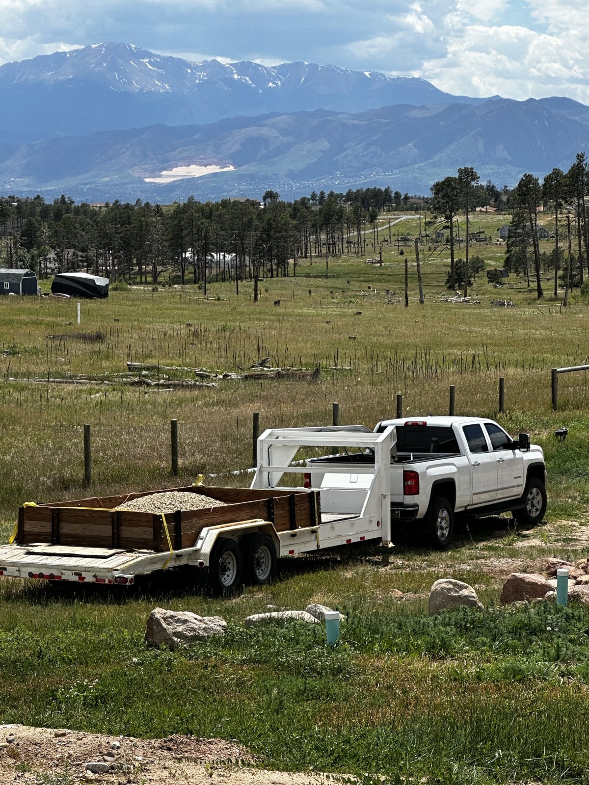

    Today was the first tow on these Kings.
    The load was 5700 lbs of rock and 4700 lbs of trailer. The drive back to the homestead I normally have two sections that were pretty jarring with a load. Today was smooth and controlled. I had the compression adjustment all the way open and it felt good. When I tow heavy >12k lbs, might run the adjusters in a bit to test how it feels.
    NWPirate, Jowett, Black Wolf and 4 others like this.
