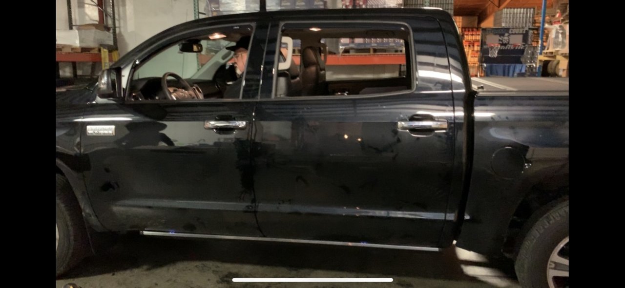

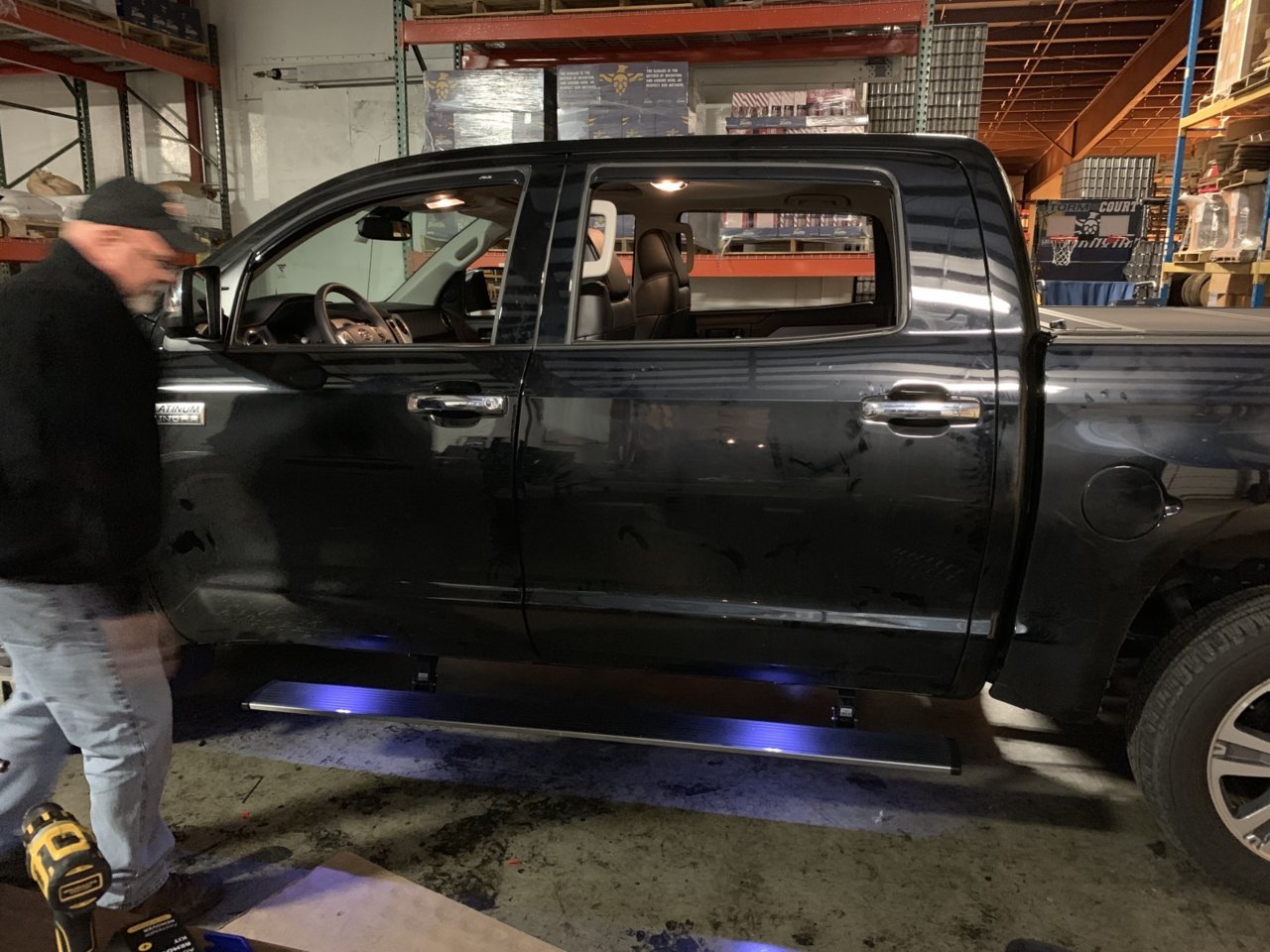

    Bak Revolver, BedRug, Undercover Swingcase, PopLock, Bilstein 5160(rear), Firestone RideRite, TRD rear sway bar, Coachbuilder +2 rear shackles, Andersen 5” aluminum adjustable hitch, TRD dual exhaust, VLEDS interior leds including the footwell kit, TundraTex FRAC mod, VLEDS LPR backup tag mount led, Husky X-Act mats, Color matched cup holder bezel (silver), Ceramic 20% tint all around, 50% Ceramic windshield, Color Matched door handles & mirror caps, The “Stubby” antenna, AMP Research steps, VLEDS 6”step lights, ToyTec/5100 Bilstein coil overs, 700lbs red ToyTec springs (2.75” lift), 20x9 +18 Method 306 custom painted and custom fit center caps, Gorilla spline lugs, Bridgestone Revo 3s 285/60R20, TRD skid plate, RaptorLiner “Red” tow hooks, 19 Pro black LED headlights, VLEDS Triton V6 turns, Rigid SAE D series fog lamps, 19 TRD hood scoop, 2019 TRD Pro grille, Coachbuilder bumper shims, X-Pel protect under mud guards, Opti Coat Ceramic, Opti Coat Sealed. And some snakes and sparklers, because they are my favorite!
    Snapped a few this morning 7E21A58A-79D0-4040-B741-D861EEECC74D.jpg29B67CD4-039B-44DE-BDC7-3B0EAA08E94A.jpg
    r1-superstar and tundraforme like this.

    I'm joining this late but did the install myself as well about 7 months ago. JM - you're on the right track with the blue wire. NKLNDYM's write up & pics are great and spot on!
    I never got my rear driver side door to actuate because of the instruction error(s) you both point out. The Red/Pink wire behind the dash is significantly thicker and not in the right pin. I tapped into a different wire that IIRC was in the right pin but wrong color and the step doesn't actuate. It's bothered me but I never found a solution. All the other doors work.
    I'm going to look for the thin Red/Pink wire next to the side of the e-brake. That was a great idea!! I'll post back if I get time to try it. Probably Friday.
