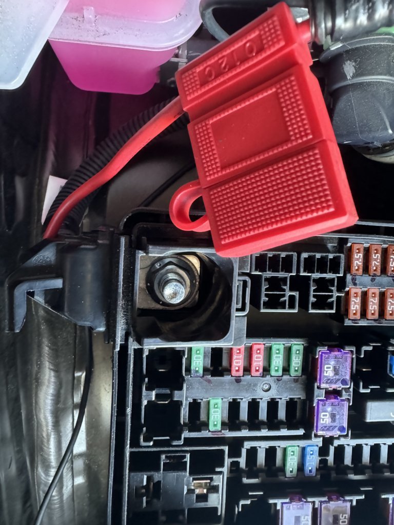

    Yes. The plastic cover on the power wire actually separates. I paid a tech at a local installer to do it for me. He was doing it for free but it was worth it to give him something for his time. He used a knife to pry apart the plastic housing that slides down into the notch on the left side of the fuse box. He had to cut away a small piece of plastic that interfered with the PowerAmp wire and the cover. It really was very simple. I could have done it myself if I knew that cover just snaps back together.

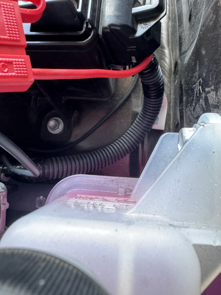

    yup, mine looks exactly like that!

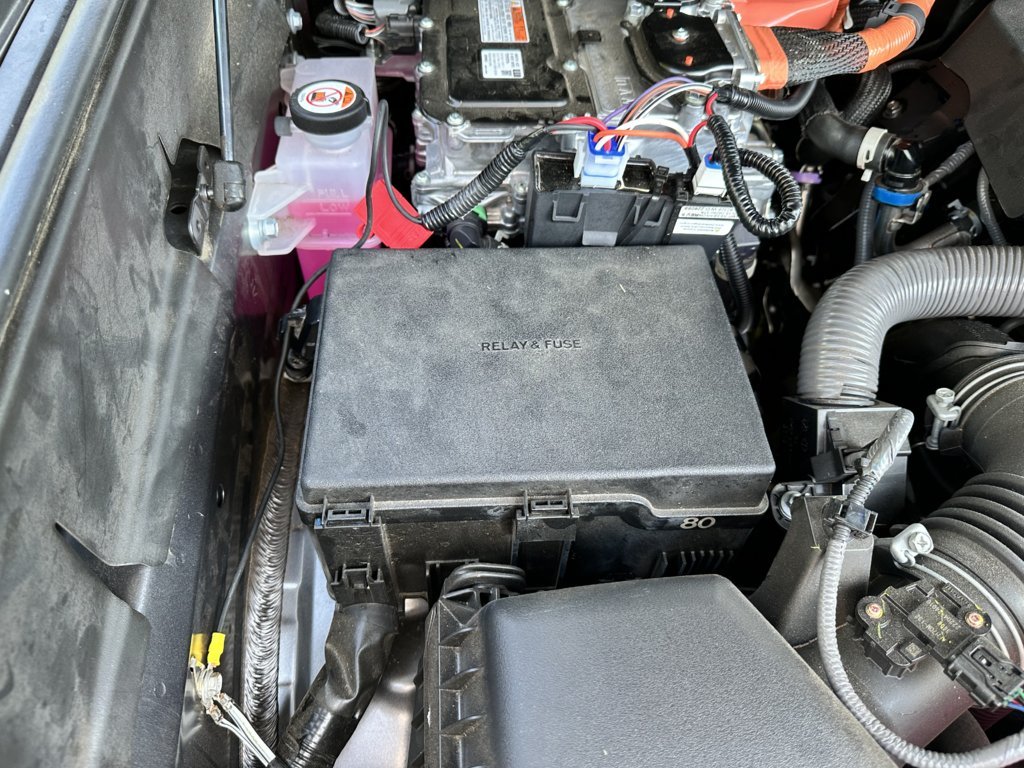

    Just picked up my '23 Hybrid from a local shop. Everything is working perfectly. My module is mounted on the fender wall to the side of the battery.
