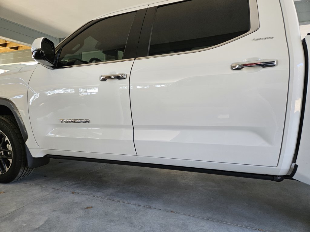

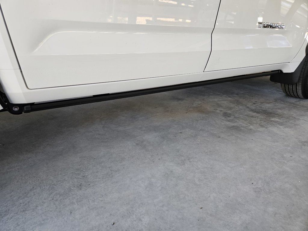

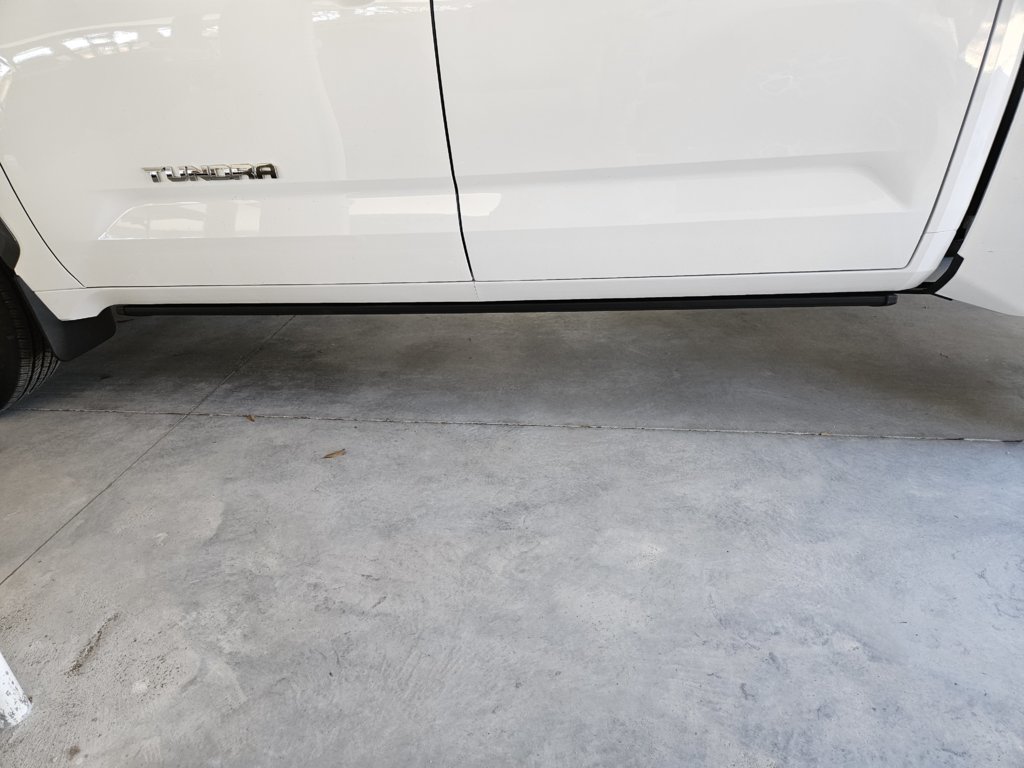

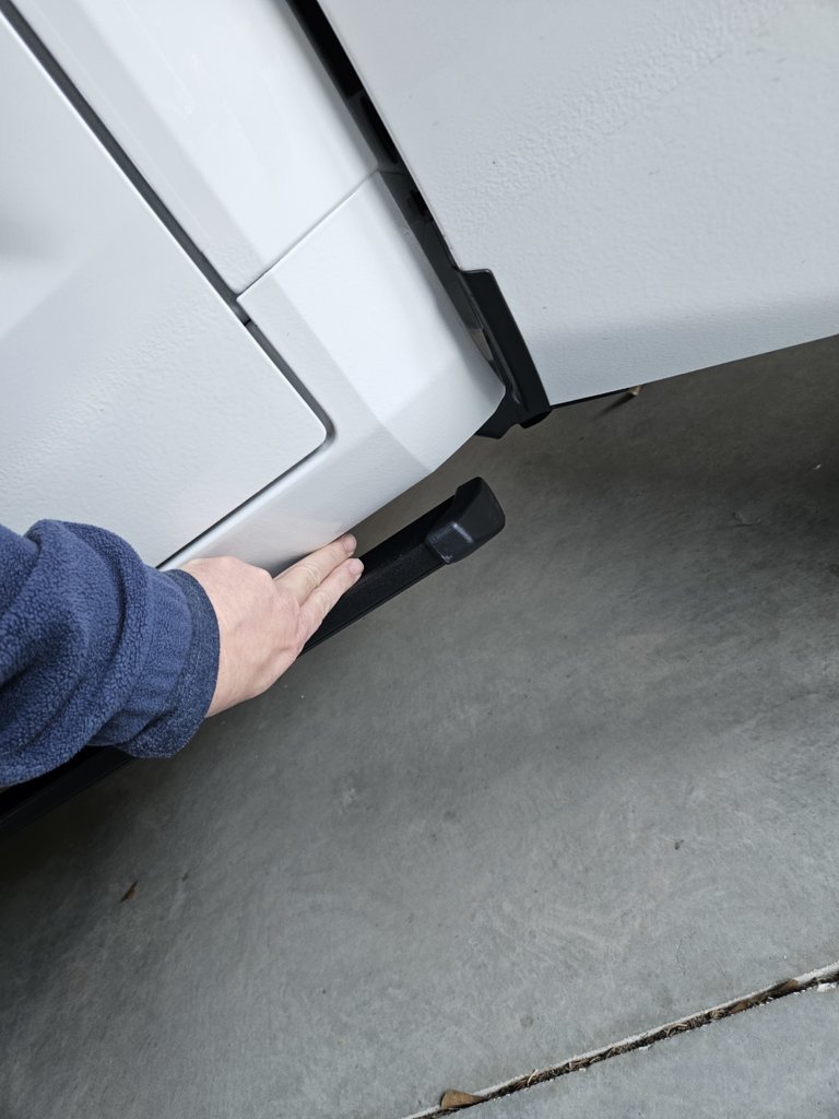

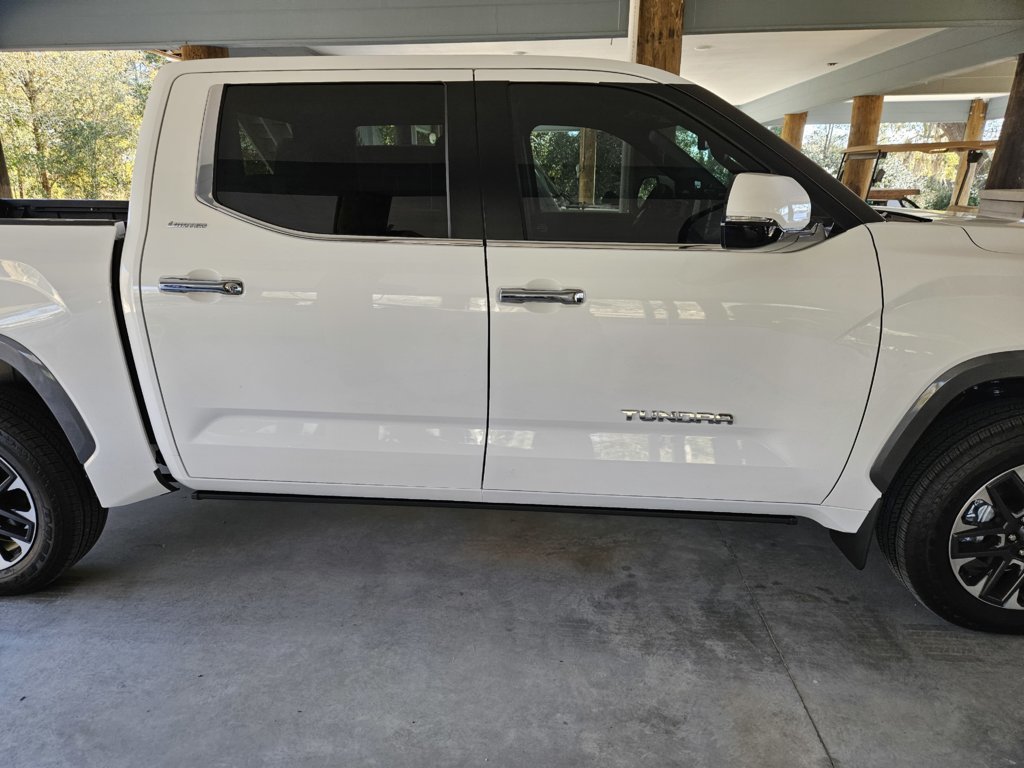

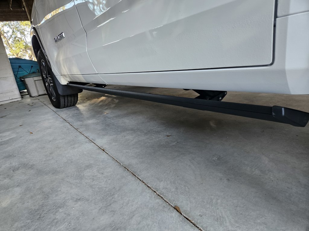

    Question about the retracted position on the standard AMP steps. Had mine installed locally and they seem to be too far away from the cab. Can anyone tell me if this is correct? I see lots of pics with the steps down but not when retracted. Appreciate your help. This is my first post hopefully my pics load. Thanks...

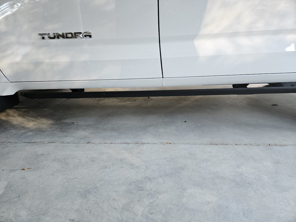

    That gap does look too big. Here is the drivers side front on mine. The gap is pretty consistent for the entire length.

    Thanks for the reply/pic. I thought that was how it was supposed to look. Hopefully its an easy fix and the guy doesnt give me a hard time about questioning his work. Looks cold up there.

    I installed them myself, but I don't recall there being any adjustment for that gap. But it's been a while. Yup, cold. We had another 4" of snow yesterday and the temps aren't to go above freezing even in the daytime until next Saturday and single digit lows the next few nights. Last time this happened my GF's water pipes froze, and I had a big project to repair. Pretty tough for this old Florida boy... and I am also a Gator. Looks like NW FL where I grew up is in for a snowy or icy mess. It is going to be carnage down there on the roads.

    FIXED - Called the installed and was told that's the way its supposed to be. No adjustment to make. He did offer to look at it. However when i looked closely figured out the problem. There is a stabilizer arm that attaches to the rear mount. The bolt he installed was too long and the mount would hit the bolt and stop before fully retracting. Pulled the bolts cut them down and reinstalled. Perfect nice and tight to the body like they should be.

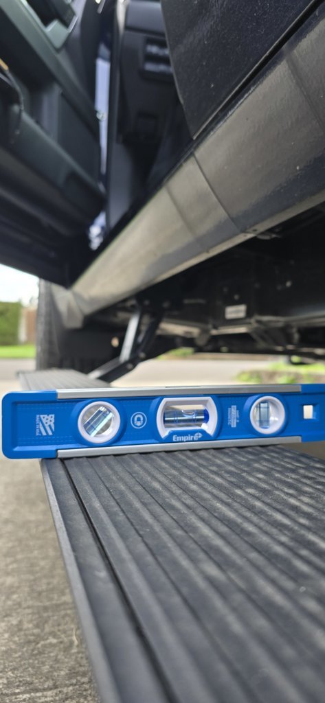

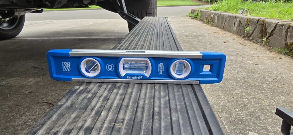

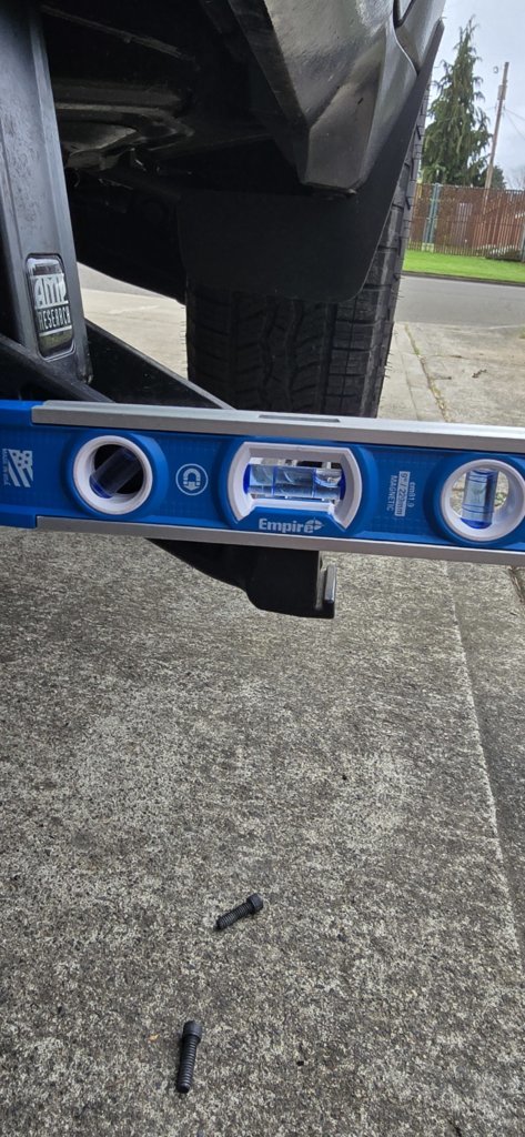

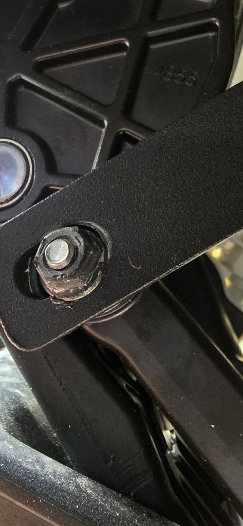

    I've personally had a terrible experience with the amp power steps so far on my 25 hybrid and am about to have them removed. I had a shop install them for me, and the level on them side to side is terrible on my passenger side to the point it feels like you will slip if you step out on to the step. My wife usea this side and hates them. Your toes point at the ground. I took it back to the shop who stated there is no way to adjust them, they tried to adjust them and failed
    I called amp tech support and emailed photos of the level of my steps and the difference between passenger and driver side level. The last tech support guy was a compelete ass and basically laughed in my face and told me they are supposed to be like that and there is no adjustment and if I don't like them to return them. Amp tech support sent me photos of their "master tech" who installed them himself and how unlevel his steps were side to side. They are saying it's normal.
    Not sure if anyone else has run into this issue or would no how to adjust them but I can't find any errors in installation. I also can't find anyway to adjust linkage that would allow it to sit more level. I would prefer my heel face up slightly when I step in, instead of down. I had a 23 Platinum with factory steps and they were awesome so I thought the amps would be great too. My 25 platinum has the OR package so no factory power step.
    I wish I would have installed them myself at this point as the shop wants me to pay them to remove them now in order to be able to return them.

    I'll put a level on mine and see how they sit. You could probably adjust that by loosening the mounting bolts, wiggling them around and retightening. You might also be able to put thick washers or spacers on the top bolts to change the angle a bit.

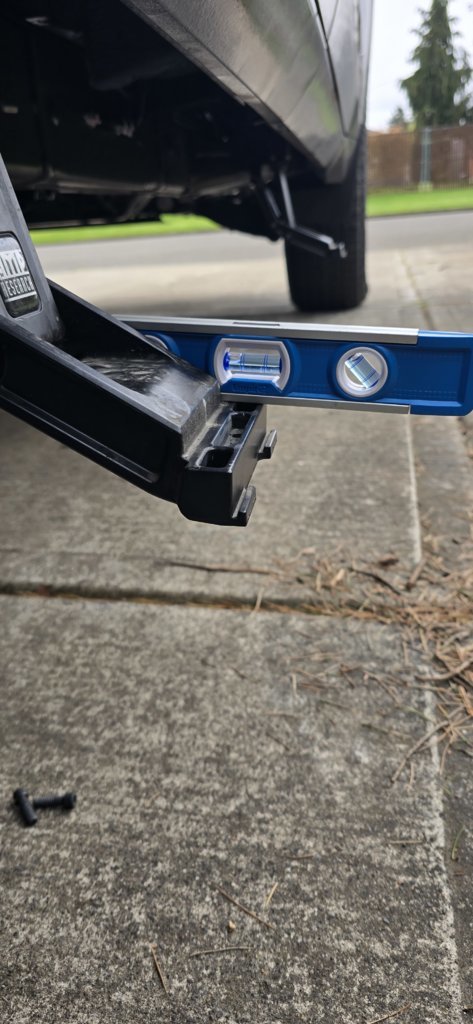

    Yea I'm gonna try and take the steps off the linkages on that side and see if the T-nuts in the channels are cocked at all.
    The shop botched the install of the rear support brackets on both driver and passenger side. They rattle gunned too small of nuts with no washers into the rear support brackets so the nuts fell through the channels and ended up cocked. I thought that would help but it did absolutely nothing replacing them and adding a washer. It's turning into a mess, the shop won't admit they installed them wrong even though I sent them the pictures of the incorrectly installed rear nuts in the support brackets.
    I get a different tech support agent each time and the three previous agents have all told me when deployed, and you are stepping into the truck your heel should point slightly to the sky as well as the outside edge of the step. Which is ideally how I would like them to be as that's how the factory step was angled, as well as if I look at pictures of the amp steps and especially the Go Rhino E1s they all tilt towards the sky on outside edge. It is very uncomfortable with this angle. It feels like I will roll my ankle if standing on the step with my toes pointing towards the front of the vehicle.
    These are the nuts the shop ran into the rear support bracket and won't admit anything was wrong with doing that. Amp sent me the "right" nuts with built in washers however they were an 8x1.25 and the through bolt in there was a 1/4-20

    I wish mine would sit level. I took the step off the passenger side today and removed the front and rear linkages and re-installed everything, torqued to spec. My boad will sit level until I torque the board down to the rear linkage. I removed the linkages again and tried to add extra washers to shim the top rear bolt, but it did not help and only made the gap uneven front to rear when the boards close. I sent more photos to tech support today. Seems the rear driven linkage is responsible for the off angle
