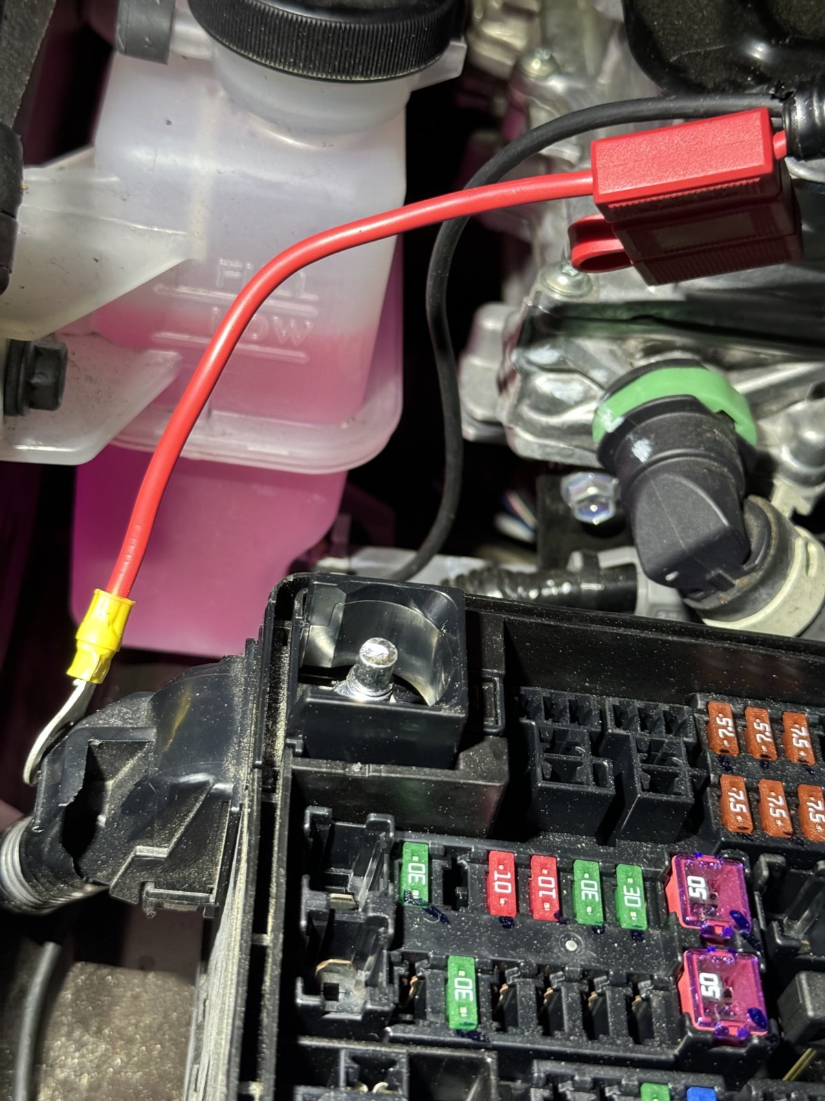

    For the life of me I can’t figure out how to get this ring terminal into this fuse box without some serious drilling.[​IMG]
    Once inside I still need to get down to the bolt to mount it. Can anyone with a hybrid send me a picture of your passenger side fuse box with the red wire installed? I have sent my question to Amp Research but no reply yet.

    Not sure what you are trying to do. Just hook that up to the + battery terminal. Unless maybe you have a hybrid?? I am not sure where the battery is mounted in that case.

    I wish it were that simple. Yes it is a hybrid. Amp’s instructions show it attached to that terminal with the fuse box cover installed but it’s just a basic black and white diagram. They don’t show how it enters the box. That connector is special and is part of the box.
