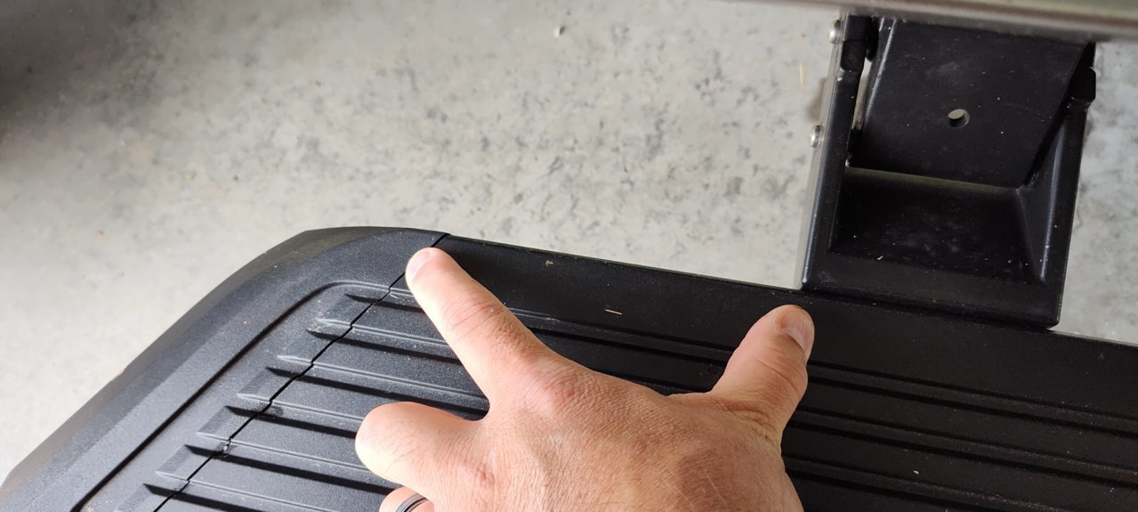

  7. Jul 19, 2023 at 3:51 PM
    #67
    Steen
    Steen New Member
    May 23, 2023
    #97457
    13
    Fort Collins, CO
    2016 Tundra TRD Pro
