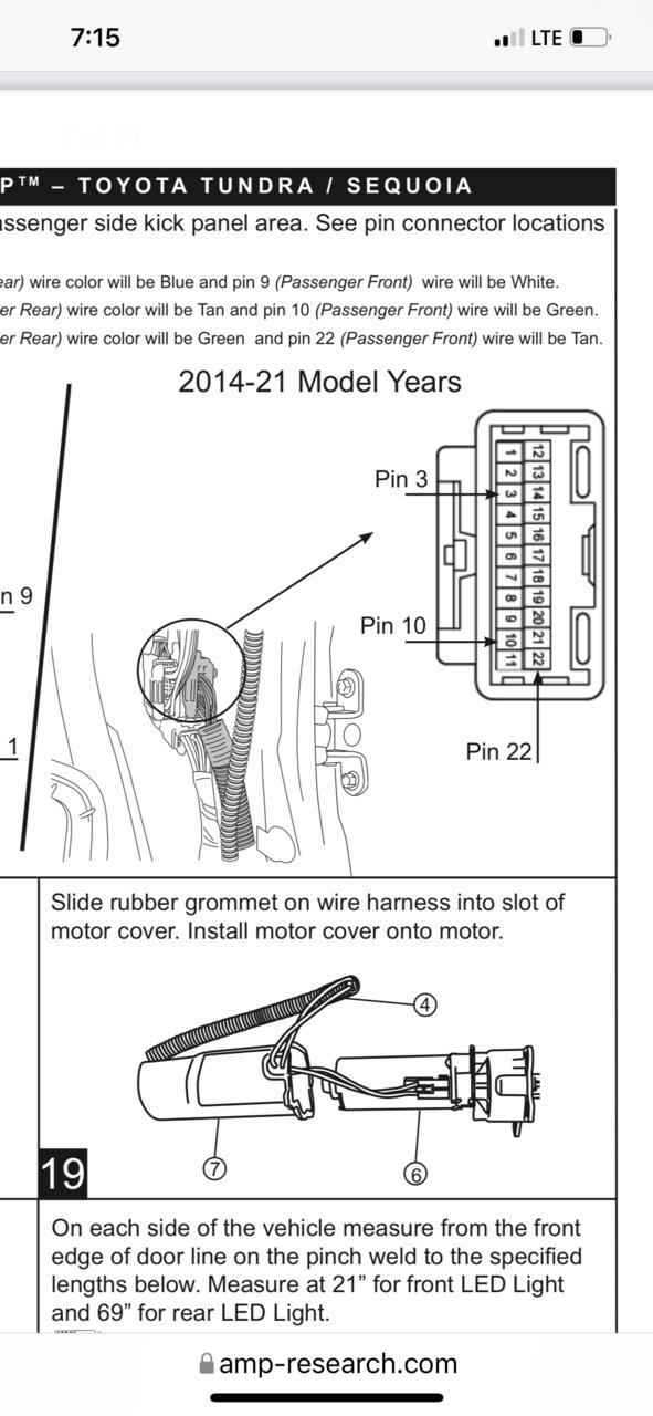

    This is the correct plug right?

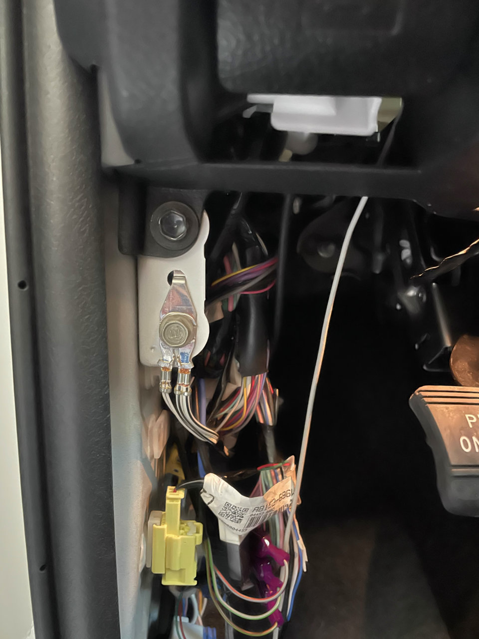

    I'm all done but one door. Three doors deploy the step as expected except the driver front. It does not. I am uploading a picture of the wire I tapped. I've tapped it with three different post taps, shaved a little of the plastic off to help get a better connection and still no luck. Perhaps this is the wrong wire?
    I've contacted Amp but they told me "keep trying".
    It's the bottom white bracket, blue/gray wire, 4th from the bottom. It looks slightly damaged but that's just because the times I've tried tapping it.

    Is this a ground? Amp guys are telling me if I ground the wire the wire in question, it should deploy the step.
    I simply touched that wire to a few spots in the wheel well I thought might be grounds and nothing happened. They're telling me to try again. If that doesn't work they want me to do a bunch of horse shit around testing wires with multi-meters for this and that (this is beyond my technical understanding). It comes down to they think they wire could be faulty and if that's the case, they send me a new wire harness and I have to uninstall the entire wiring I've done and re-install.
    I told them if that's the case they can take this thing back and I'll install running boards with no electrical. I'm sick of this bullshit. The wiring is the hardest part. No way I'm doing that all over again.

    Yeah, any of that metal in there is grounded. That's exactly what those two white/black wires are.

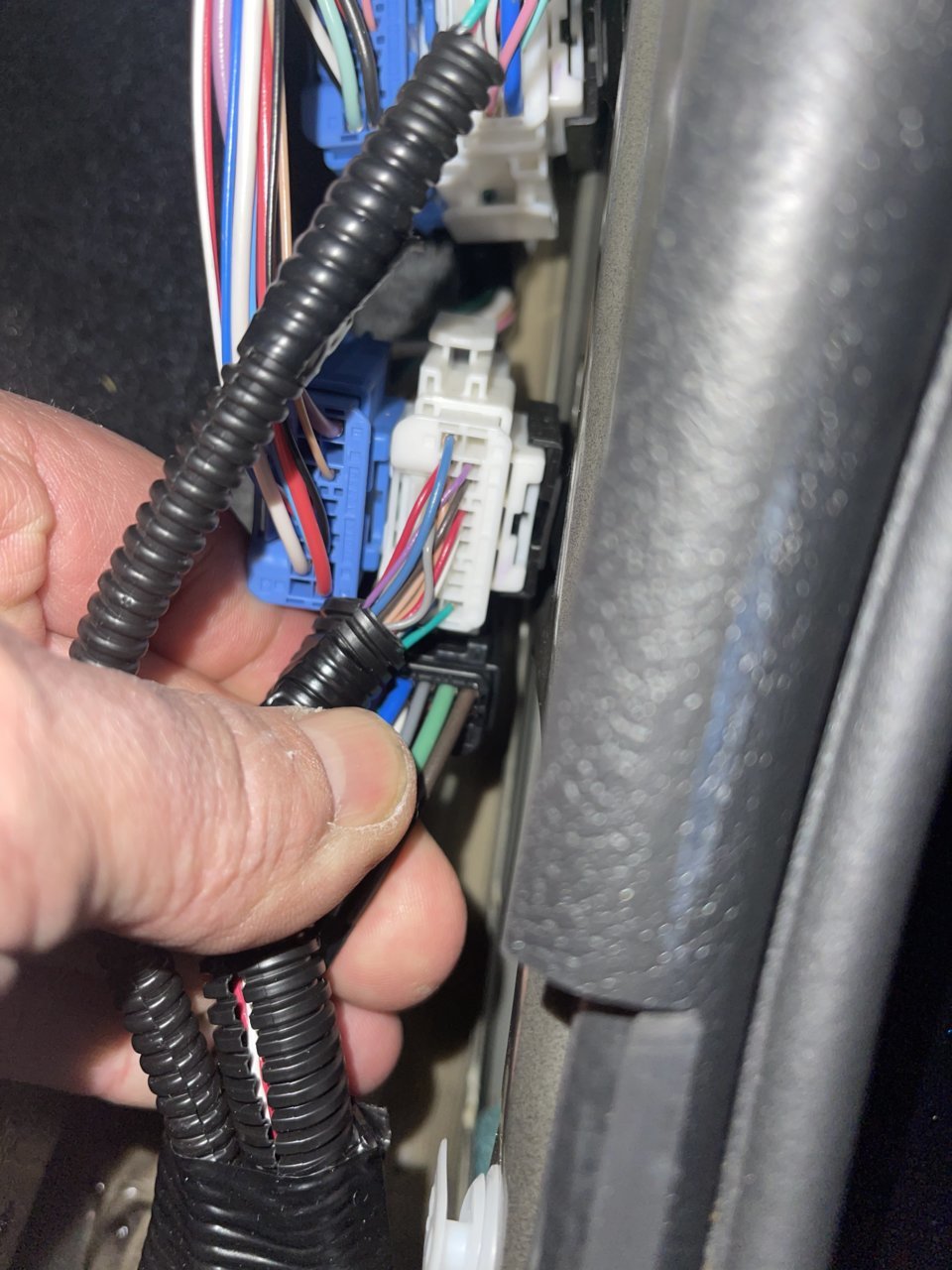

    It's fixed and working.
    Here was the problem and solution. The wire leading from the harness to my driver side front door needed to be pushed into the controller more. That's it. It doesn't give me a lot of confidence in the quality of the work on the wiring harness and controller. It doesn't give me much confidence that the wires won't back out because of the vibrations of driving the truck but for whatever it's worth now, it's all working now.
    Thanks to all for your help. Hopefully if someone else encounters this problem they'll read this thread and be able to push the wires back in and try it again.
