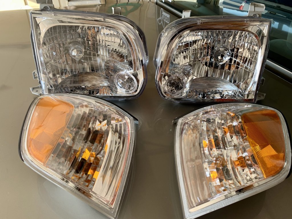

    Got the reflectors out w/o breaking anything, and was able to get the new mini-projectors in and eyeball adjusted them horizontally. Thanks @shifty for the tip on that.
    Couple thoughts/ tips for anyone thinking of doing this.
    Place a towel down to keep the fixtures from rolling around while working, it sort of cradles it.
    When removing the reflectors, I left the screw attached so it was stable when I collapsed them with long needle nose.
    I went around and folded one tab in at a time . . . take your time and do a little more than you think you'll need.
    When I was ready to attempt removing them, I had the long needle nose holding the reflector as I removed the screw so as not to drop it. I also had a 2nd smaller pair of needle nose to remove the screw once it was backed out.
    As far as that 'spring clip' that hold the bulb in place . . . I left that in . . .it seemed like a potentially easy piece to break or bend, especially the plastic tab area it was fastened to on the housing. I just took extra precaution to not bend or break that spring as I was removing the reflector.
    As far as the horizontal adjustment, I found it easier to loosen the set-screw on the side of the bulb before I installed it. Then I found the orientation with the 3 tabs on the bulb base, and put the spring clip back in place. I turned the fixture around and eye-balled the adjustment by hand. I took my time checking & re-checking . . . then tightened the set screw till I felt decent tension. I looked one more time to make sure that nothing had rotated before final tightening.
    Dust boot fit fine. And I put a little dielectric grease on the connection before securing the locking ring. The heat sink spun on fine . . . I ran it down till I got good tension against the back of the dust boot . . . but there was some threads left and I didn't want to force anything.
    Now I just gotta yank out all the old fixtures and put these in . . . carefully.
    Fingers crossed.
    PS . . . What's with the 3 plastic caps on the back of the housing? I think the top left covers and adjuster . . . but what are the other 2 that are recessed in the upper right and lower left?

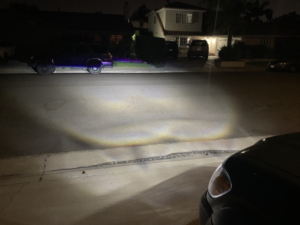

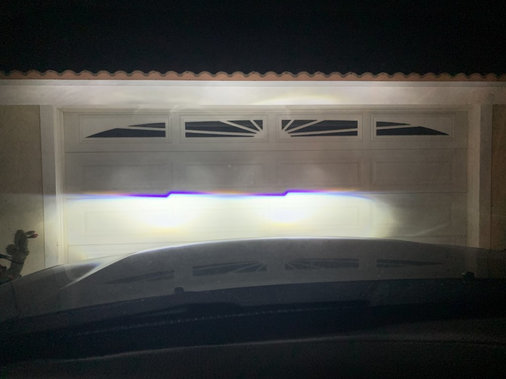

    So I got them pretty level.
    But 1st test down the street and people were flashing hi-beams at me.
    Need to adjust them down . . . def. a lot brighter than the halogens.
    Ordering a resistor I guess . . . when I turn on the fog lights, the hi-beams come one and that's it.
    I've also got the hyper flash thing going on.
    The drivers side marker lights don't come on . . . but they work because when I use the turn signal on that side, they hyper-flash.
    If I can get the bugs worked out, I'll be very happy.
    I'll get used to the blue/ purple line . . . no biggie.
    Before with halogens.
    After with colight led mini-projectors . . .
    I backed the truck into the driveway.
    Here's a shot of the spread with the lights pointing down at the street.
