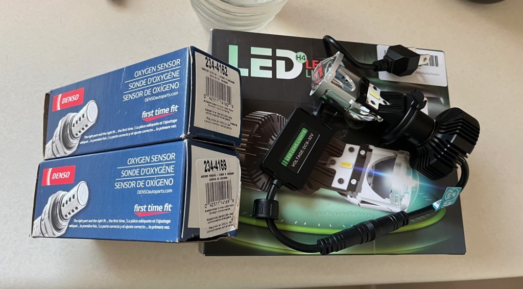

    Today's mail.
    Hutcheson, abcinv, G_unit3000 and 2 others like this.
