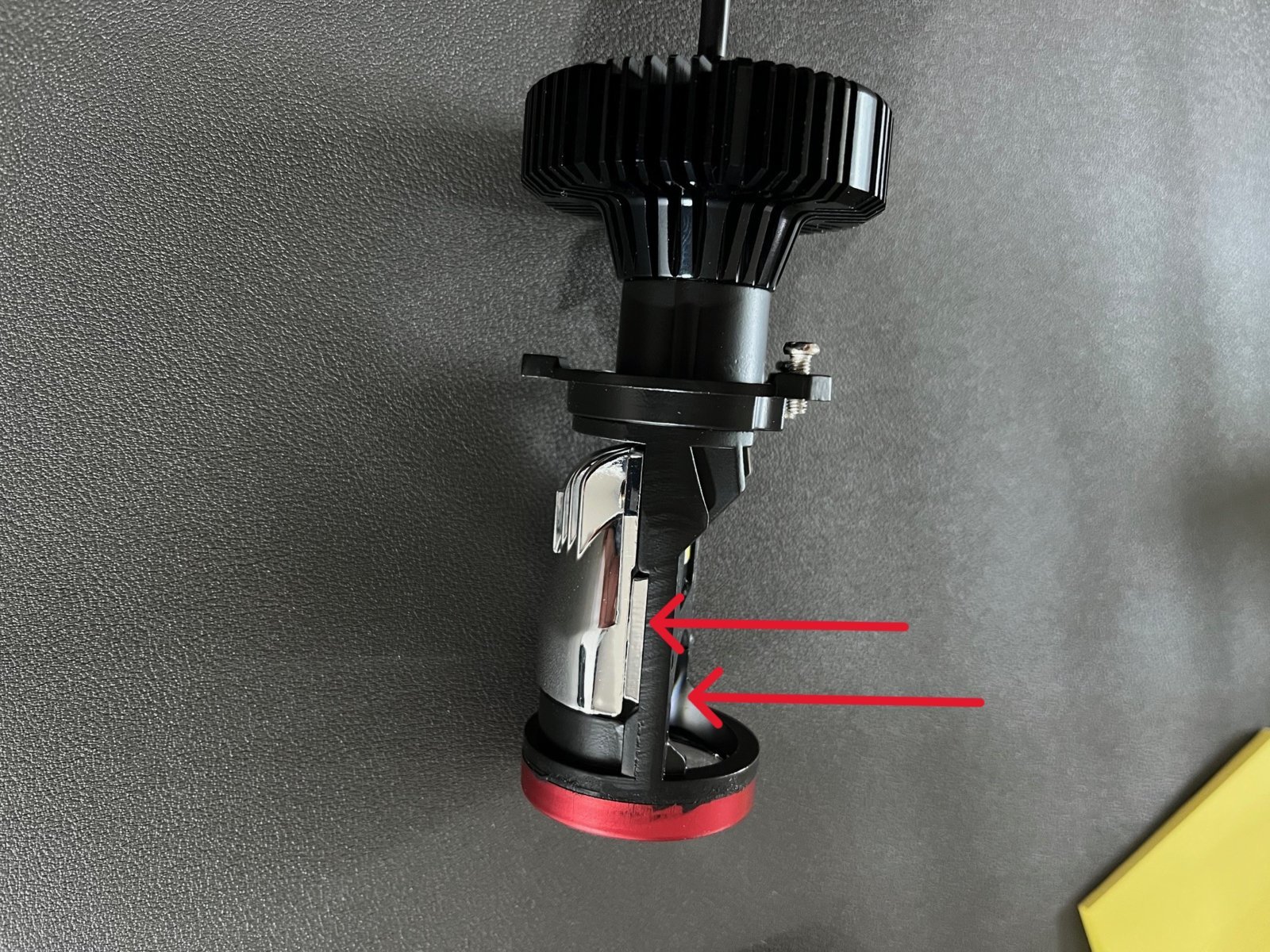

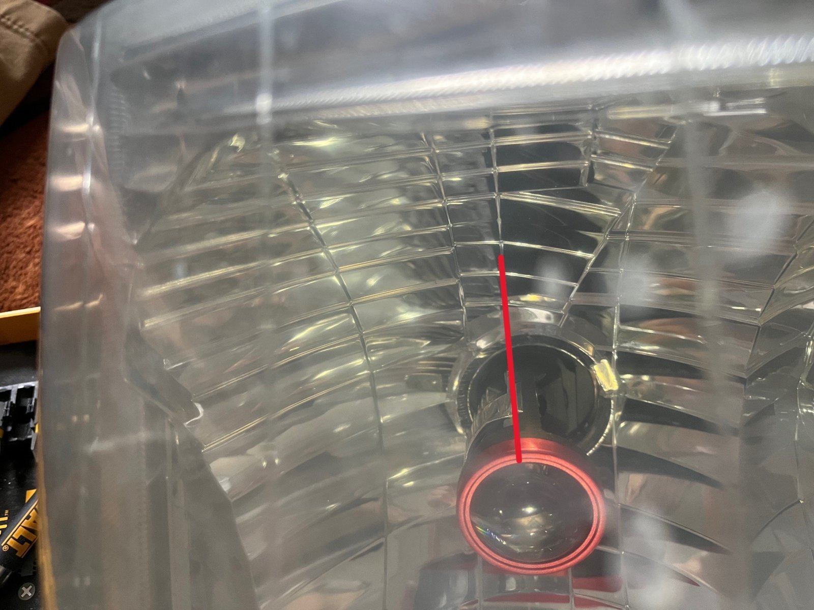

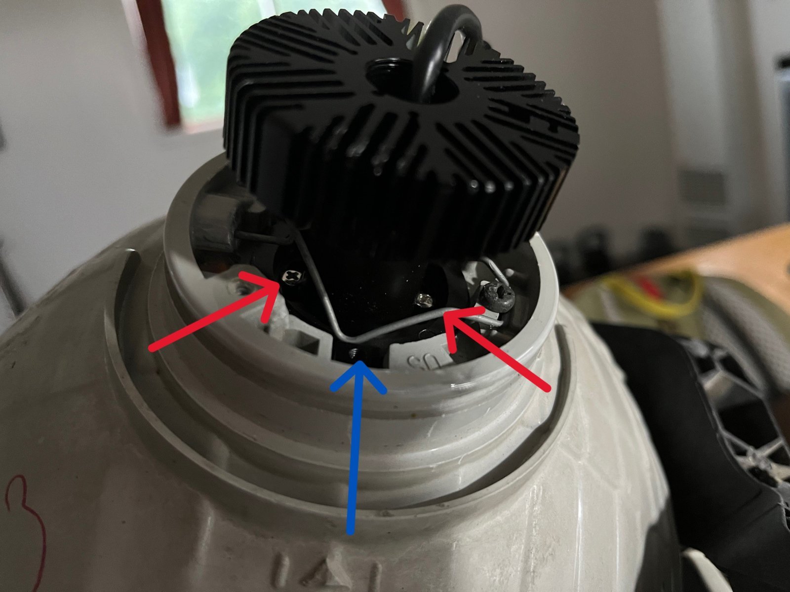

    Help me out here please. I can be dense...
    Can you explain this a bit more?
    First, do I have the right line? This is the driver side headlight.
    Second, I see that there are two adjustment screws, that allow the bulb to rotate on its axis, but I don't see a way to move the entire fixture up/down to get it centered with this line. The fixture sets in its place with the three tabs, and locks in with the metal clip attached to the housing. To have that line dead-center, the entire fixture would need to move up slightly, at least from this viewing angle. I can move it, but I'm prying against the retaining clip. It always sets back in place, flush, when I let go. I'm sure I'm missing something obvious. I usually do.
    Rotational screws in red. Metal clip in blue.

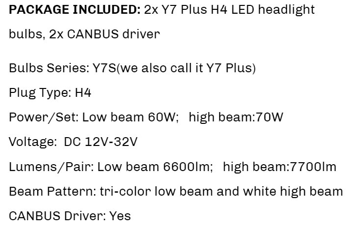

    Based on a Q&A I saw on the product page, these Y7s are as I feared. You have to switch the headlight on/off to run through each low-beam color setting. It's not all three colors at once, only one at a time. Will confirm once they're installed.
  27. Aug 13, 2024 at 2:14 PM
    #147
    KNABORES
    KNABORES Sarcasm incoming
    Jan 1, 2020
    #40572
    15,269
    Arkansas
    Those two lines in your upper pic should be parallel, not on an even plane. That gets the LED "bulb" portion aimed at the appropriate part of the reflector. But I can't see the bulb part of your projector lamp, so I'm not sure if it's lined up or not.
    shifty` likes this.
  28. Aug 13, 2024 at 2:23 PM
    #148
    MT-Tundra
    MT-Tundra Agnostic Gnostic
    Apr 11, 2024
    #115150
    1,386
    Montana
    2002 AC 4wd V8 Limited

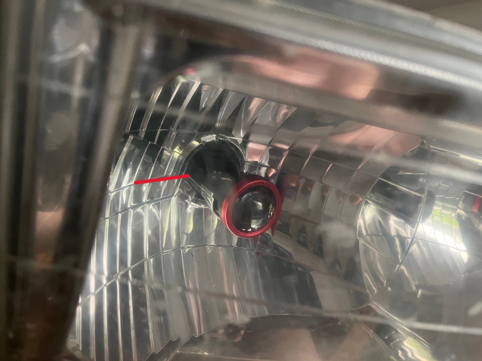

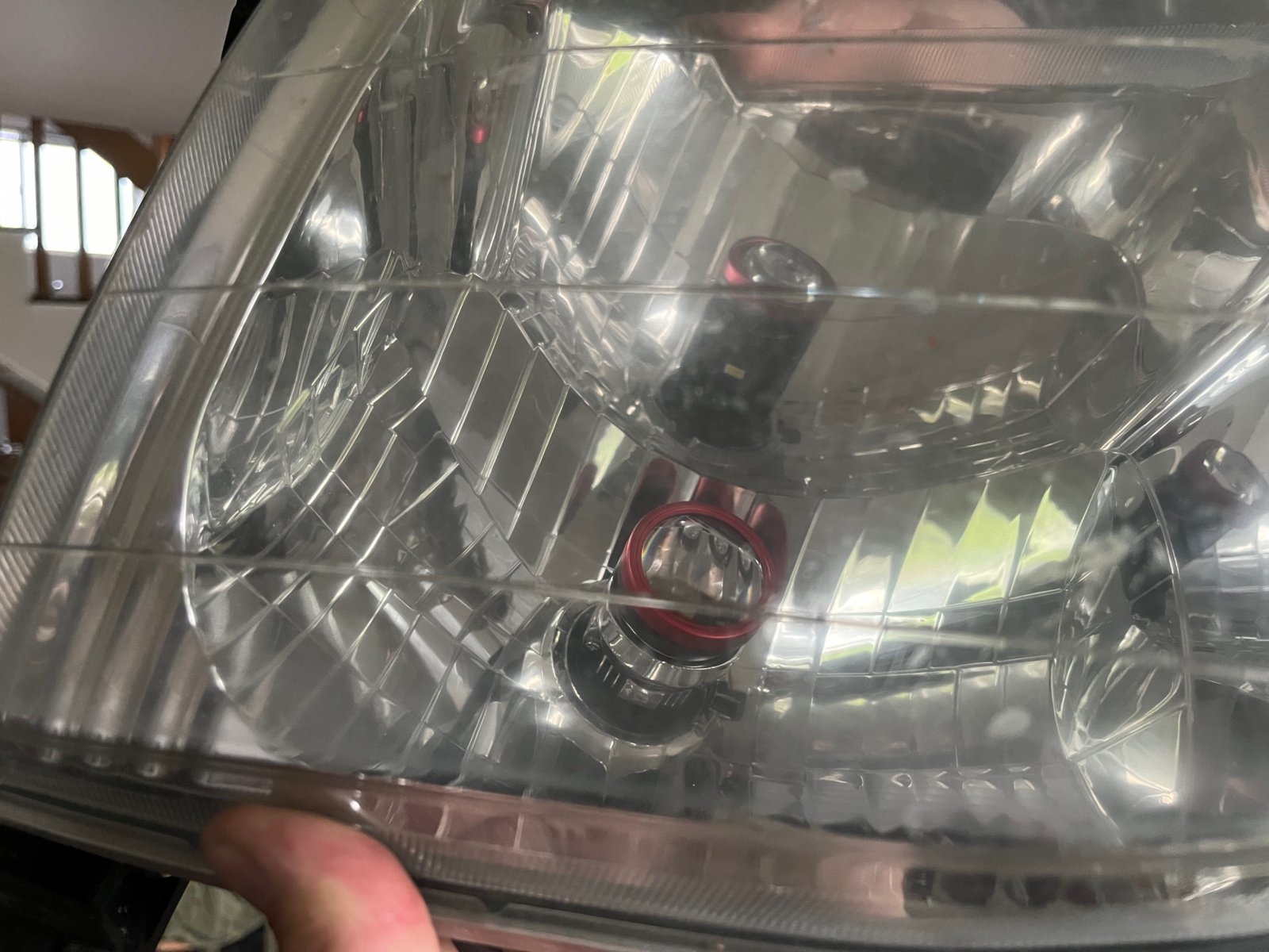

    Hmm...I'm not understanding your point. Which two lines? You can see the bulb in the reflection at the bottom of the photo. Basically the open side of the fixture is aligned facing down.
    Here I'm holding the headlight upside down. Should be able to see the orientation. I believe it's oriented right in the macro scheme of things, as in the open face is pointing down. But in the micro scheme, getting it "pre-adjusted" based on `shifty's post, I'm confused.
  29. Aug 13, 2024 at 2:28 PM
    #149
    MT-Tundra
    Apr 11, 2024
    #115150
    1,386
    Montana

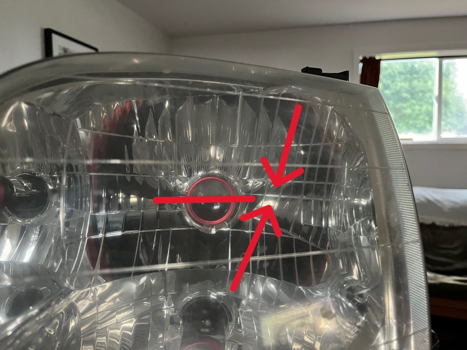

    Maybe this is what he's talking about? Getting this line on the fixture in line with this line on the housing?
    If that's the case, I'm good, no adjustment needed.

  30. Aug 13, 2024 at 2:46 PM
    #150
    MT-Tundra
    Apr 11, 2024
    #115150
    1,386
    Montana
    Is this what I'm wanting? Lined up with the silver part? When I turned it to line up with the black part, it was visibly crooked in the housing, kind of cocked facing down and out toward the side of the truck, rather than straight down.
    There's this black plastic, which is probably the true dead center, then there's the chrome part. Seems like lining up the chrome part is the right way, based on what I said above. But I don't know...
