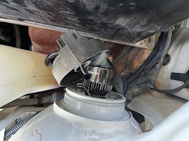

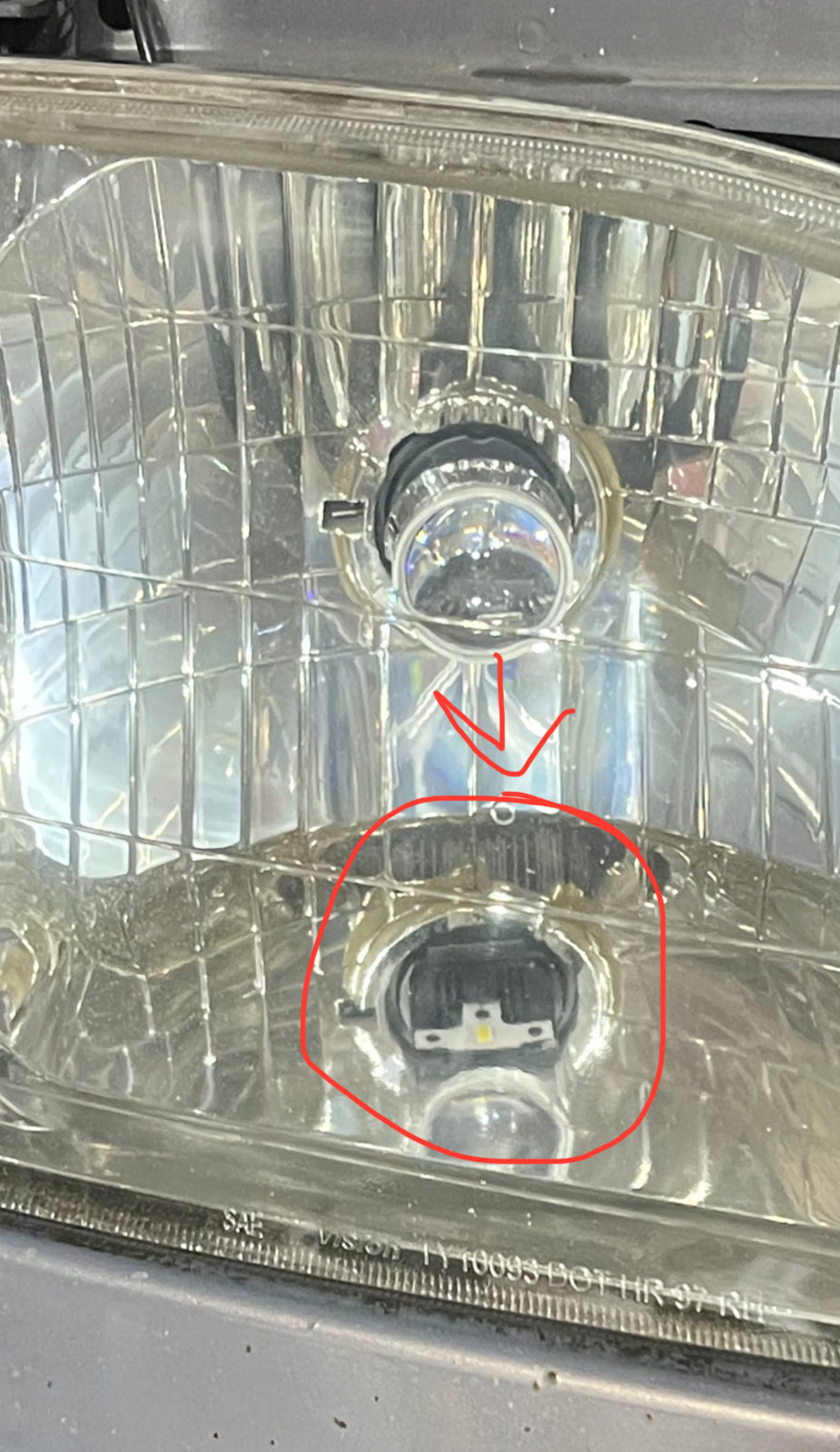

    As in the LED was pointing up? The bulbs (at least all the ones I've used) are clockable to point the LED wherever you want.
  2. Nov 17, 2023 at 8:06 AM
    #92
    APalmTree
    APalmTree Sometimes helpful
    Feb 23, 2020
    #43054
    810
    Brandon
    SW Washington
    2012 TRD Offroad White Crewmax 5.7L
    A few... Definitely more than 2
    I know they are clockable and in this picture they do need clocked but they are not upside down if that is what you are saying. This is not a great picture but I drew a picture to try and explain the problem. Behold! My artism :rofl: I feel like I’m pulling you all off point right now :thumbsup:
  3. Nov 17, 2023 at 8:09 AM
    #93
    KNABORES
    KNABORES Sarcasm incoming
    Jan 1, 2020
    #40572
    13,733
    Arkansas
    Your picture illustration shows the bulb with the LED pointing up, which is upside down.
  4. Nov 17, 2023 at 8:11 AM
    #94
    APalmTree
    Feb 23, 2020
    #43054
    810
    Brandon
    SW Washington
    Can't be... It only threads in one way. And after my fixing it looks like this... Reasonably certain I got it right
    I think I am confusing you all because you have the h4 version which is dual bulb. Yours has the high beam on the bottom totally exposed.
  5. Nov 17, 2023 at 8:14 AM
    #95
    KNABORES
    Jan 1, 2020
    #40572
    13,733
    Arkansas
    There is a set screw on the bulb that you loosen, rotate the bulb in relation to the base, then tighten the set screw. The bulb's base will only mount into the housing one way, but the but the bulb itself is capable of adjustment in relation to the base.
  6. Nov 17, 2023 at 8:18 AM
    #96
    KNABORES
    Jan 1, 2020
    #40572
    13,733
    Arkansas
    Should be LED chip down.

    Mine were not a set screw it was a collar that i had to put pressure on to jump 'teeth', but, I'm with you. I clocked the bulbs in my brother's truck. One more try here. That is is high beam on your bulb... the low beam is on the top side inside the shield. Mine does not have the full shield which is the problem I'm trying to point out. This does not apply to your bulb because it cannot leak light upwards like mine.

    We're talking about different bulbs here. H11 only has one element. It's not a dual element bulb like h4 which has a low beam element and a separate high beam element. Your H11 bulb is not like out h4 bulbs. Exposed element on h4 goes toward the bottom as knabores mentioned. Peace.

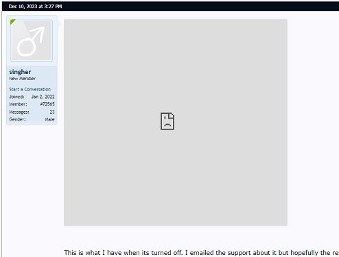

    Anybody have issues with the bulb flickering slightly when the truck is off? Just installed these and currently the bulb is doing some small flickering when the truck and light switch is off.

    That pic to Imgur is showing as broken - all you need to do to link videos from Imgur is copy/paste the URL from the address bar into your post body and the forum will automatically grab and embed the video.

    Thanks, was having some issues with IMGUR changed it to a youtube video now

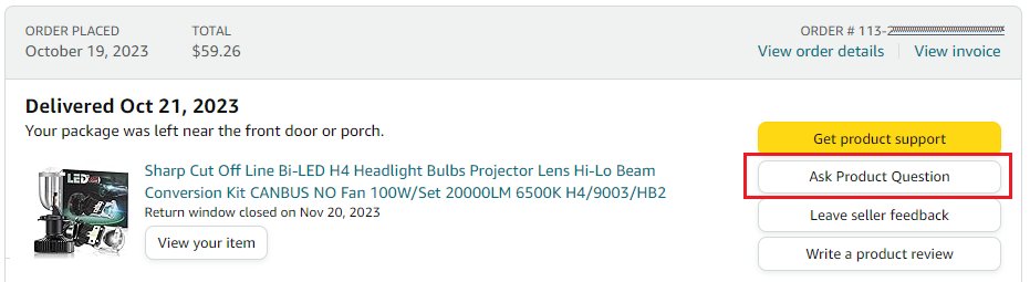

  27. Dec 14, 2023 at 3:14 PM
    #117
    shifty`
    shifty` Just like witches at black masses
    Jun 20, 2020
    #48239
    28,362
    ATL
    '06 AC Limited V8/4WD

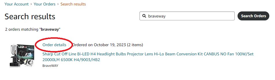

    Honestly, when I reached out to BraveWAY via Amazon, they offered to send them to me for free. To reach them, I went to "Your orders", searched for Braveway to find the order, then clicked the Order Details button.
    From there, I was able to click the 'Ask a product question' button (or maybe the get product support button?) and talk to them directly. When I told them others had issues with flickering and I thought I might need resistors for my year/make/model (I gave them that info), they made the offer to send, just sent some more info/pics. I got the idea from some product feedback another person left.
    dirtnsmores[QUOTED] likes this.

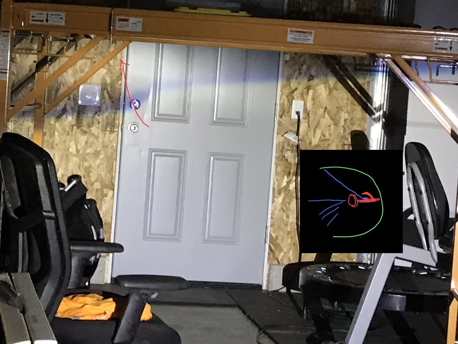

    Old-ish thread, but I'm just now digging into lighting. I haven't driven my Tundra much after dark since buying it this spring, but when I did, I noticed the headlights have already been upgraded, and I'm a bit worried they were upgraded without enough thought.
    The light is very dispersed, lighting too high up on road signs, and while there is a change when I turn on the brights, it's a pretty slight change. I'm afraid I'm one of those jerks blinding everyone. Some of this will come down to adjustment I'm sure, but I'm still considering different headlights based on what I've been reading here. Either Katanas or the CO lights.
