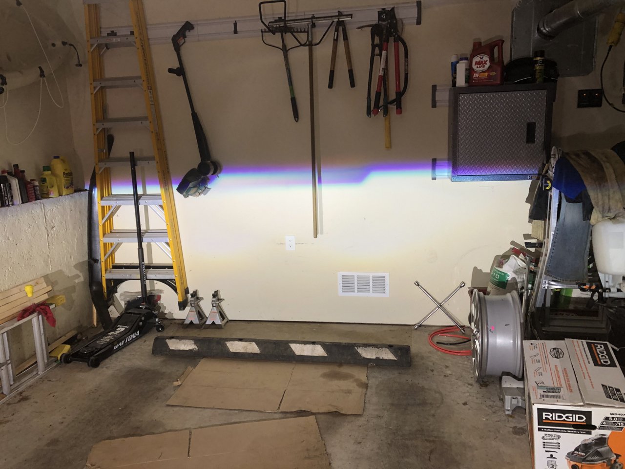

    They were definitely a smidge low in that picture.
    While that method of using other vehicles will work to get the height right, it won't get the rotation right. Reply #61 of this thread (page 3) has a couple of videos on aiming. I did a basic variation on a wall to get there.
    Rotation-wise, if you know this, ignore, but you want your cuttofs to be horizontally linear flowing into each other like _____/ ¯¯¯¯¯¯¯¯¯¯/¯¯¯¯¯¯¯ and not like stairs. This is the best pic I've got of mine after aiming and rotating roughly correctt; ass-end of the truck is down in this pic so the aim appears a few inches high here.

    I'll try to find a wall somewhere or something that I get 3ft in front of and close to 25ft back--have a couple places in mind give or take a foot or 2. And There is no horizontal adjuster on my year assembly, just the vertical slot for the philips head. Which means having to manually rotate the led itself by hand within the housing assembly? I saw others here have said colights are already pretty much centered

    Honestly, I used my garage. It's almost exactly as deep as the truck is long. If you can get it at 3ft and 10ft, that's probably sufficient. I know the recommendation is up close in the 3-5ft range and far out 20-30ft range, but frankly ... that's "ideal" while "good enough" also works.

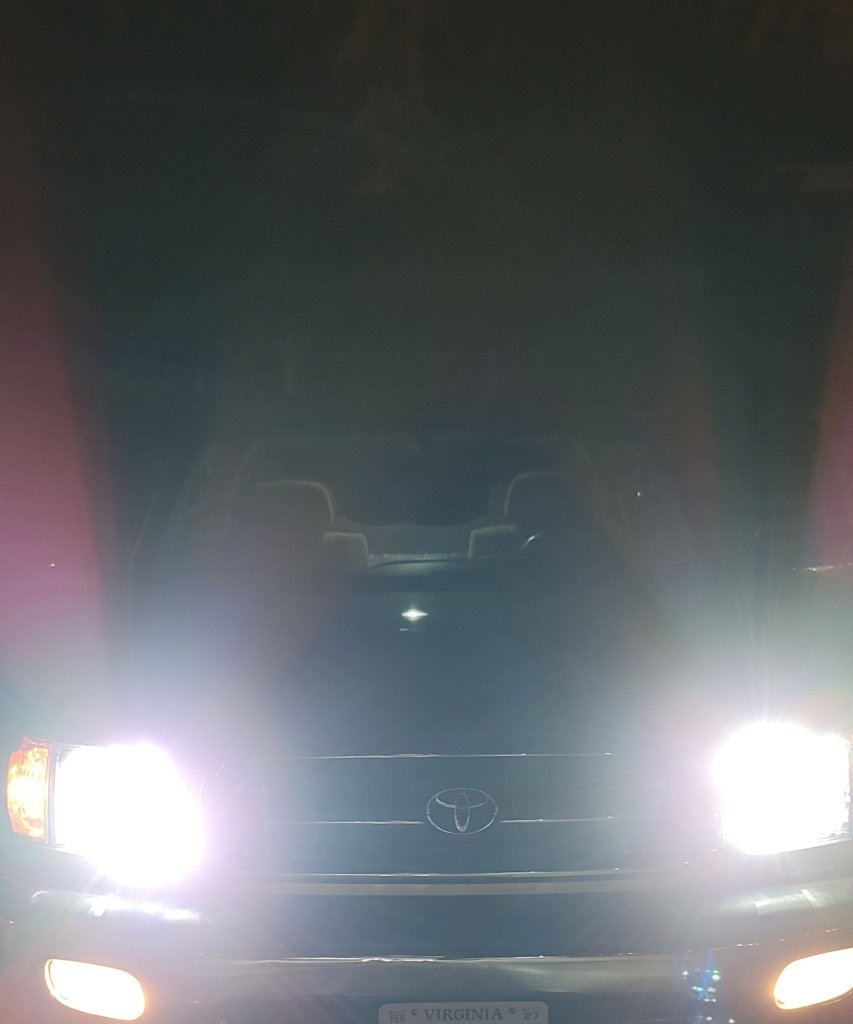

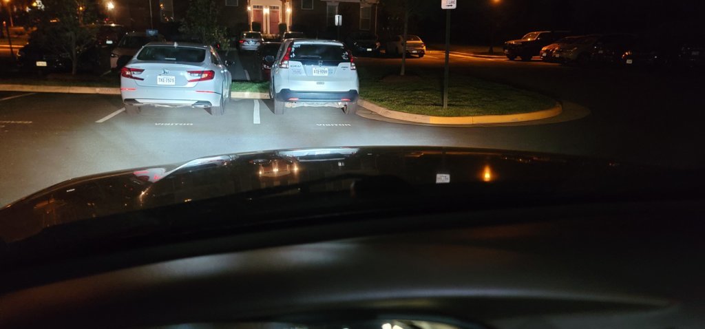

    I'm an idiot, these are clearly the high beams that are on. Removing the passenger side resistor made the high beams stay on whether I switched the lights from highs to low. This picture shows the low beams on (really highs) with the fog lights on--switching to highs only shut the fogs off while the headlights remained the same. Putting the resistor back on and they worked properly again except that the passenger side light is still not putting out barely any light. Already contacted Colight but I'm considering more readily available mini projector options since the reflector is removed--don't feel like waiting days for the email exchanges w/COlight followed by waiting another week or 2 to get the replacements from China

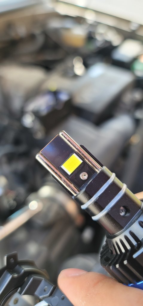

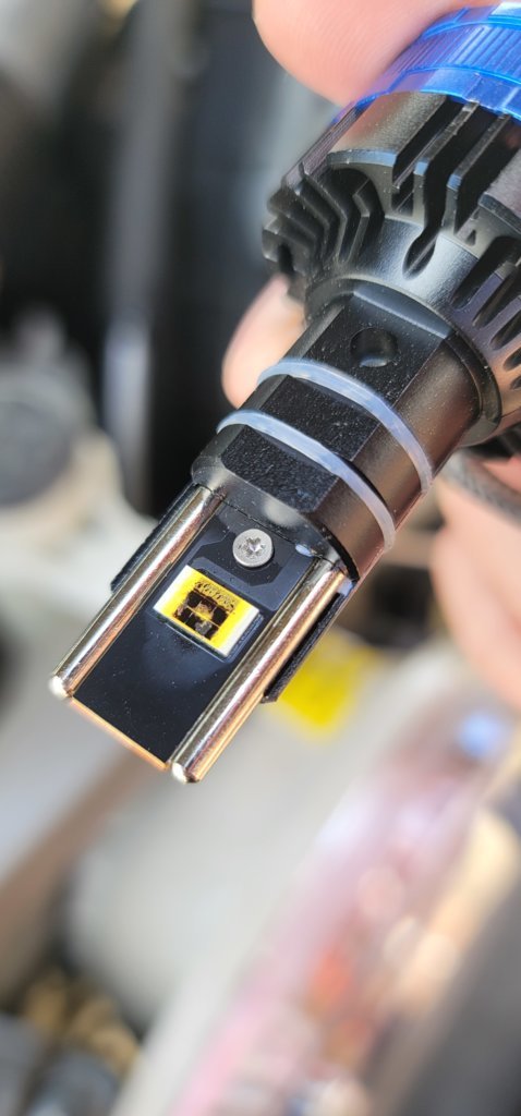

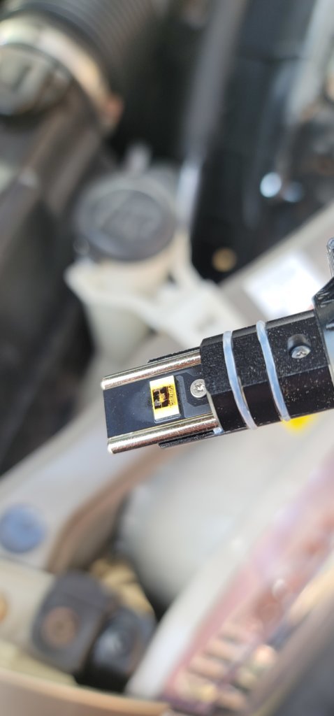

    My colight replacement bulb finally come in today. Will wait until the sun goes down to get pictures of both Y16s working properly but will adjust them later.
    For anyone planning on doing this upgrade, inspect both sides of the leds to make sure neither the highbeam or low beam are burnt out. See my photos of my passenger light led visibly burnt. Also a picture of the replacement new/good led for comparison.

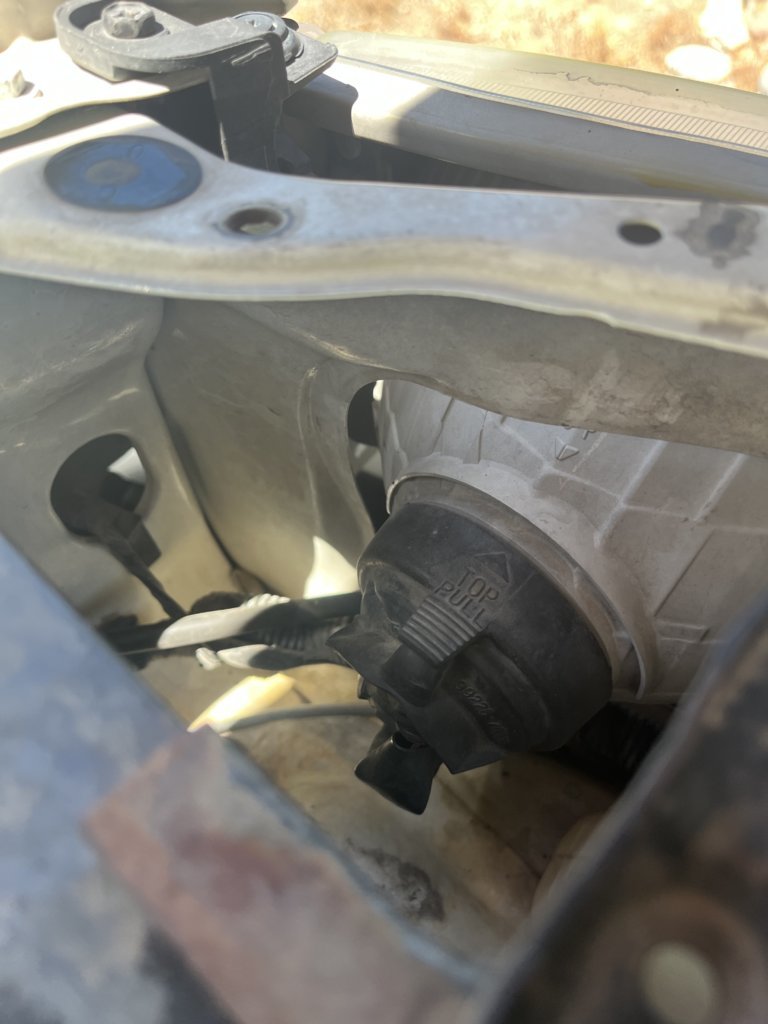

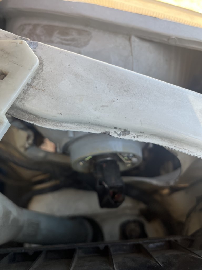

    Thanks y’all, finally a win. So next questions are the pass headlight is missing the boot and the connector is a little toasty. Is this something still available, are there upgrades to the boot or connector. I’ve read this thread 3 times and I’m still confused as what is a good headlight replacement or upgrade. I’m looking for something that is a known quantity of either replace or upgrade, a lot of this thread seems like conjecture or is hard for me to understand, I’m not the brightest bulb. thank you

    I think I’ve got some spare boots somewhere. I run the aftermarket upgrade harness to prevent plug burning like that and juice the lights up a bit more.

    The harness is available on Scamazon. Takes your factory light plug and adds a relay with dedicated power to the lights.

    If you decide to run the harness you won't be using that plug for anything anymore most likely. You'll only be using the driver side plug to control the relay harness.

    Melted headlight electrical plugs are a big reality in the vintage Porsche community especially since many installed 100W halogens. Pelican and or there’s sell ceramic connectors that will fit your terminals.

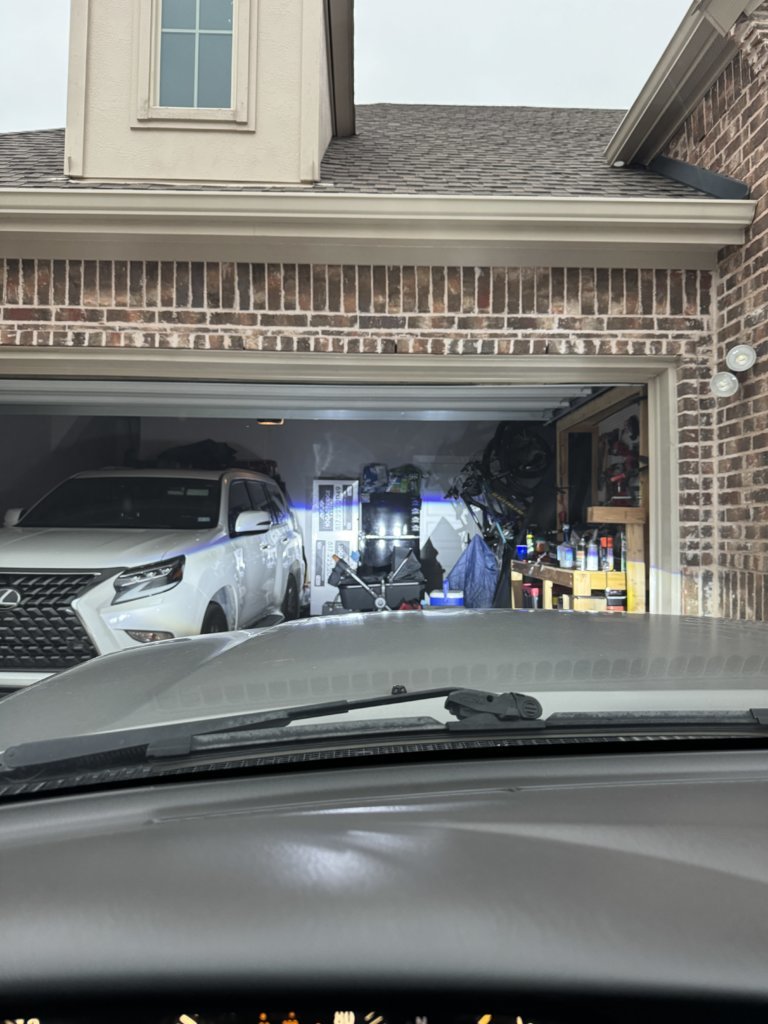

    Still haven’t driven at night. Compliments of the baby, but yeah these are definitely brighter than the other mini projectors.
