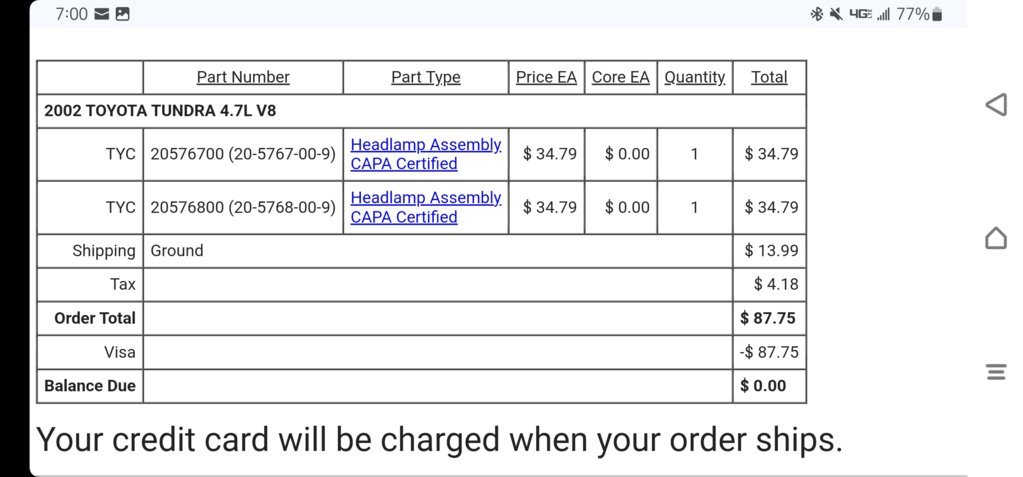

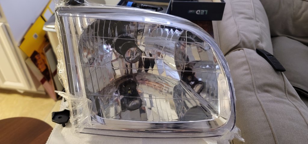

    Just ordered some TYC headlight assemblies, shipped for under $90--I don't mean to pile on shifty, but I can't believe these ACs are only $35 each and the '06 ones he paid for were about $80 a piece. And that was a couple years ago. Probably because it's a teardrop unit?
    As mentioned earlier--I was also wondering if anyone else has tried any of CO light's newer models(Y9,Y12, Y16)? Seems like most only have the y6s, 7, or 1. I'm about to just pull the trigger on the Y16's since they claim to be the brightest/latest and greatest and also have the highest w output based on the chart above. The fans/fanless isn't a huge issue for me and I'm not a fan (no pun) of the y7 color cycling process.

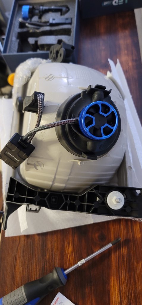

    This comes with the canbus decoder, is that the same thing as the resistors mentioned previously that will fix the fog light/high beams issue or are those 2 separate things?

    Got ya, I'm just wondering if the resistors are being used in conjunction with the provided canbus decoder for those that had that issue? Or if the canbus decoder is the same thing as the resistors that people bought online themselves and that CO light decided to finally include after so many have had that problem.

    According to the CoLight article linked below, their CanBus/Combination decoder contains resistor, capacitor and circuit board to help with the lower resistance of LED on a system that designed for higher resistance of halogen bulbs.
    https://www.led-colight.com/blogs/news/what-is-canbus-why-you-need-it
    Your 02 possibly only needed resistors but the decoder came with purchase….gravy !!

    Y16s installed in TYC assemblies. Will throw them in tomorrow, hopefully won't need to adjust much--kinda just threw the leds in and hoping for the best. Pictures of the mangled reflector still in the assembly(used needle nose to compress each side one side at a time, using needle nose only seems effective if the reflector is still screwed on)

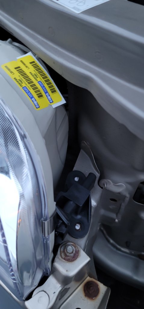

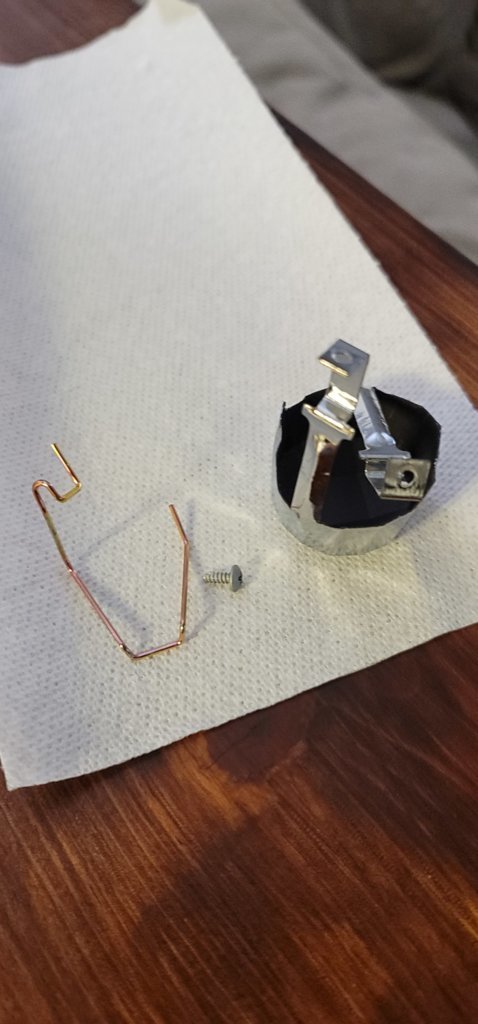

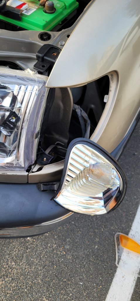

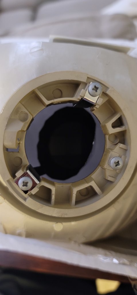

    Welp, turned out that I'll need resistors. My highs' and fog lights don't work with these as others have stated as well. Also one of my side markers was a complete PITA to get off and even slightly pulling on it or trying to use a plastic trim removal tool on it caused the whole cover to comepletely off. Needed to order replacements anyways. But the biggest problem is...rusted bolts. All were rusted and froze together and broke clean off on the passenger side. Its the bolt part (male part that is part of the frame), the headlight assembly is only being held on by the Phillips head screw. How can i fix this, is welding the only option?
  15. Apr 15, 2025 at 6:43 AM
    #405
    Teutonics
    Teutonics BestGen Member
    Jul 31, 2021
    #66184
    208
    2005 DC SR5 4WD
    I'd see if I could get to the back side of where those studs are mounted. If yes, I'd drill holes where the studs are and use regular bolts to pass through the holes. If you can't get to the back side to tighten them down, then I'd probably still do the same thing and just tack weld the bolt in place once passed through from the back side. They don't require a lot of torque, so you might just be able to epoxy them into place... all you need is for them to not turn while tightening down after installing the headlight housing.
    Dblock500[QUOTED] likes this.

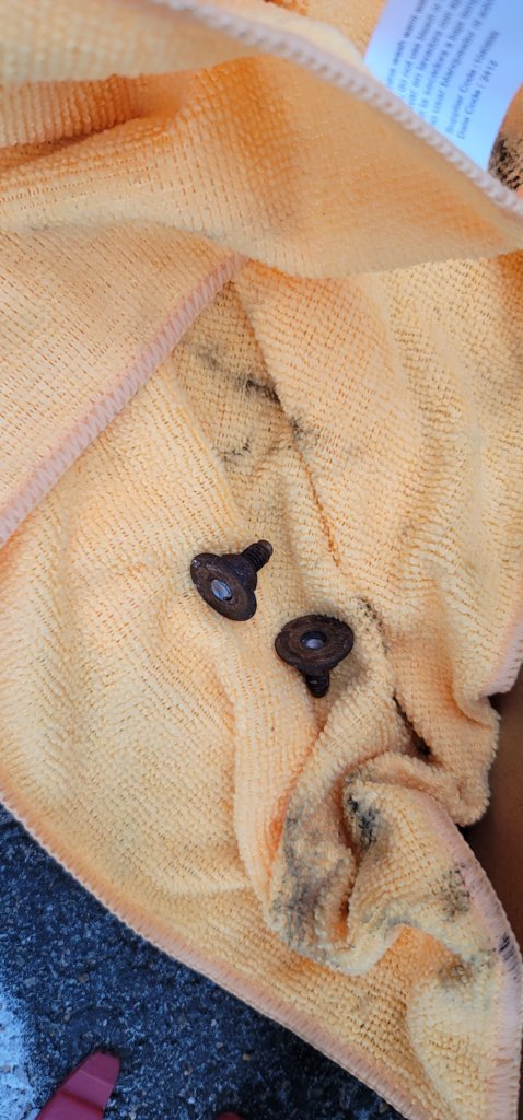

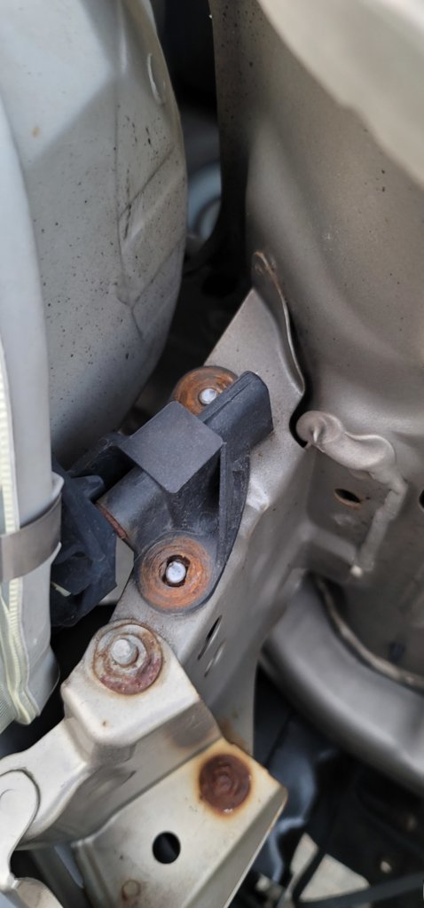

    Yeah i think drilling through might be the best thing to do. They aren't removable bolts anyway and are a part of the larger metal piece thats attached to the body/frame. Drilling them out and using regular 10mm bolts to replace them is what I'm thinking so far. It might pretty difficult to get a drill in under there though

    I snapped all of my headlight bolts as well. I drilled them out and replaced them with M6 bolts and nuts. It was a bit annoying to get around the back to get the bolts through the holes. You could probably drill out the snapped bolts and use a large self tapping screw, or maybe even drill them and tap a larger thread size into them.

    Hm glad to know I'm not the only one that experienced this. And feel better about tackling this knowing you were able to get it done this way too. Did you have to use any type of lube or cooling liquid for a drill bit? Or did you just find a more durable bit slightly smaller in diameter than the bolts and have at it

    I honestly don’t remember, it was probably close to four years ago. It’s not a crazy precision operation, as long as you can get a hole around where the bolt was you should be fine. You could use WD40 or similar to cool the drill bit when drilling.

    I would definitely get new, good drill bit, go at slow rpm, and use oil. Most of my trouble drilling out bolts (which is enough of a pain even when you do it right) is going too fast and not using oil. Too fast and too hot just hardens the bolt you're trying to drill through.

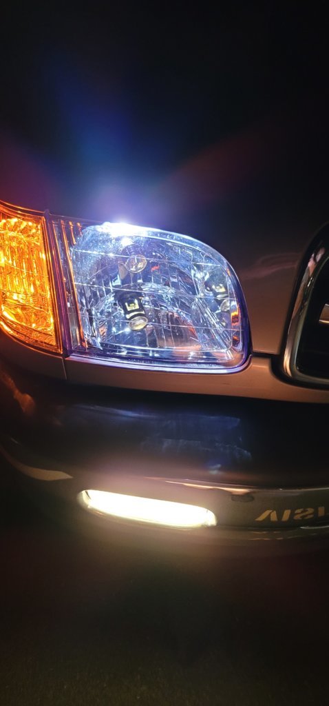

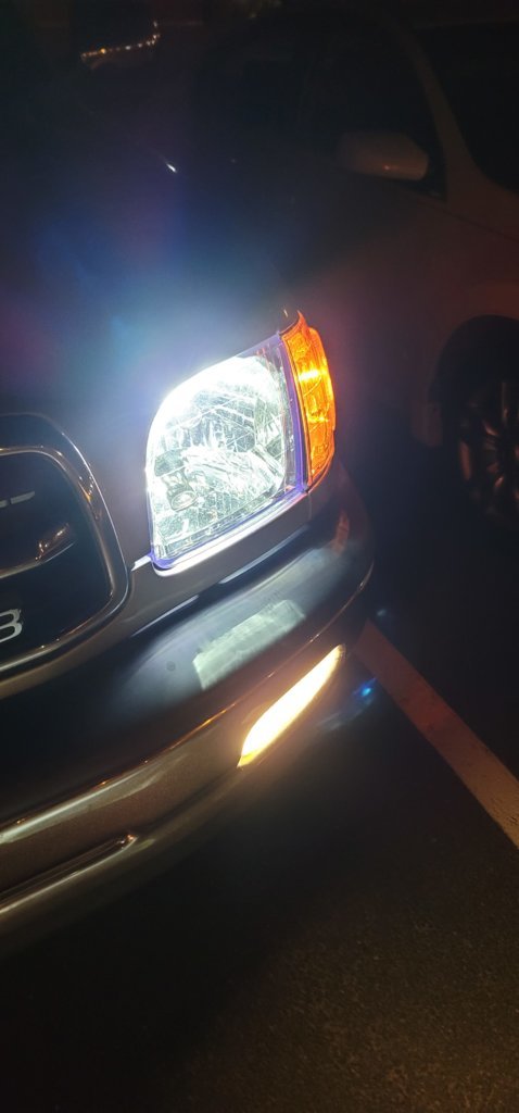

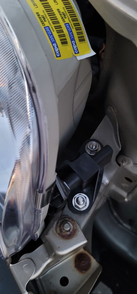

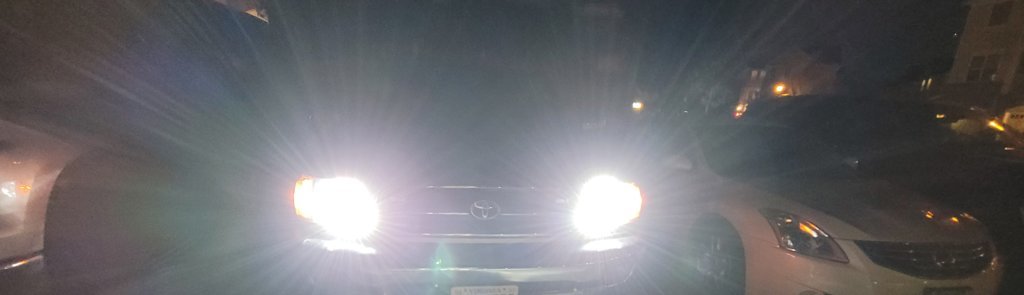

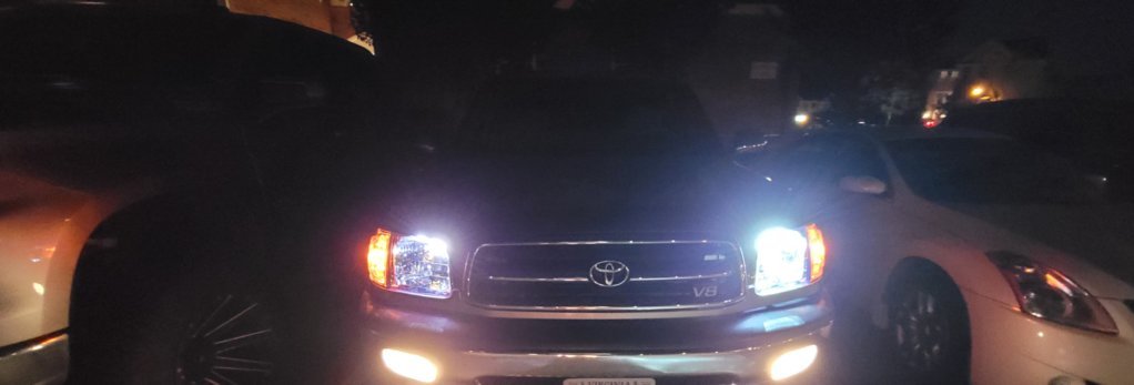

    Drilled the bolts out, put in 1/4 inch replacements. Also installed the new resistors (in conjunction with the already supplied ones from CO light) which solved typical light issues. I have noticed these side markers dont seem to click or snap in place into the headlight assemblies like the oem ones do with the little side clip/latch. Feels a bit filmsy and has some play if I push on it.

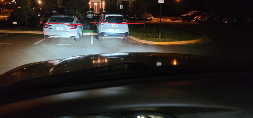

    Also, not sure what's going on with the passenger side light, it's not nearly as bright as the driver side in lo/regular setting. However it seems fine when highbeams are on. Anyone have this happen? I'll go back in and disconnect and reconnect to make sure it's on solid enough but seems odd.

    Yeah there's definitely something going on with the passenger light. No idea if it's a connection, or just the reality of mass-produced disposable products.

    You got a defective light. Contact the manufacturer. Share both pics. They should send a new one and/or new pair, ideally, to make up for the f-up.
    The output looks nearly identical to what @RUSTYNUTS had when one of his low beam chips burnt up.

    You can actually halfass dial it in to about the right level sitting in that exact spot of this parking lot, facing those cars, from roughly that distance.
    Basically, you need to make sure you're not blinding from the front or the rear. If the vehicle in front of you is at normal ride height (i.e. not lowered), your headlights should cut off right about the top of their trunk. Any higher than that, and you'll blast their rearview mirror and blind the fuck outta them. And because the driver's head is usually about the same height as the rearview mirror on the windshield, if you're shining high enough to hit the rearview from behind, you're blinding the shit out of them from the front. Get yourself to about the red line in the photo below. Or, for reference, after my install I went a little overboard and was a hair too low as you see in this pic. Ideally, you want to be higher than that, but lower than where you are.
