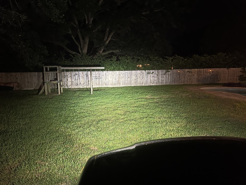

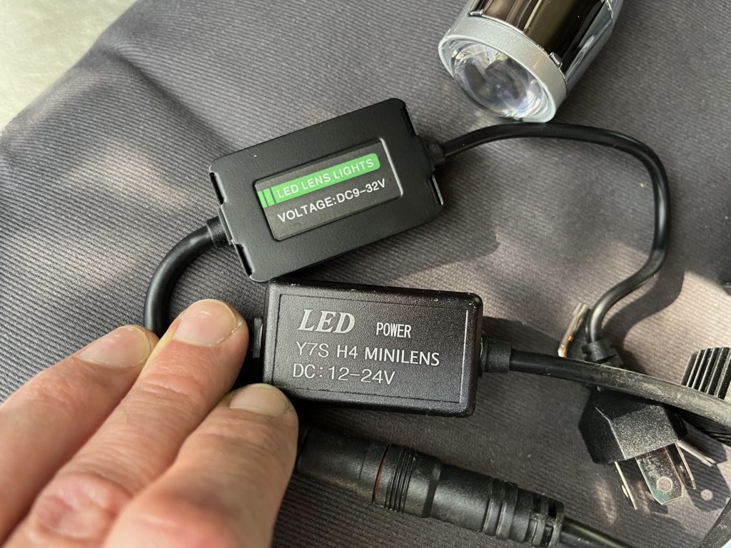

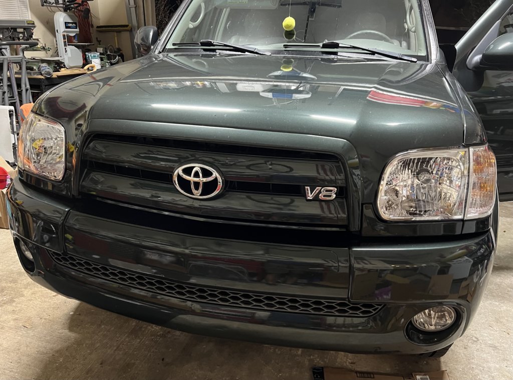

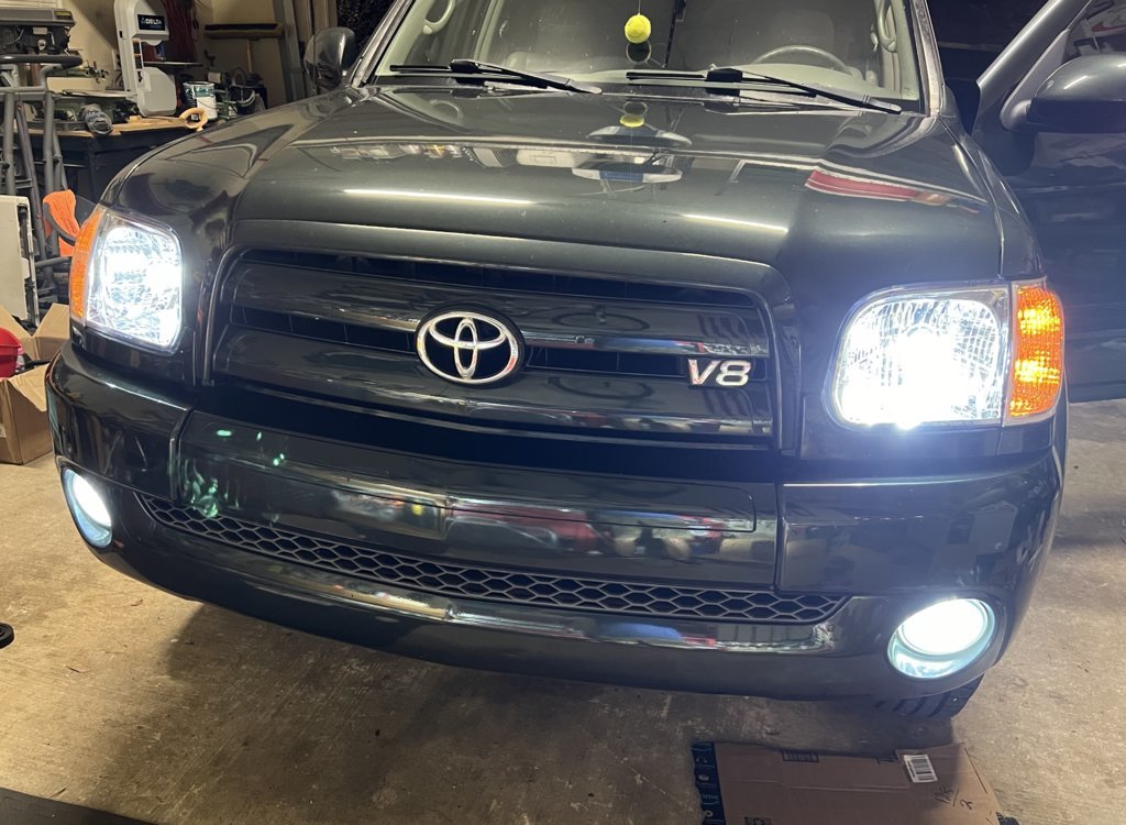

    That said I got my resistors today, installed one in the passenger side and fogs and high beams both work as intended.
    Wish I had taken this picture with the prior bulbs, and will take it again after I get the new housing with lenses you can actually see through.

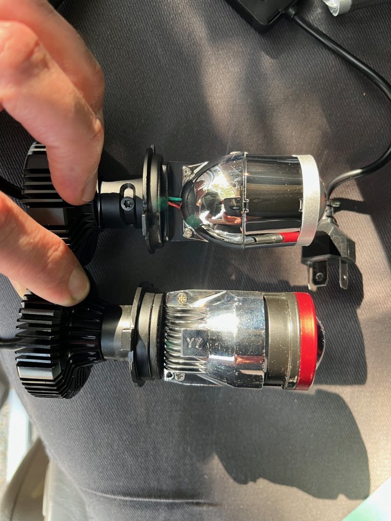

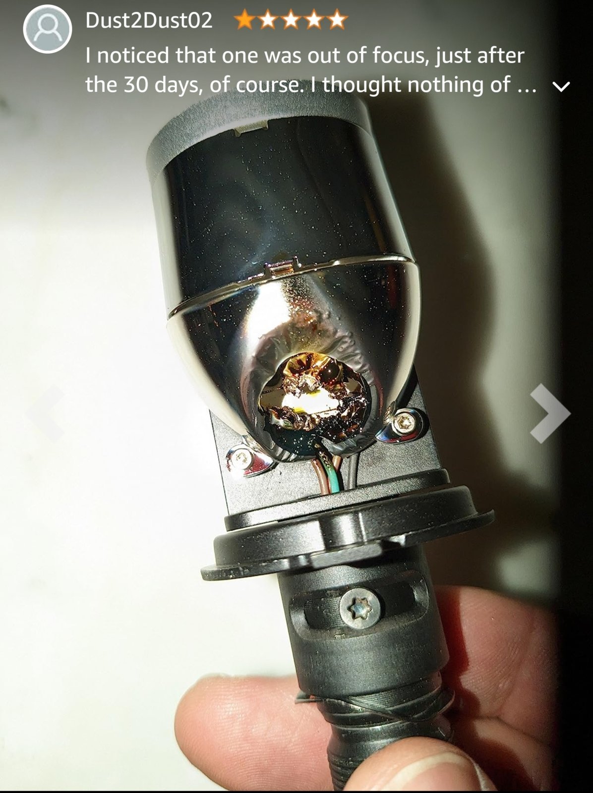

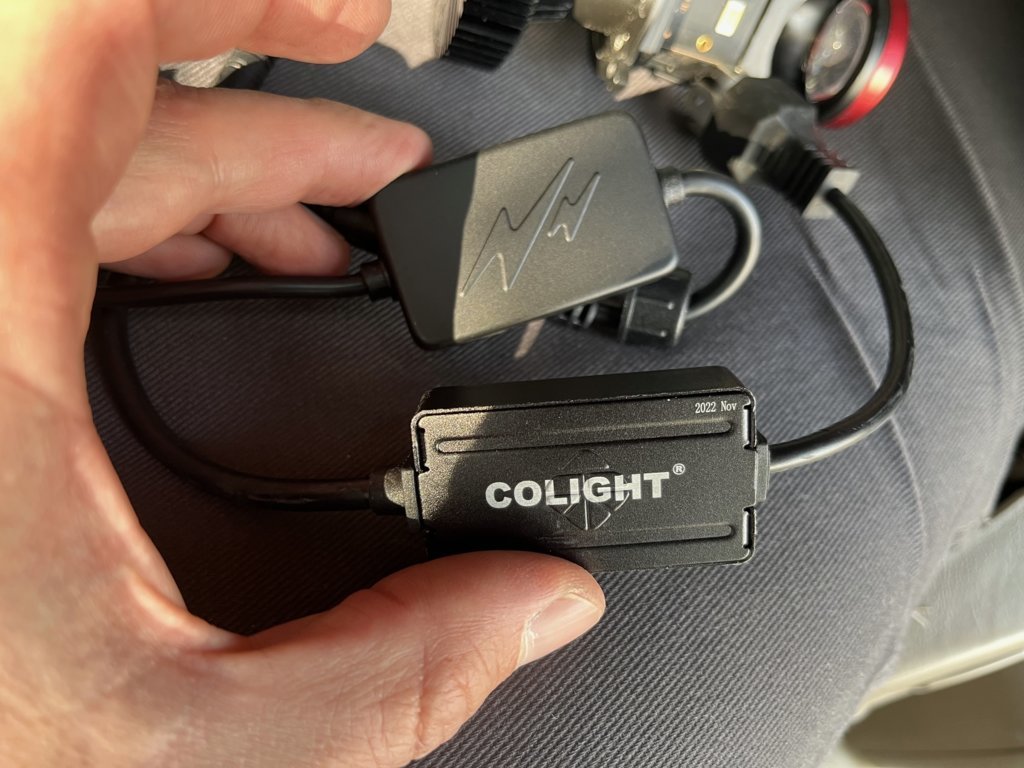

    Long ish term failure- Original purchase date 6/23.
    I have one bulb with extremely low output. Will probably wind up ordering another set because I don’t want to buy a retrofit right now.
    G_unit3000 likes this.
  9. Sep 25, 2024 at 6:58 PM
    #309
    shifty`
    shifty` Just like witches at black masses
    Jun 20, 2020
    #48239
    28,362
    ATL
    '06 AC Limited V8/4WD

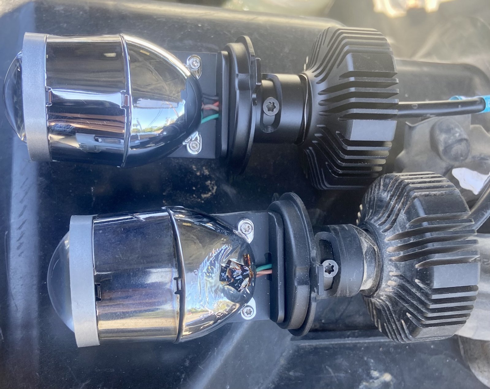

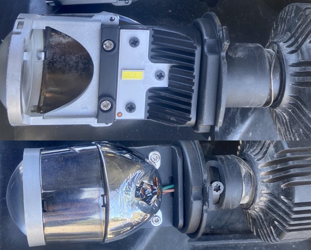

    I think you'll find it's burnt. @RUSTYNUTS went through it and started a thread on the topic here: https://www.tundras.com/threads/colight-mini-projector-lifespan.132133/
    Check the pics in reply 26 to see the low-output on one side. He got 2-3 years out of his. I kicked him some spares at-cost because the bulbs were difficult to find and he needed to get up and going.
    As for what you'll find, which is this below - that spot essentially on the other side of the LED chip ultimately fries - here's a pic of RN's bulbs, and here's an example from scAmazon's site, I've seen similar on here and on the FB groups.
    He also complained about low output on one bulb and that's how/when he found it. Clearly the design is flawed, and we're all guinea pigs. It's pretty obvious what's happening here... just not sure what causes it. Is it from running with high beams on, maybe having all three cells lit is too hot?
    Or will this eventually happen to everyone with regular usage?

    coincidentally, I've just noticed that one headlight is looking a bit dim this past weekend. Typically, I replace bulbs in pairs, but when I got that pair from you @shifty`, for whatever reason, I only replaced the failing one. Kept the other for a backup, which is coming in clutch right now.
    Really like the output and clean cutoff of these bulbs but their lifespan is disappointing.
    To be fair; I do drive it just about every night, so they likely get used more than average, yet rarely with the brights on.
    Just pull the trigger.
    Couple years ago, I went hunting for the brightest headlights I could put in stock housings. I went thru a couple sets of LED's, a couple sets of HID's, 4-5 sets of high dollar halogens, a pair of mini projectors and a pair of new housings. I don't even know what I spent, but I'd guess around $500 or so? Now I'm stuck with housings that can only be used with one type of bulb that apparently lasts about as long as a pair of socks
    Don't do that

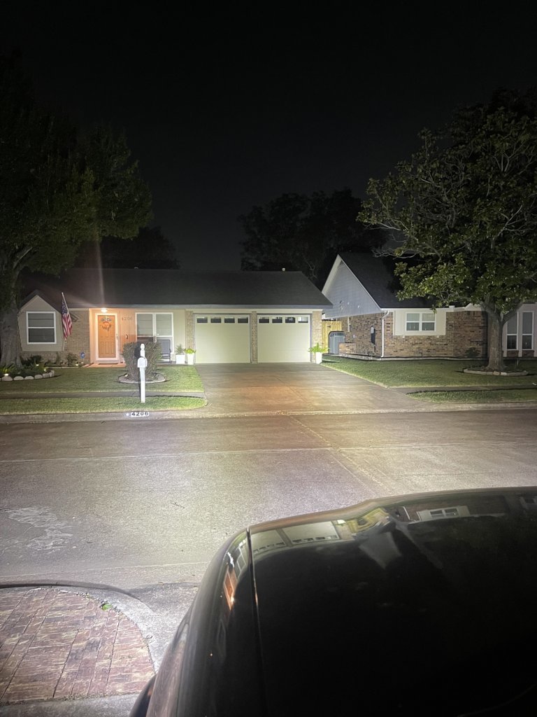

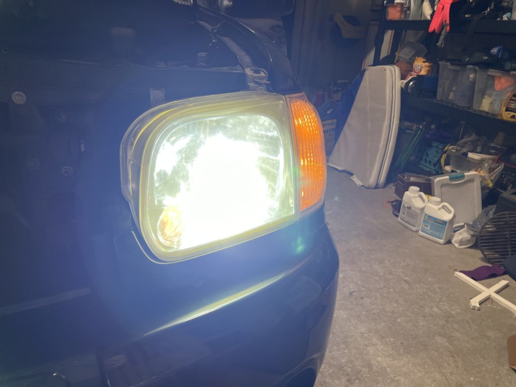

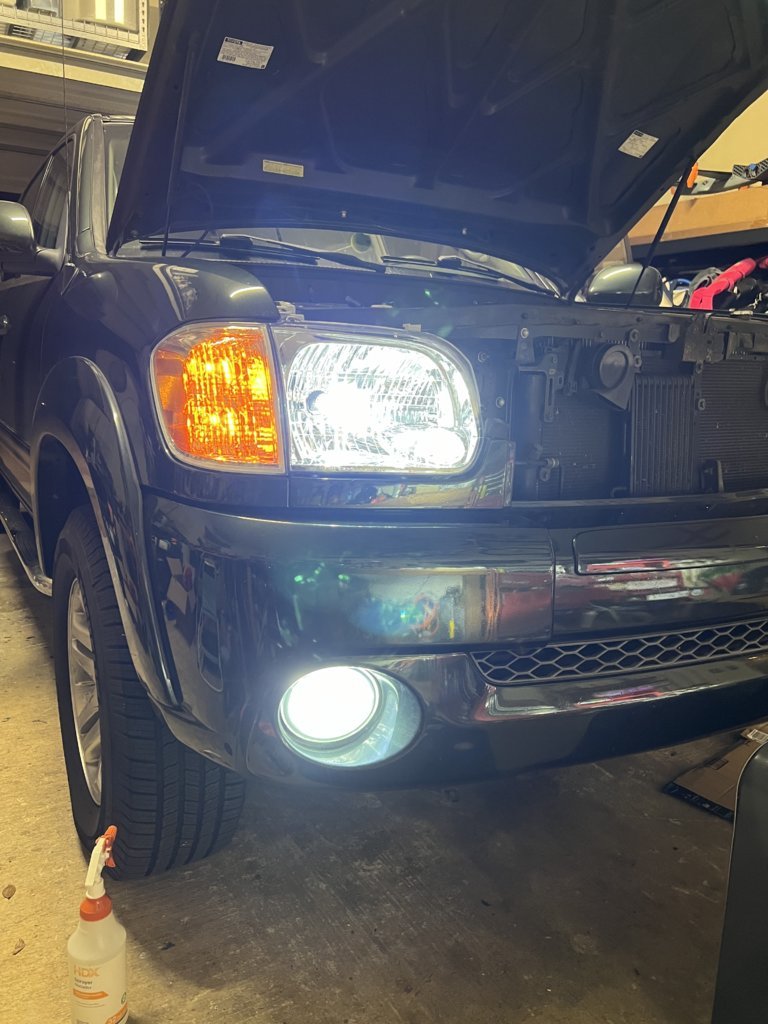

    Probably needs a final adjustment but got it below blatant blind level for a starting spot.
    The Philips 9006 fog lights weren’t a great fit in the OE fog light housings but I added an additional/thicker o-ring and it made for a snugger fit.
    Nice refresher for sure.
    Before (note: this is the C6 still but in my aged crappy busted yellowed housing):
    Now:

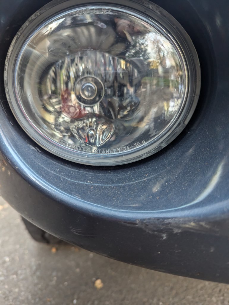

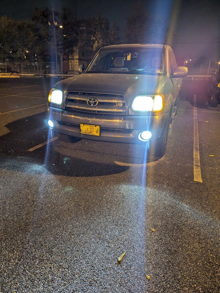

    I have installed 9006 LED Mini projectors in my foglight housings..... definite improved light throw with good cutoff. No drivers flashing me. These are essentially"driving lights" . I haven't taken good photos of the LEDs in use but it's definitely noticable. I got these off AliExpress for $20 for the pair.
    They work so well that I haven't switched over to Diode Dynamics pro foglights yetPXL_20241103_205108016.jpg PXL_20241030_000520396~2.jpg
