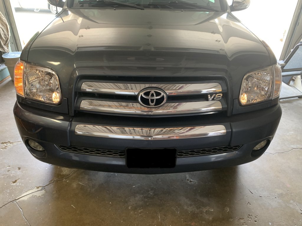

    This light mod is turning into a complete s-show . . .LOL.
    Thanks @shifty` for all the help, tips, links etc. . . . . with your help I was able to ID the flasher, remove and re-install the new one w/o breaking anything.
    Now with the new flasher installed . . . the hyperflash is all gone . . . . wait for it . . . 'But' . . . the fog lights still turn off when high beams come on.
    'And' . . . the drivers side marker/ running light does not come on at all when the lights are on. (Passenger side is fine)
    It's odd, because when I use the drivers side turn indicator, the light works fine, but the running light itself does not come on at all.
    Everything on the passenger side works as should.
    I did go to the back of the truck and check functionality of those lights, and everything seems fine back there.

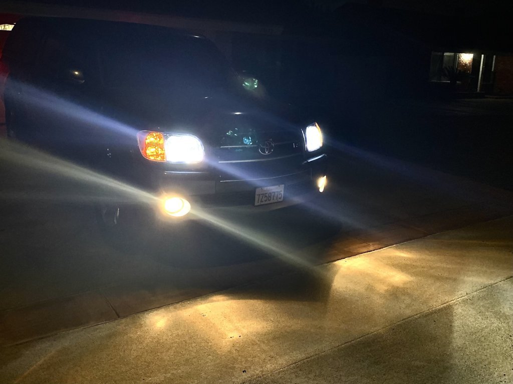

    Here is a (crappy) pic. with truck not running, key on, and with the 1st click on the light stalk engaged.
    The 2 little lights in the headlamp are on, and only the passenger side marker light on . . . (nothing on the drivers side)
    At this point, I could care less about the fog light / high beam merry-go-round . . . I'm over it.
    If I can get that drivers side marker to work, I'll be cool with it.
    I guess I'll take the lamp out again and make sure the connections & bulbs are all good, unless someone has any other ideas.
    I'll probably end up cracking the new fixture removing it , so I'm mentally prepping for that as well . . .LOL !!!!!

    I'm not up to speed on all the different electric anomalies this swap can cause, but seeing as you just replaced a lot of stuff, I'm tempted to believe the side marker light issue has nothing to do with the LED headlights. More likely a connection somewhere.
    I'm interested to find out...

    I may have put the 2 plugs in backwards on that drivers side lamp . . . . I did use some blue tape to not make that very mistake . . . but I've been known to completely ignore my attempts at being smart. . . .

    LEDs are polarity sensitive. Try flipping the bulb in the turn signal housing and see if that does the trick.
  12. Sep 15, 2024 at 9:44 PM
    #282
    HBTundra
    HBTundra New Member
    Nov 20, 2019
    #38908
    800
    2006 DC 2wd
    I didn't swap out the turn signal bulbs to LED's, (just the headlights).
    I left the bulbs in that came with the housing from Rock Auto.
    I'll pull it tomorrow and report back . . . I think it's probably just something simple, . . . or stupid that I did.
    Thanks for the reminder on the polarity.
  13. Sep 16, 2024 at 11:15 AM
    #283
    HBTundra
    HBTundra New Member
    Nov 20, 2019
    #38908
    800
    2006 DC 2wd
    Update #1714-346-2006DC-POS
    I pulled the driver side marker/ flasher lamp off and the bulbs looked fine.
    The old OEM one's I had taken off looked identical except for the the old amber paint that was crackling off.
    Somehow when fiddling around & deciding what to do next . . . I realized the new bulbs were in the socket, but not 'snapped' in place from the manufacturer . DUH.
    Voila . . . problem solved.
    So now everything works as should ... just need to adjust headlights down a little.
    I ordered that 12" screwdriver bit set mentioned earlier . . . so that'll come in handy for other things.
    Since I've got the resistor and Diode Dynamics LED flasher relay installed & everything is working, I was thinking of replacing the remaining bulbs with LED's . . . or maybe I should just quit while I'm ahead . . . LOL.
    Thanks again to everyone on here for the help. Saved me from losing my marbles even more.

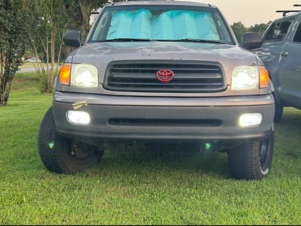

    @Auburn02
    Here's a crappy cell phone pic.
    I'll take one with my actual 'camera' and a legit lens when I get the headlights adjusted.

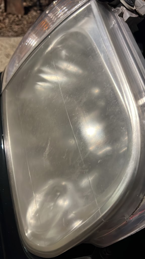

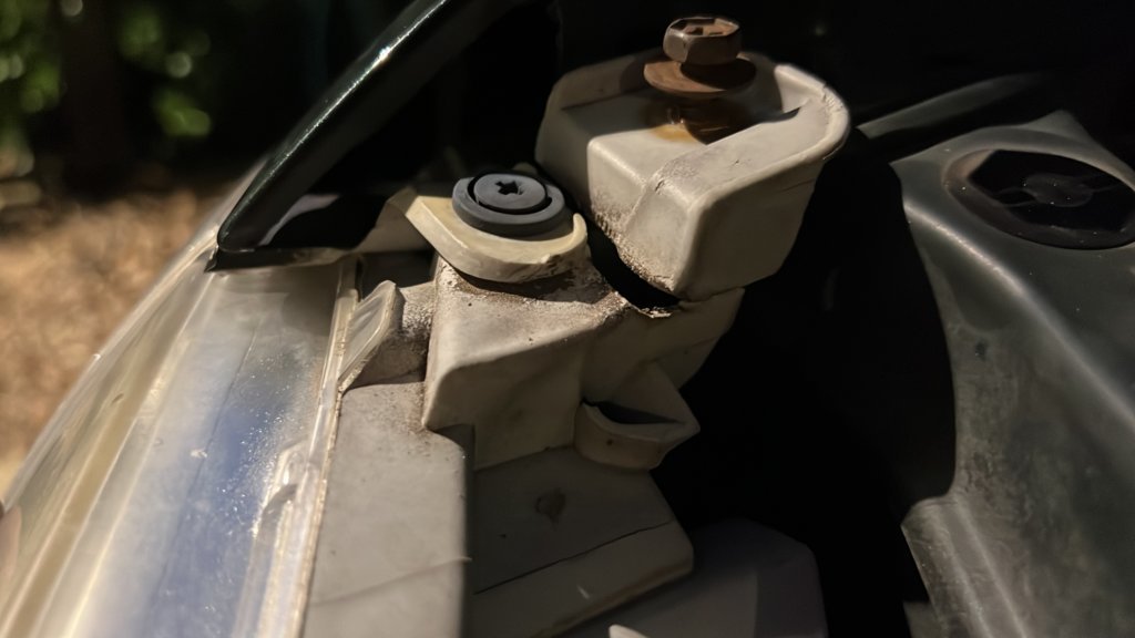

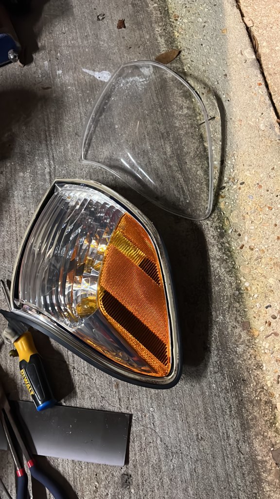

    Oh boy, my dumbass has done it now. My housings were in much worse shape than I realized, far beyond anything a polishing could fix.
    So since modifying these even if I don’t like the lights is a non-issue, I’ll have new housings ordered by bedtime. Pushed forward and installed the bulbs. First, I have much less of a visible cutoff line like other pics here but I have to assume this is because of the horrible surface on the face of the housings. You can also see the fogs still worked with only one of the LEDs but not with both installed. I had moved the truck further back for the second picture, though I can’t recall why.
    The old light output is impressive, I know!
    As expected the fog lights don’t work, resistors will be ordered tonight as well. Brights also don’t do anything, maybe catch a flicker but that’s it really. Not sure if this is also a resistor issue? Honestly I feel like when I had only the headlights plugged in the right one did change to high beam, but once I added the corner lights nothing at all on high.
    Priority for now will be resistors and housings. I will try the resistor first to ensure that fixes the fogs and hopefully the brights, and then if I’m happy I’ll go ahead and modify the new housings.
    Oh, one of my dust protectors is also completely separated so I’ll replace those too, and the factory plugs don’t look great but not sure if this is bad enough to be concerned or not.
    Final question, do you guys just let all the new wiring dangle behind the housings or try and secure it with zip ties to minimize anything bouncing and banging around?

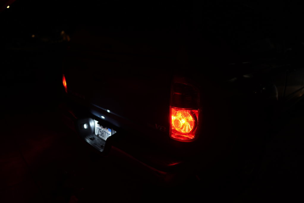

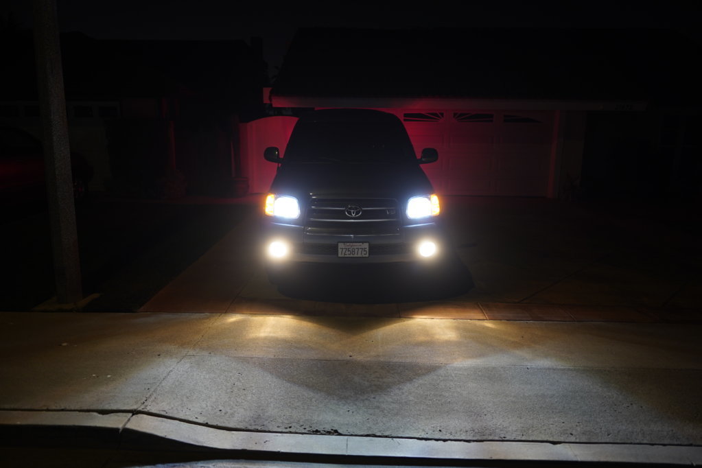

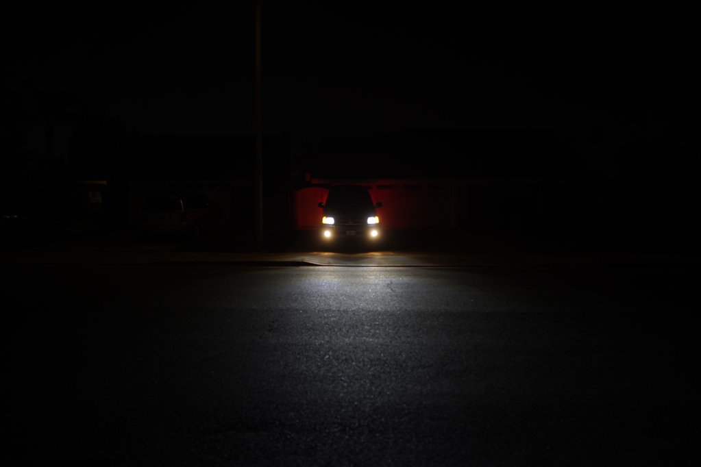

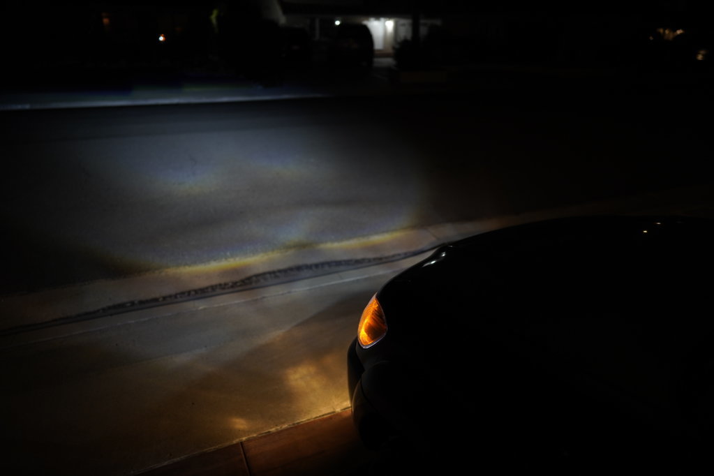

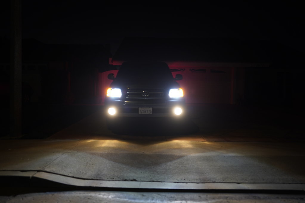

    Ok , these are straight out of the camera (Sony a7iii w/ 24mm Sony G-Master f1.4 lens)
    1/80 shutter - F1.4 aperture - ISO 320 - I tried to get the settings as close to what I was seeing in real world.
    No photo edit or enhancements at all.
    Truck is facing down the driveway.
    Pics. don't really show the blue/white of the headlights . . . it's not too offensive, but it's more significant than what you see here.
    i went with the 320 lumen tail lights . . . they're brighter than stock, but not overwhelming.
    Glad I didn't go with the 500 lumens.
    Overall I'm very happy with the upgrade. It's a city dweller truck, so there wasn't a 'need' for me to go any brighter like some of you that live more rural, or venture into the sticks.
    This all began as a way to hopefully avoid hitting one of the many grommets flying around on e-scooters & e-bikes at night that infiltrate the streets.

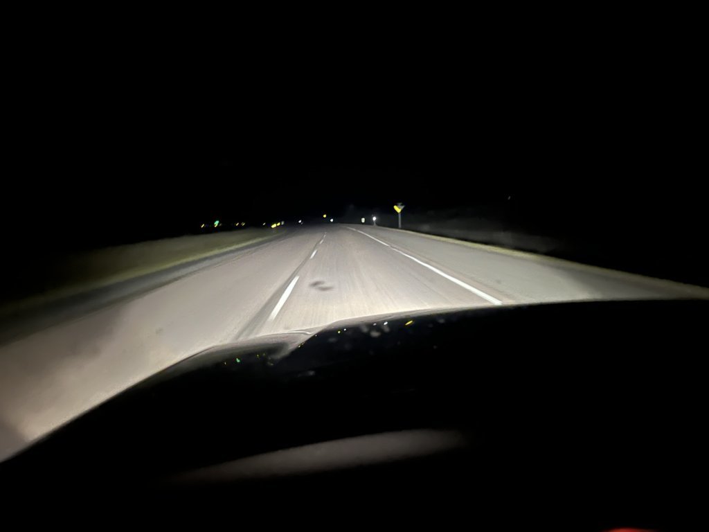

    Can't remember if it was this thread or another where someone complained about the garage/wall shots of headlights, and how they don't tell us anything about the actual light output while driving. It's true, but I think most of us don't want to take photos while driving...
    I took a chance earlier this week. Did a very rare 4-hour drive, all in the dark, and had the road to myself for a while so I took a couple photos. They aren't great, but I was focusing on driving, not the camera. I know there a ways to mount a camera and take better, safer photos, but I have no need to take pictures while I'm driving, typically.
    First is low beam, second high.
