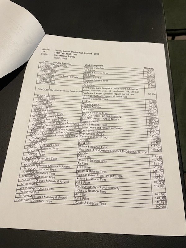

    Would like to use this thread for something like it's original purpose. I'm looking at this truck https://dallas.craigslist.org/ndf/cto/d/dallas-2006-toyota-tundra-limited-4wd/7867913782.html and the owner has sent me the service records, at least an abbreviated list of the alleged service records. The maintenance has been fairly regular but there are several things that are certainly not current. I'm going to make a list of all the things I think it needs to have done immediately, or within the next 10-15k miles (which I'm considering an immediate need), and I'm hoping those of you who are more experienced will add anything I've forgotten and correct what I've got wrong. Also, if you care to provide a rough estimate of cost, that too would be appreciated. I can handle some of the lighter work myself but for now, assume it's all going to be shop work. I'll take the completed list to my local Toyota wizard at Safari Classics and get his opinion as well.
    - oil, oil filter, cabin air filter
    - timing belt, water pump, fan clutch, radiator
    - all hoses, brake line, fuel line, fuel filter
    - spark plugs, coil packs, valve cover gasket, pcv valve
    - all fluids, brake, transfer, diff, etc.
    - front shocks and struts, rear shocks
    - upper control arms
    - calipers, brakes
    - tires
    - rear bumper (back to white)

    There is no cabin air filter, but there's an engine air filter under the hood.
    Any claim of needing to do lines (brake, fuel, vacuum) is completely outlandish and over the top, as is, I think, the fan clutch. None of those things are known to typically fail with such low miles, and I think vacuum could be done, but it's personal preference, or if evidence of dry rot.
    Same with coil packs: If no misfires present, you'd be (IMHO) wasting time and money.
    Same with shocks/struts.
    Same with upper control arms and calipers.
    The list looks, frankly, very nuts, like it's coming from someone who has outlandish expectations or doesn't understand normal maintenance on vehicles. Unless you're literally just throwing any possible maintenance item out there, in which case you forgot the steering rack and lines, which could be leaking, the seats which may have rips, the dash which could have scratches in it and should be fully replaced, and ... (you see where I'm going with this?)
    Clearly that truck was, potentially from the day of purchase, here in Atlanta area, where it for quite a number of years. At least through the end of 2024, so I'm assuming the frame should be clean, but it may be worth checking.
    But that said ... if there's no evidence or proof the timing belt/tensioner/pulleys/water pump/t-stat/radiator has been done within the last 10 years or 100k miles, then it's way overdue at this point. And yes, I think it's fair to ask for $1,500-2,000 off for that, but here's the thing: If that truck is sitting at a dealer, they're liable to tell you to go suck eggs, OR they'll potentially swap out the belt only with whatever brand they deem fit and call it a day.

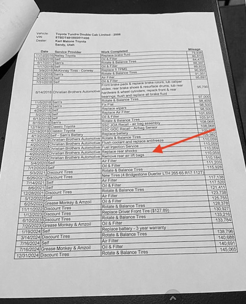

    Pilgram,
    Was the truck used to tow or haul heavy loads?
    Screenshot 2025-07-29 at 12.37.07 PM.jpg Pilgrim,

    That's a good catch and a good inference. Might also explain the replaced rear bumper. I will see what I can find out.

    Everything else being equal, I'm cautious of used vehicles that have been used for towing.
    FYI... I've got a 4.7. Changed plugs for the first time at 235k miles. Engine still operating perfectly but the valve covers were leaking so it was an opportune time to change plugs. The coil packs have never been replaced. Nearly 300k miles.
    My 2 pennies... If you're considering a 20-year old vehicle there will be plenty of things needing attention. Don't be on a hurry to fix what ain't broke.

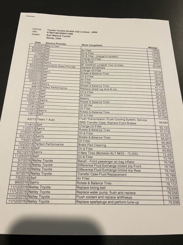

    This is it. Original owner recorded doing much of the regular maintenance himself, second owner did some himself but relied heavily on Sam's as well.

    That white limited looks good
    The list you provided was nonsense as others have said.
    At 150,000 and 9 years, and 70,000 on the timing belt, you have a LOT of time left on it i bet. I bet the belt still looks practically new with no cracks. Since it was done at a toyota dealer you KNOW its the good one. I would pull the 5-6 bolts on the drivers side cover and pull it back and look but i bet that belt still looks great and isnt something you gotta worry about on day 1.
    The spark plugs are well overlooked things and worn out spark plugs eats up coil packs. The spark plugs were done at 80k, i would recommend changing them with OEM Toyota spark plugs. When were the lower ball joints done, i know it said in the listing it had new OEM joints but it doesnt say WHEN. The timing belt, and ball joints are the only real things that go bad on these vehicles. I would replace the fan clutch when you replace the timing belt because its relatively cheap and you gotta pull it off, but honestly if it were me, i wouldnt do it till 200k miles. I would change the spark plugs, put some sea foam in everything, check the brakes, grease the driveline, and put it in the road.
  27. Jul 29, 2025 at 3:46 PM
