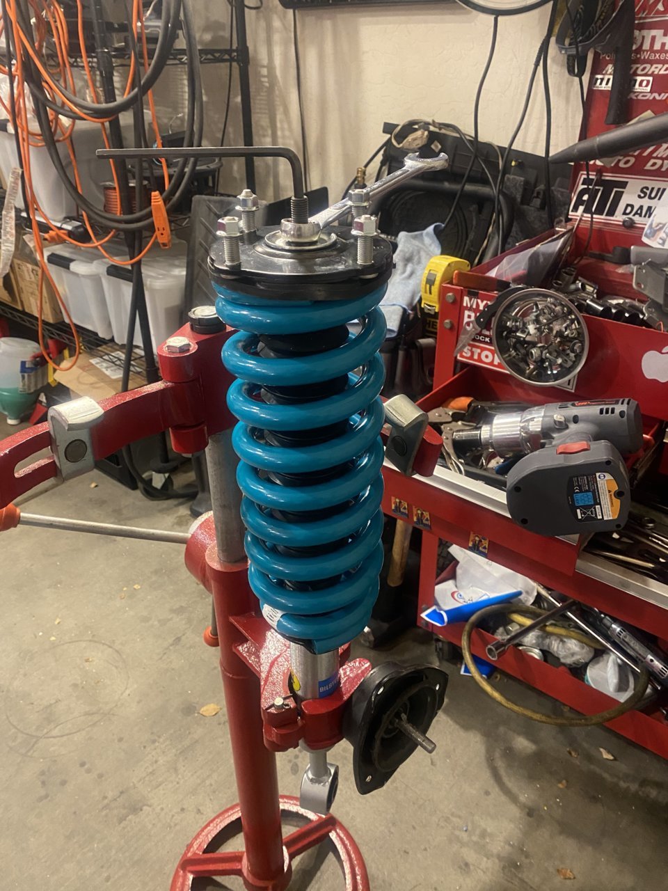

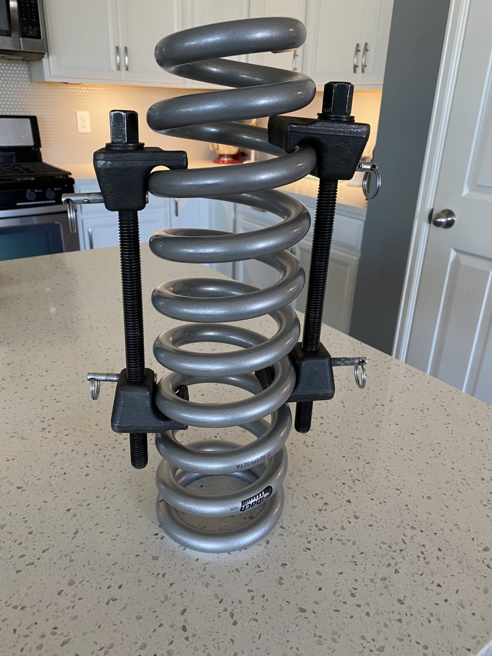

    Some small locally indie shops can be cool about it. Chains or 4x4 specific shops will charge you a lot. When i was assembling my OME 612's i couldn't do it via the no-compressor method because the spring rate was too stiff. I brought it to a local shop and the guy did it for free in 15 minutes. I ended up buying lunch for his whole crew because they were so nice.
    Do not do it yourself with anything other than a wall/floor mounted spring compressor. Its different with a small spring for a commuter car. Truck and especially high spring rate off road suspensions have a LOT of force behind them under compression. I know people discussed ER visits for things like fractures and lacerations from them, but people die from springs flying or compressors failing and pieces turning into projectiles. I DIY just about everything, but some things are just not worth the risk.

    I did this with roughly the same compressors, just went slow and little each side at a time. I will tell you that getting the top hats and the shock to line up properly are a fricken pain but doable. Arrow out, lol
    Oh and you have to pull the big bolt completely out to get the "clamps" out of the spring when its finally assembled. Forgot about that fun fact.
