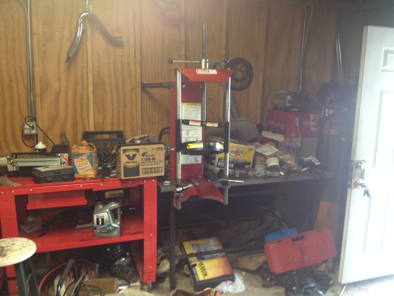

    If your in chicago come thru I have a professional spring compressor in my garage do it for free

    I think I paid $50 to have mine assembled while I waited. There are two things that would have me considering the no compressor method or the big ass spring compressor rental - 1, I like doing things myself just to say I’ve done it, and 2, coordinating a trip to the shop while they have time to do it, and driving around 20 miles each way, would be difficult. Not sure what OP’s exact situation is though. We’ll see how brave I’m feeling next time I need to take my coilovers apart…
