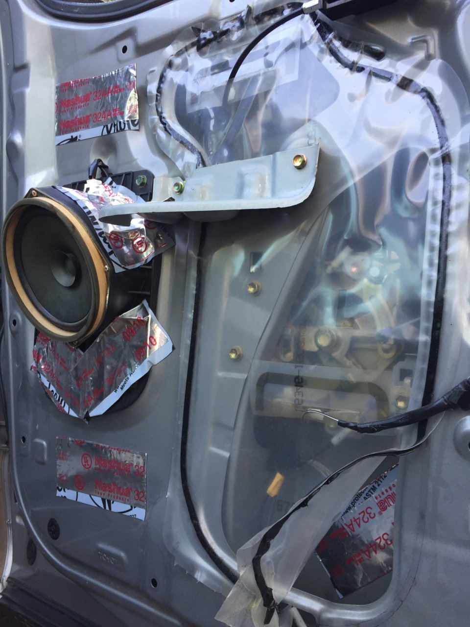

    Pictured is a roll of HVAC Foil Tape and a separate roll of Butyl Rubber Door and Window Tape. Both from big box.
    Looks like it should do the trick compared with some of the online ‘Sound Control Mats’ out there. Its free and available and will be installed around speakers for better sound.
    Whatcha think?
    OBXTundra and Mountun Goat like this.

    I was reading your sound project yesterday and it renewed some interest I had in doing the same thing a few years back but never did. This pictured material is thick butyl rubber and doesn’t stink. The tape is thick aluminum. Both hold up to heat pretty well.
    Thought I’d give it a go on the back doors first as they are easier to remove the paneling and put back. Not interested in doing the entire cabin like you and others have done as its too much work for my taste! Plus, it seems small strategic locations are the key. Just looking to experiment with free materials that look to be the same as these ‘Sound Mats’ that cost big$.
    Next step is calling in a favor for some free mass loaded vinyl rolls from someone that holding. Been waiting for the right timing.

    Watched a vid from that link you posted. This stuff I have is the same butyl thickness and weight. The foil looks thicker on the vid than the HVAC tape I have, but not by much. I can always double up on it if need be.
    My back doors will be easy. Same with the back underseat storage area and front center console. Inside the front dash is easy as well. As far as the front doors, may just do the inside of the door pocket wells down low. Don’t want to mess with taking those door panels apart. Not messing with removing carpet/cab skin either. Keeping it simple. 2 hours max.
    Some of these guys spent 40 hours on theirs. Looks like maybe you did on yours too. I’d go nuts!

    Installed Homemade Sound Enhancing Butyl Rubber with Foil strips on the back doors. Also added some packing foam blocks from a delivery box inside what little cavity space is inside these doors. Took about an hour. The stereo sounds so much better now! Clearer and deeper sounds.
    Maybe a little quieter as far as road noise. Just a little. The music, though, is amazingly better. I can’t wait to do the front doors.
    Probably will not do mass loaded vinyl as it adds weight and there really isn’t much room in these doors do add it. Happy with the results so far. Front doors will take some time to do in the future. Here are the materials I used.
    Used some door and window peel and stick butyl rubber and taped some HVAC heavy foil on top of it. Cut them into strips and then into small manageable pieces for install. Tip: If its cold out use a blow dryer to heat the rubber and stuff them into your pocket to keep warm as you do the install. Helps with the sticky factor.

    Hell yeah man that looks great!! Glad to hear the music sounds better too. Amazing what a difference just killing a few vibes and rattles can make.

    Yep. These 1st Gens do have many rattles compared to the following Gens. Two buddys have the later models and they complain about the noises.
    I think the rubber focuses the music sound better. I’ll report back on sound control from road noise as its driven more. The stereo was an instant improvement.

    Update: Stereo sounds amazingly clearer. Deeper basses and truer notes. I gotta do the front doors now. Can only imaging the improvement.
    As far as road noise, its a little quieter.
    The main improvement is huge on the stereo sound side though.
