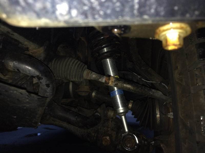

    The differential shouldn't have any effect on your alignment. You have 5 inches greater than stock height right? Not just 5 inches from tire to fender. 4 is the max for the cv joints. Can you get a picture of them?

    Here is a pic of what the CV angle is now.

    I also didnt install the diff drop yet. Doing that tonight
