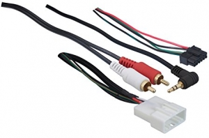

    Hello all
    I am running into a issue with my Alpine. I just recently installed the unit after it sitting in my room for the last 2 years, installation went fine with the Maestro and the radio was working fine for the last month and half.
    However in the last week, the radio doesn't turn on after it sits overnight, I am able to get it back on by moving the screen either up or down and it works as usual throughout the day. The radio comes on after it sitting for hours during my work but for some reason, it doesn't turn back on after sitting overnight.
    I was thinking of the issue being a loose connection but it wouldn't explain the radio working after sitting for hours during my work and it able to power on on the drive home.
    Not sure if if my Maestro or Alpine is the culprit or something else.

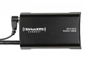

    If anyone ended up using the factory GPS connector and still has the alpine Antenna, I will gladly buy it from you. I have no idea what I did with mine and my OEM antenna is not working it seems.
  14. May 12, 2025 at 12:39 PM
    #1814
    AZBoatHauler
    Aug 13, 2019
    #34576
    9,388
    So.Arizona
    You might have two built in - you can try switching them. I had one for Nav and another for Sat radio - only one worked with the Alpine.
  15. May 12, 2025 at 12:43 PM
    #1815
    GWill
    GWill gods gift to the internet
    Jan 12, 2021
    #57520
    466
    Willis
    Don’t know what you’re talking about
    2020 MGM TRD Pro
    Its a black and a white connector correct? The black im pretty sure is SAT, I have SXM popped into that one, and the white one is the OEM GPS i have connected. Unless youre thinking theres a third?

    I did find that my radio was not fully seated in the metra kit. Apparently when I was moving the screen up or down, I was actually moving the radio out of the cage and possibly losing connection periodically. I really don't like the plastic cage as it's not the most sturdy. I was able to push it all the way in so I am seeing if that fixes the issue.
