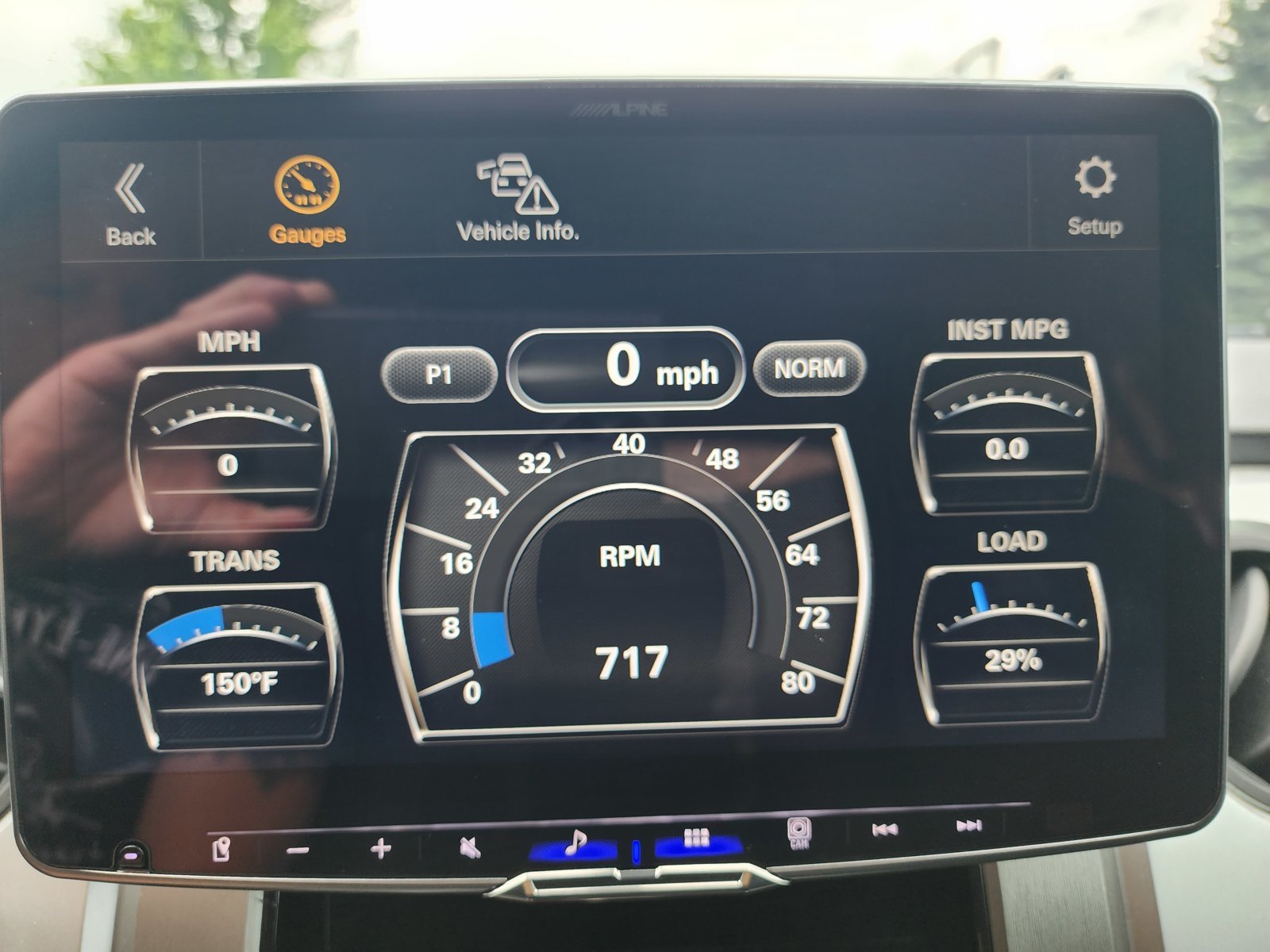

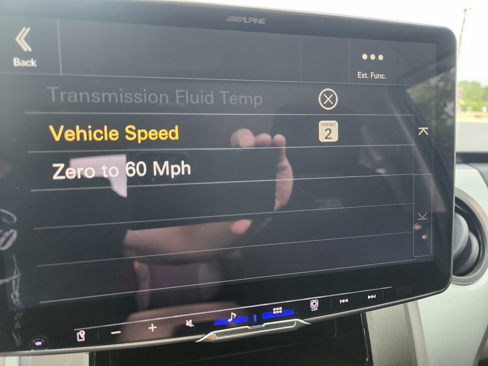

    Anyone know why my Trans temp is grayed out? Would love to have that feature for towing the camper.

    Is your truck actually on and running? Do that, make sure your OBD setting is on or enabled on demand, and validate PIDs.

    I don't have this particular HU but I went to Car Features on my Pioneer then pressed the little cog icon (settings) and saw Validate PIDs

    I forgot exactly how it's worded on the HU, but there is a selection to confirm or validate communication, takes a minute or 2 then with the truck running I was able to select the trans temp.

    That did the trick. You guys are the best!!

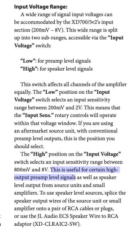

    "High" is for speaker level inputs, as in if you were feeding the amp signal from the wiring that would normally go to the speakers from either an upstream amp or the head unit. If you're using RCA outputs from the HU, select "Low" on the input selector.

    I’ve never heard RCAs referred to as anything other than “low level” inputs. All the way up to 5 volts. As @TRDFerguson pointed out - high level inputs refer to using speaker outputs from a HU.

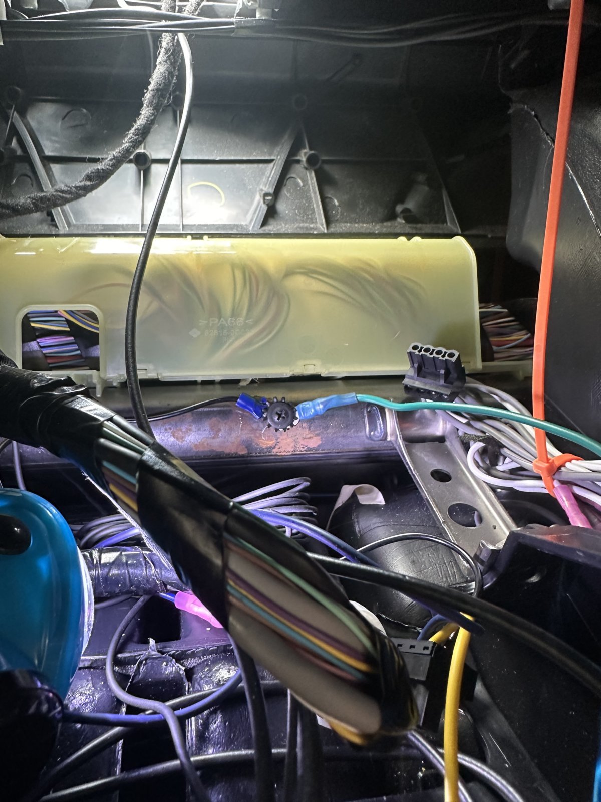

    2021 Silver 1794 Crewmax 4X4
    Guys, I'm having trouble with the stock backup camera being intermittent. I found a youtube video about the F 511 needing a second ground for the reverse camera. I pinched a ground wire in the RCA connector and grounded it to a metal bar in the back of the stereo "pocket" in the dash and it seemed to work but now it is flickering and going black again. When it acts up it does it when putting the truck in reverse and when you use the camera button. I bought the unit through Trailgrid pro and have been working with them for several months on this. They are now saying they reached out to Alpine about it and Alpine says they have not heard of this issue:confused:. They are suggesting I call Alpine. Have any of you had this problem and found a solve for it?
    bulldog93 likes this.

    So I have that issue as well with the trans temp greyed out. Just a thought here but since the trans cooler was eliminated after 2016 is there even a temp sensor in the trans at all?? Has anyone with a post 2016 been able to pull up trans temp with a ODB2 device?

    I have it showing on my 2021
    Been towing a bit this week so I’ve been watching it.
