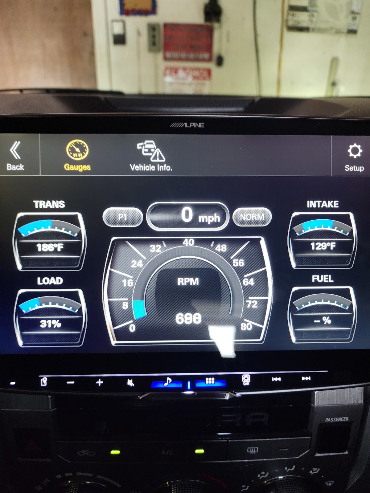

    Nah that can't be. Someone else was trying to get trans temps to come up and they eventually figured it out. Update PIDs....?

    Yeah, that sucks man. It definitely works in my 2020. After I installed the trans cooler, stays just under 190 all the time according to the Alpine.

    I've screwed with it and yet to find a way. Then again, I've never claimed to be all that smart

    There are a few OBD settings in the maestro menu on the Alpine. I think I set mine to “Always On” or “Enable On-Demand” and it picks it up better after a restart. There’s also a Validate PIDs option that will rescan your available options and mine always works after that.

    Do you mean the maestro menu when you flash it, or accessible through the HU?

    Through the HU. Now getting to the right page… that’s the fun part. I can never remember how to find it.

    Got it done, it's under maestro settings then gauges.

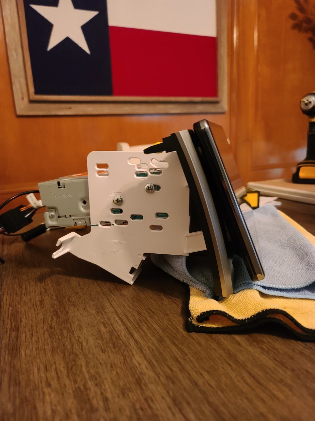

    These stereos don’t allow for a flush mount - because the screen floats from the innards and allows for a little tilt. The Kenwood sticks out an inch or so but it doesn’t bother me at all and doesn’t look out of place. So much better than what came with it.
