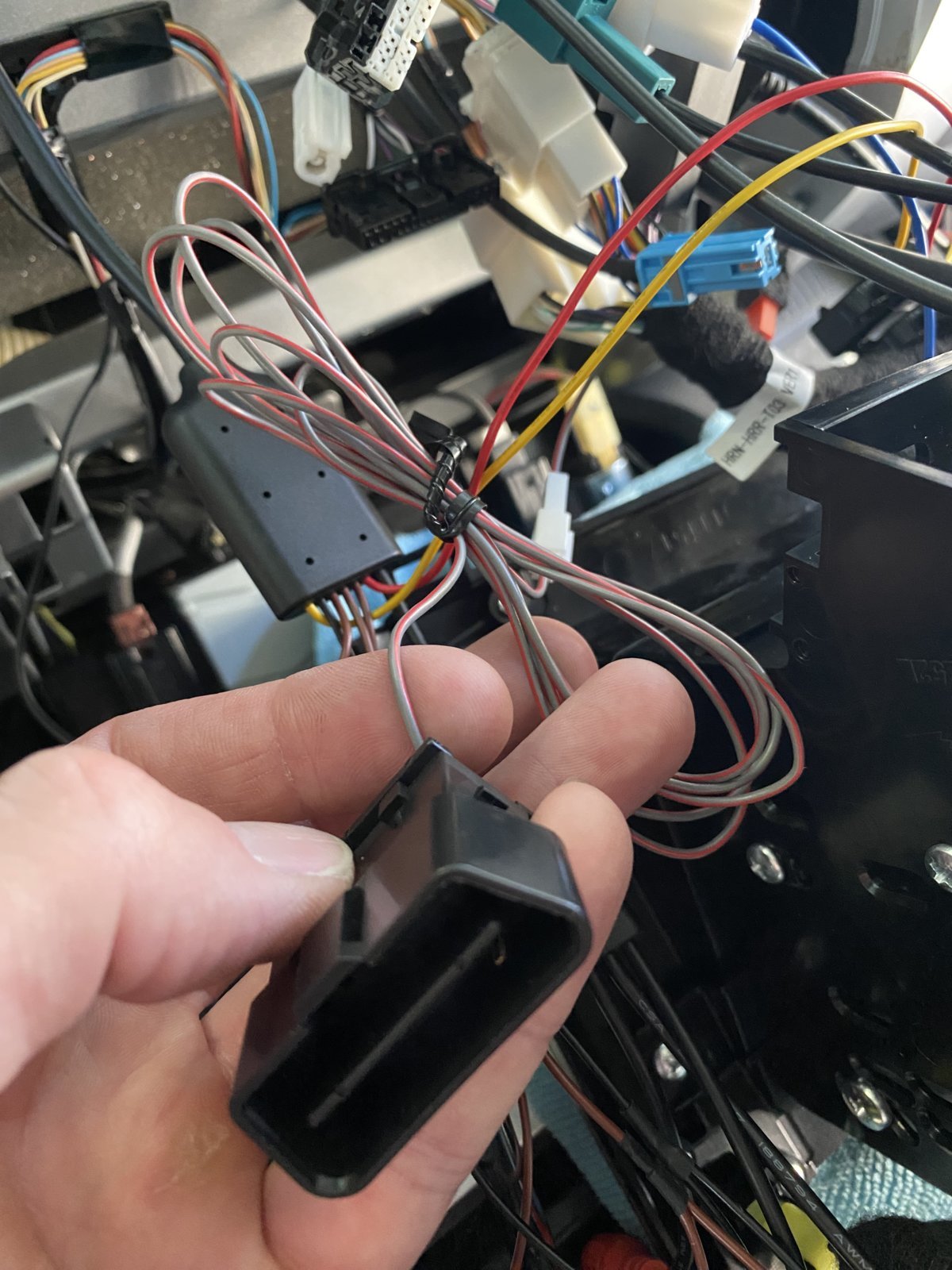

    I got it all installed. I have a 2020 Limited with JBL powered. Ordered through TrailGridPro.
    I have no sound.
    Steering controls and vehicle diagnostics are working but no sound at all.
    Anyone know what this harness with 1 grey/red wire is? I didn’t see this anywhere in their instruction video. It doesn’t seem to fit anything.

    Looks like an engine/trans monitoring wire.

    oh so this must plug into the OBD?

    Correct

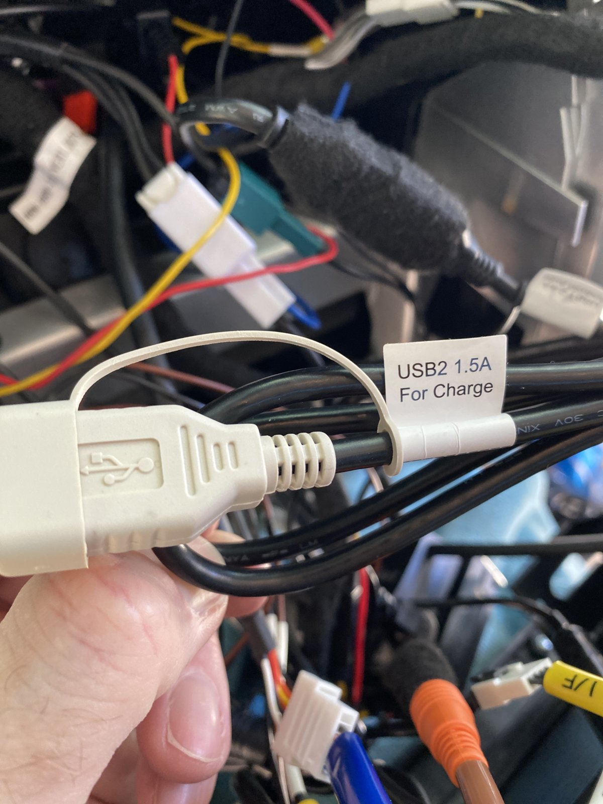

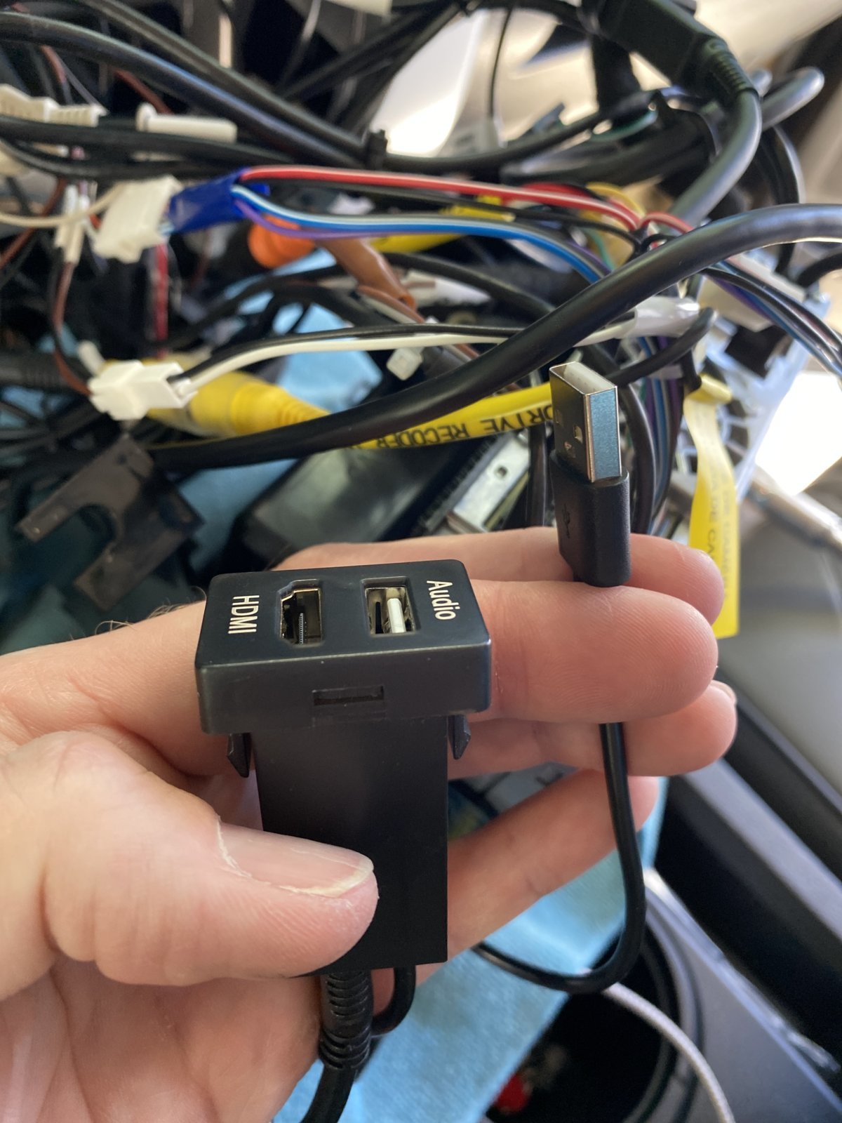

    Not yet, I connected the OBD, but I’m having a hard time figuring out where to splice in the TR1 parking brake bypass.
    Also trying to figure out where to plug in the USB for “audio” on this HDMI/Audio unit I ordered with it. I have the HDMI portion going to “HDMI In” on the head unit but don’t know where to plug in the USB.

    Does this only charge or can it also transfer data/audio?

    They included the direct OSB so I could get transmission temp. I guess it doesn’t have that going through the Maestro?
    Are you saying I will just need to disconnect the OBD plug by the brake pedal or disconnect the entire head unit to get smogged?

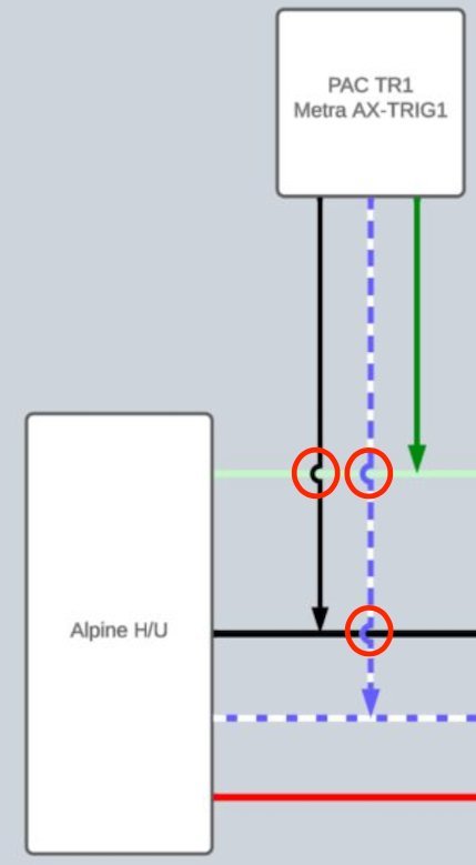

    I installed the Alpine in a 4runner and a Kenwood in the Tundra - I did copy some notes from people about the brake wire bypass for the Alpine. Hopefully this helps...
    Is the "parking brake wire" and the "speed sensor wire" (how it's labeled from Alpine) a referenced to the same thing? Both are green/white.
    • No. the Drk Grn w/ wht stripe coming out of the Maestro PnP harness is your speed sensor output from the vehicle this needs to be connected to the drk grn w/ wht stripe that is labeled "speed sensor" wire. It is seperated because the main harness from alpine does not have the pinout for speed sensing as that is part of the video* harness.
    S1) Finally, it looks like TRIG1 has four wires, but I only see three represented in the wiring diagram
    • Correct, the 4th is utilized for legacy Alpine wires where it required a 12+ foot brake input signal as part of the bypass sequence. It is not needed in this application and should be insulated to prevent a systemic short.
    Q2) So, green gets connected to the Alpine Speed Sensor/parking brake cable from the HU?
    • As covered in Q1, the Alpine's Speed Sensor wire is to be connected to the breakout wire of the Maestro PnP harness.
    Q3) Blue gets connected to both the same green wire and the ground & the blue/white on the ID Adapter harness?
    • No, all wires are 1:1 connections. The incorrectly identified connection points are circled in red as they are line jumps, do not make connections at these junctions.
    • With that said, the Trig1 Module Blu/Wht or sometimes Blu must be tapped into the blu/wht wire of the main Alpine Harness.
    Q4) Black gets connected to both the green wire and the ground?
    • With that said, the Trig1 Blk must be tapped into the Blk wire of the main Alpine Harness, or applicable ground source.
    Regarding the Drk Grn of the Trig1 unit, you will need to locate the Lt Grn wire of the Maestro Alpine Adapter and cut the wire. You well then connect the h/u side of the Lt Grn wire to the Grn of the Trig1 module. You will then insulate the other side of the Lt Grn wire that you just cut.
    Let us know if that helps provide some additional guidance.
    -JS
