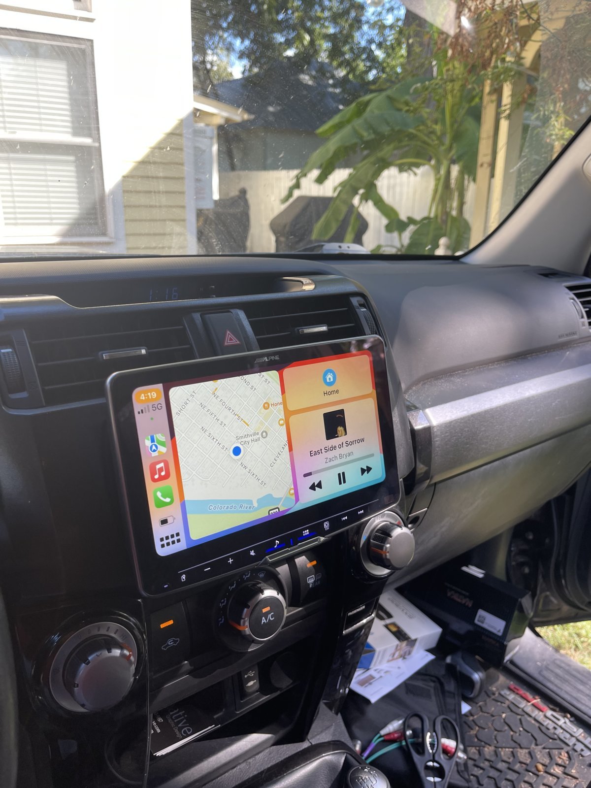

    I finally got my wife's installed today. Covers a little bit of the bottom of the vents but not enough to cause any airflow issues. Would have been done about 4 hours earlier but I didn't do the whole "dig into the settings and turn on the backup camera" even though the fucker said on another screen there were no cameras connected.

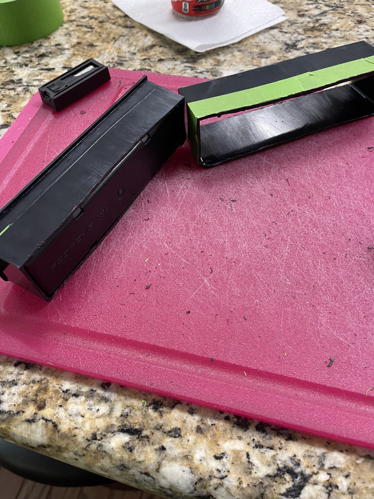

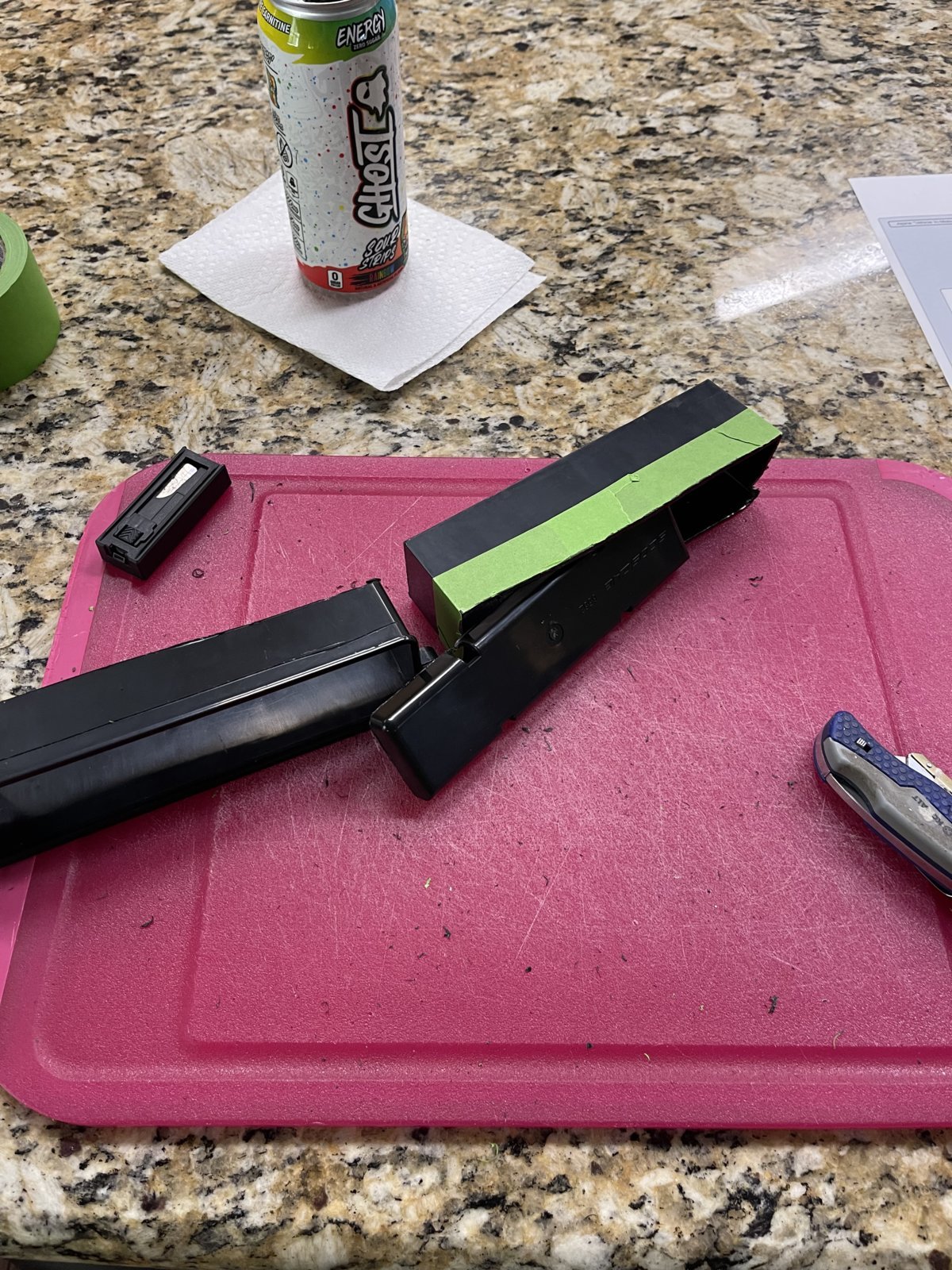

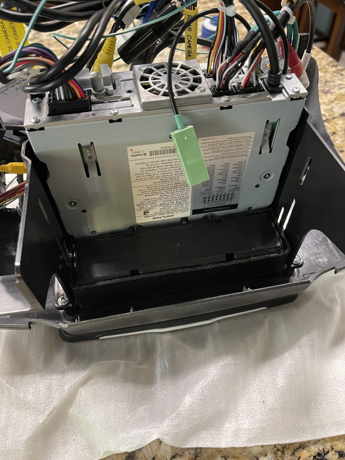

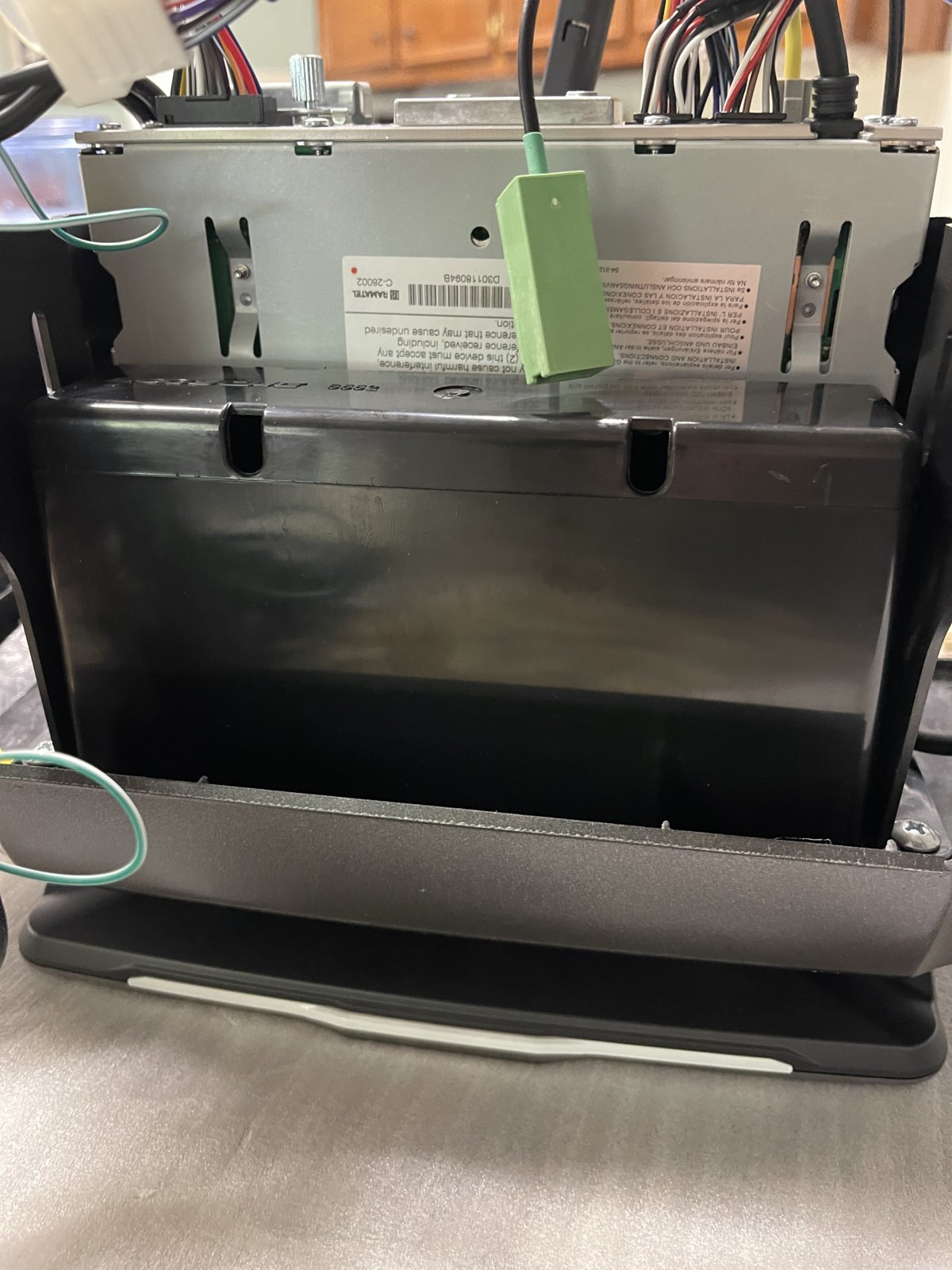

    I put it on the very bottom of the Alpine bracket and put the radio at the top of the trim with the pocket underneath. I also ended up cutting the backend off of the pocket and then cut a couple of inches off, then pushing the backend in and gluing it. I taped the parking brake bypass to it along with the Maestro. I may open it back up and make one of the holes big enough on the pocket to push the USB C dongle that came with the RR2 through it so if I have an issue with bluetooth flashing, I can just plug in through the pocket.
    I was also able to stick the Sirius XM behind the trim and above the hazard switch. Not a whole lot of room to work with.

    Looks great!

    That looks perfect! Great job
