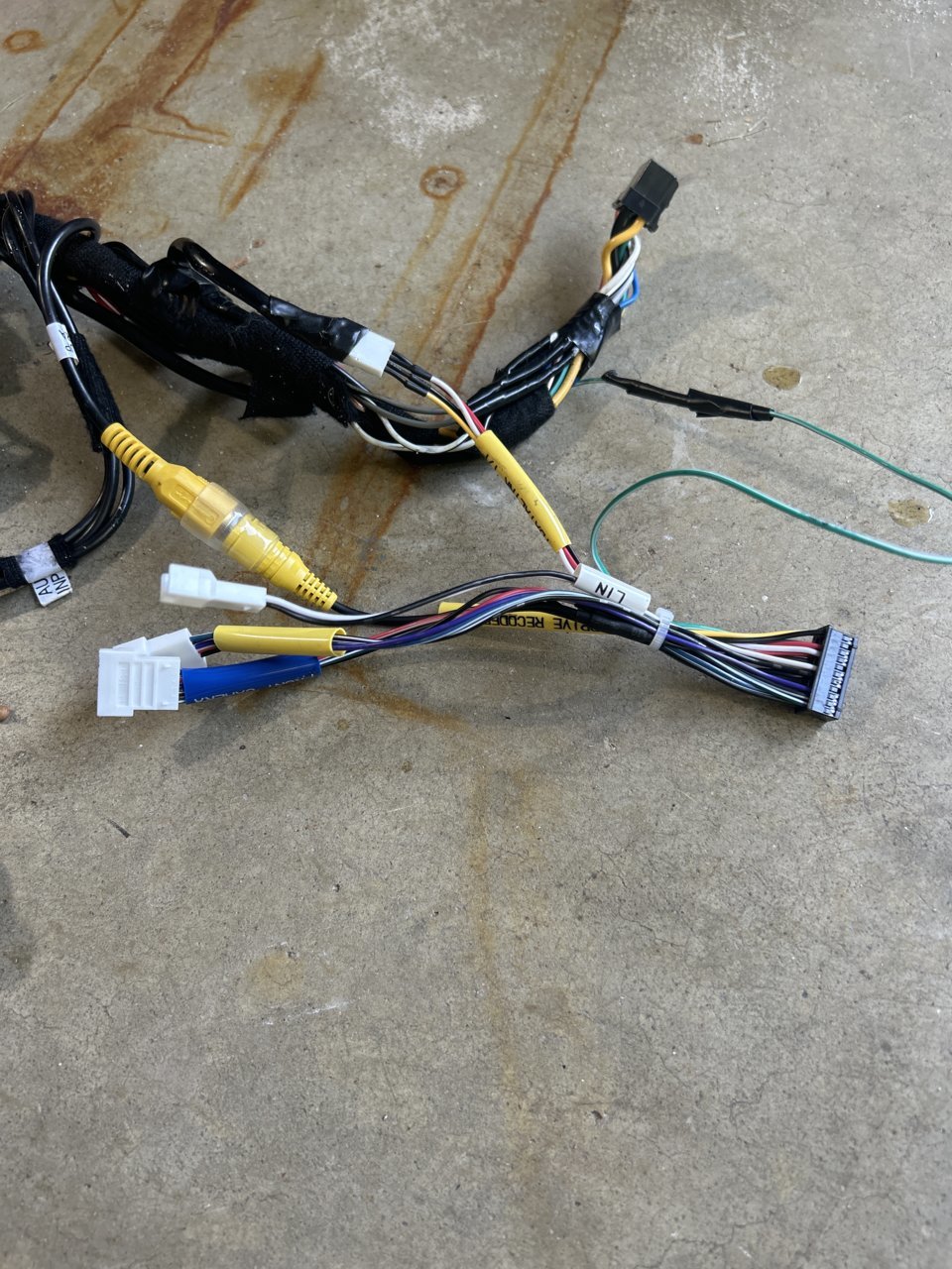

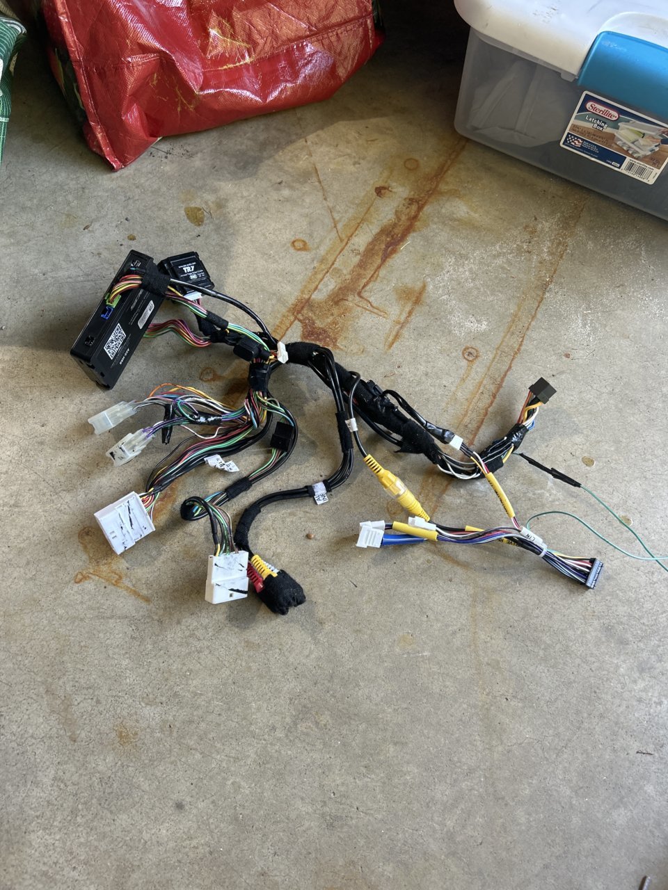

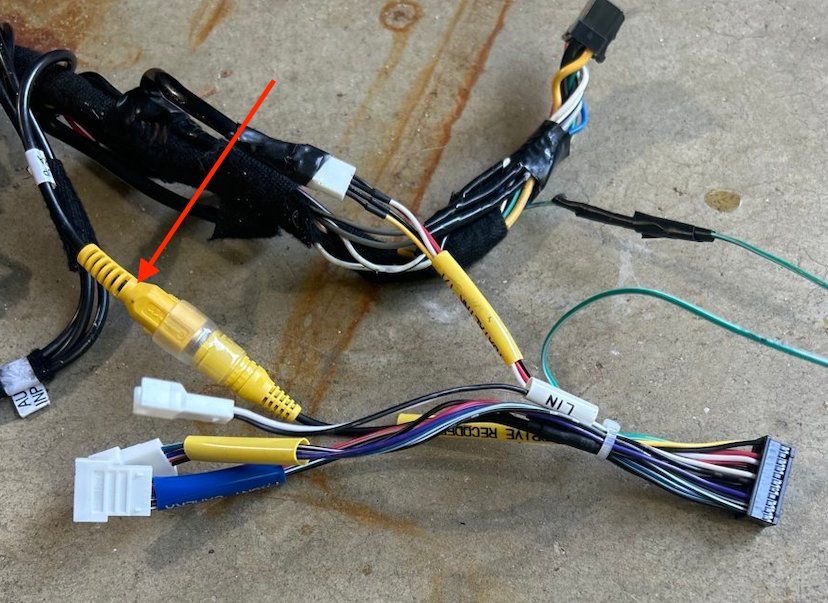

    image.jpg Ok it’s a rats nest though

    Is the red arrow the lead from the reverse camera feed?
    bulldog93 and TaquitoBandito like this.
  6. Aug 19, 2023 at 3:38 PM
    #966
    TRDFerguson
    Oct 18, 2018
    #20730
    10,900
    Jake
    Southeast Greater Basin, AZ
    2018 MGM CrüeMax
    I see the problem lol

    The suspense is killing me...ROFL

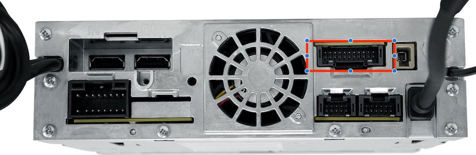

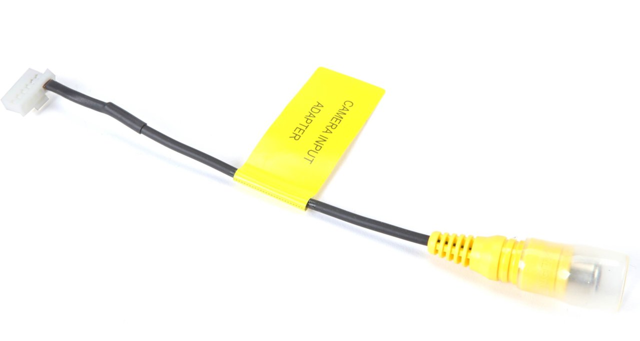

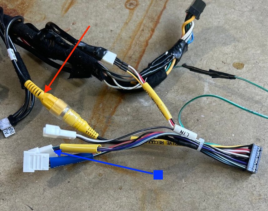

    Anyways...if it is the camera feed from the truck, you're currently inputing the signal into the "drive recorder" input, which is used for Alpine's DashCam..
    in the box you should've received:
    Use this and plug it into the the mating connector with the yellow identifier that says "rear camera" blue arrow...
    then transfer the camera feed into the newly installed video adapter.
    Let us know!

    I got it as soon as you made the first comment - note to all = do NOT assume all yellow rca’s are created equal and actually look at the packages sent with the head unit
    thanks all

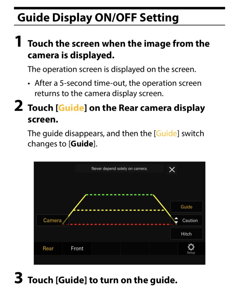

    Anybody know a way to shut off the grid lines on the backup camera feed?
    My Chong Chong brand aftermarket camera has them baked in and now I have two sets of em. Previous headunit (also Alpine ILX series) had a setting to turn grid lines on/off. Not finding one here.

    My RTFM moment came up with…

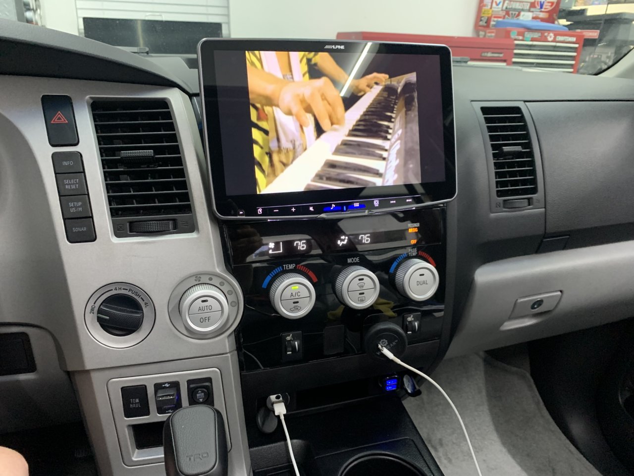

    And done....

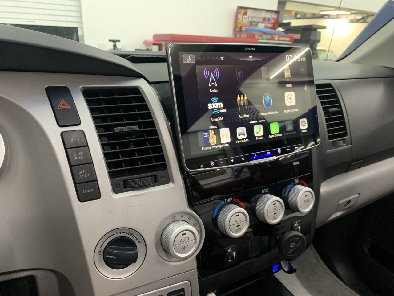

    Best $400 I have spent recently and I owe it all to this thread.

    I got the apple adapter today; it will mirror the Amazon prime screen and pause when it starts playing. Once I hit play it defaults back to the Home Screen. Does it every time. So I know the feed is working but for some reason won’t allow me to play the video. Any ideas?
