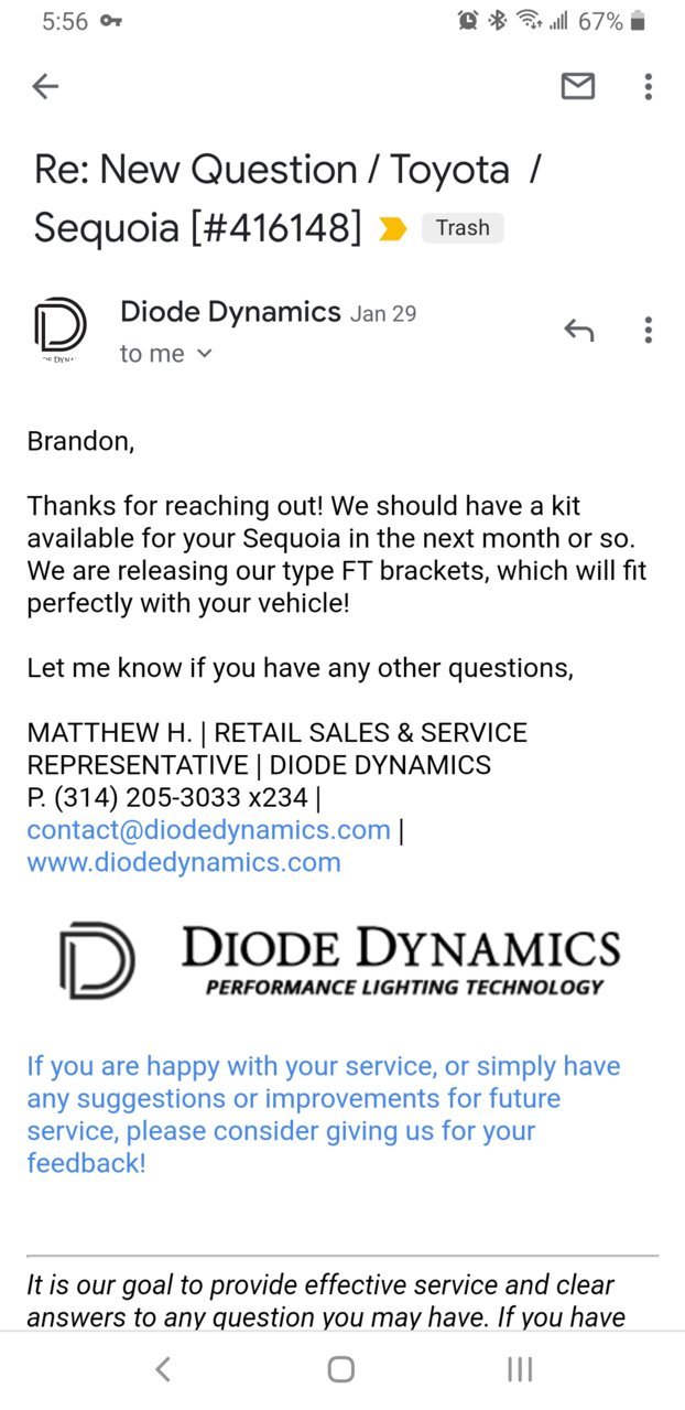

    The ss3 are out. Just not the gen 2 specific bracket. They are working on the bracket now. Hoping within the next month or so for release.

    Soo... you're saying they're NOT out yet for the 2nd gen? And that they should be out in early 2020?

    Screenshot_20200211-175644_Gmail.jpg Yeah. I emailed them and thats what they said.
    Here is the screenshot of the email.

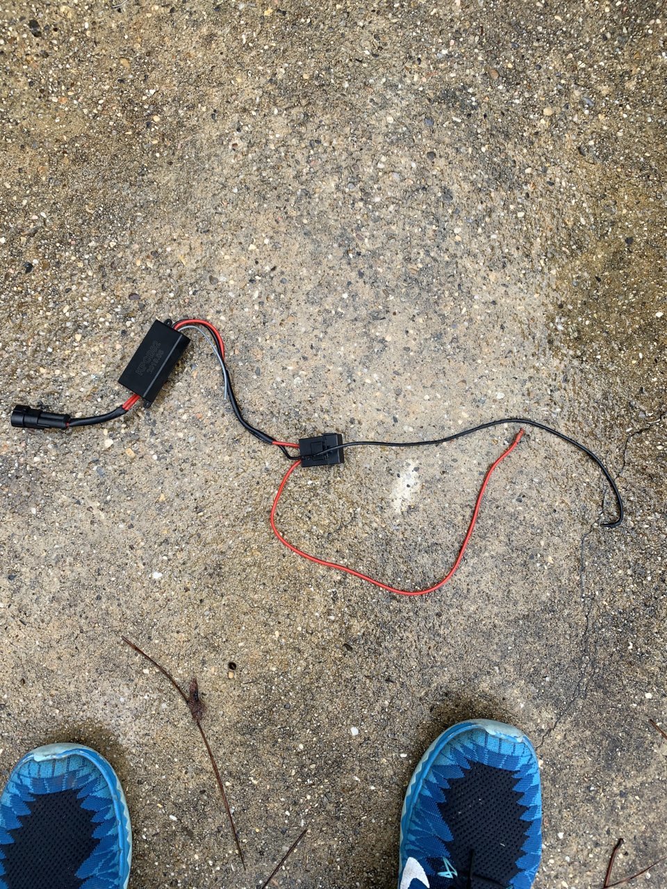

    Apparently, it's in the harness. Others interested, see this link. Thanks @BrandonL812 for the replies.

    I would imagine this is down to internal wiring. https://alpharexusa.com/how-to-wire-the-drl-harness/ Take a look at the table on the DRL operation. It switches from high intensity to low intensity when the parking light is switched on. I would conclude that it's using the parking light signal as an input to switch the DRL from high to low. A quick way to test this theory would be to disconnect the small parking light connector and cycle through all the lighting positions. If the DRL doesn't dim that would indicate that the parking light is indeed the source of the "dimming signal". To theorize further if that is the case, you would need to modify the internal wiring/circuitry to accomplish no dimming of the DRL while also keeping the functionality of the small corner parking LEDs. That's just my idea but I hope that's clear enough.
    They do have their own wiring harness but from what I can see the only signal wire to the DRL harness is the grey(ignition) wire which is used for the "start up light sequence" also this is a quote from the link posted above.
    "If you do not wish to install the harness, the only function you will be missing is to have the DRL run at high intensity while your headlights are set in the off position and the engine/ignition is on. If your vehicle’s lighting is set to the automatic setting, all functions will work as normal."
    With all that said I would conclude that the DRLs are modulated between high and low based on the voltage at the small parking light connector. What reinforces this idea is that the turn signal bulb is completely independent of the DRL wiring so would have no influce on the DRL state.
    Would anyone be willing to test this out?

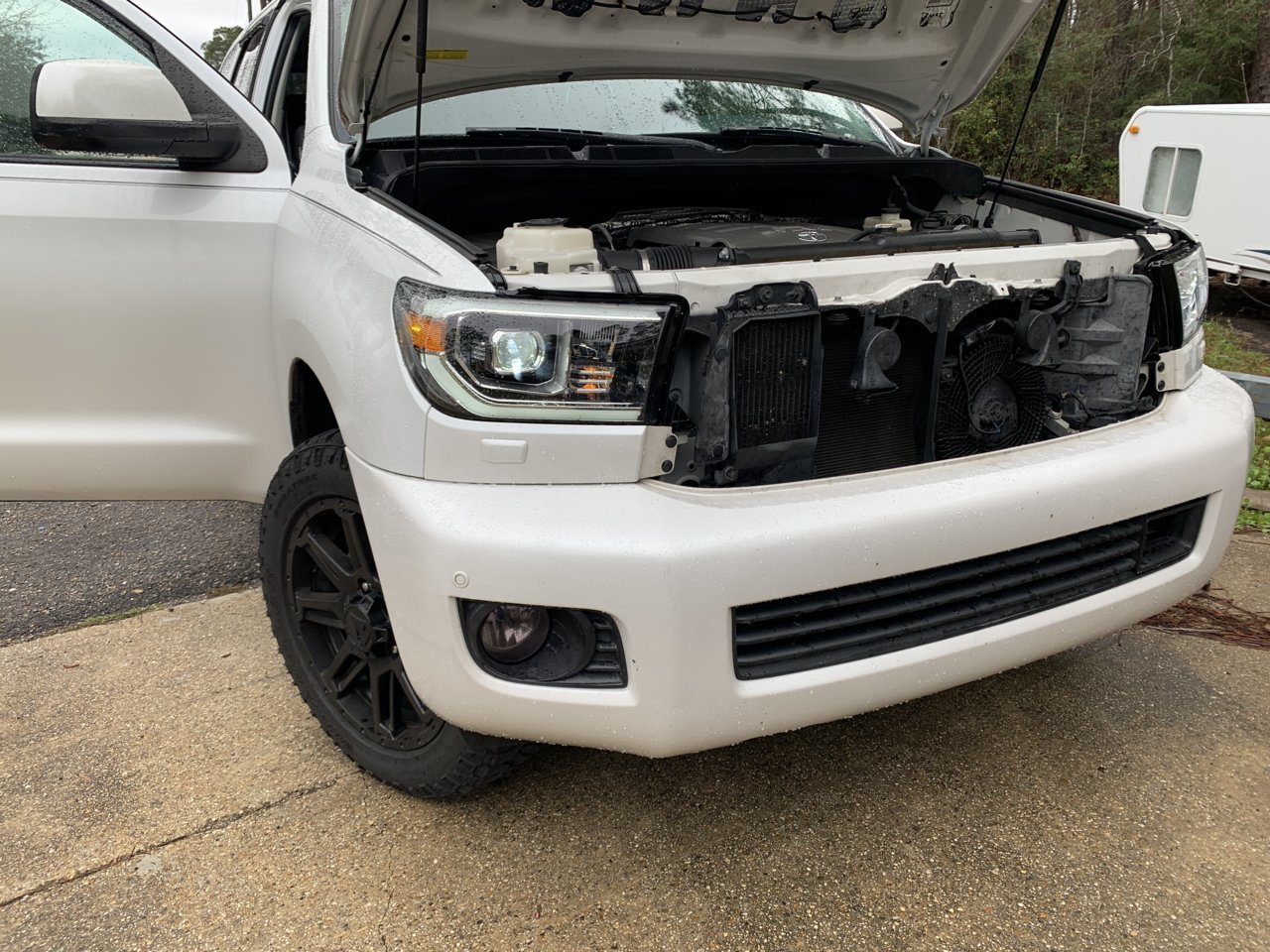

    I wanted to give a small tidbit of info that I discovered last time I had my headlight assemblies off the vehicle for the Hikari LED install:
    I initially took them out to make the swap only to discover that the initial set of bulbs sent were bad...so I reinstalled them with the halogens in place for the time being. The next day while walking by my truck I noticed that BOTH housings had condensation. Up until that point I had been moisture free, so I figured it had to be something that I did. To make a long story short, the parking light socket doesn't quite fit as good as it could (maybe due to multiple disassembles) and you need to ensure that it is well aligned and has a tight fit. Inspect this part thoroughly because a small gap WILL allow condensation in the housing. I actually noticed that both of mine had small cracks in them at the O-ring surface in which I used a dab of plastic epoxy to fix. After reassembly, the second time, all is good again. I hope this helps someone.
  22. Feb 12, 2020 at 8:56 PM

    So the small parking light socket gap can be "closed" by realigning? Sounds like there might be too much slop and the gap might form again?

    Yes, the issue is that there is no stopping point (at least in mine) for the socket. It will just spin until the holes and tabs line up again and loosen up. If that makes sense. Basically, I can only put it in and turn it a few degrees so it is nice and tight. It doesn’t thread in and get tighter the more you turn it.

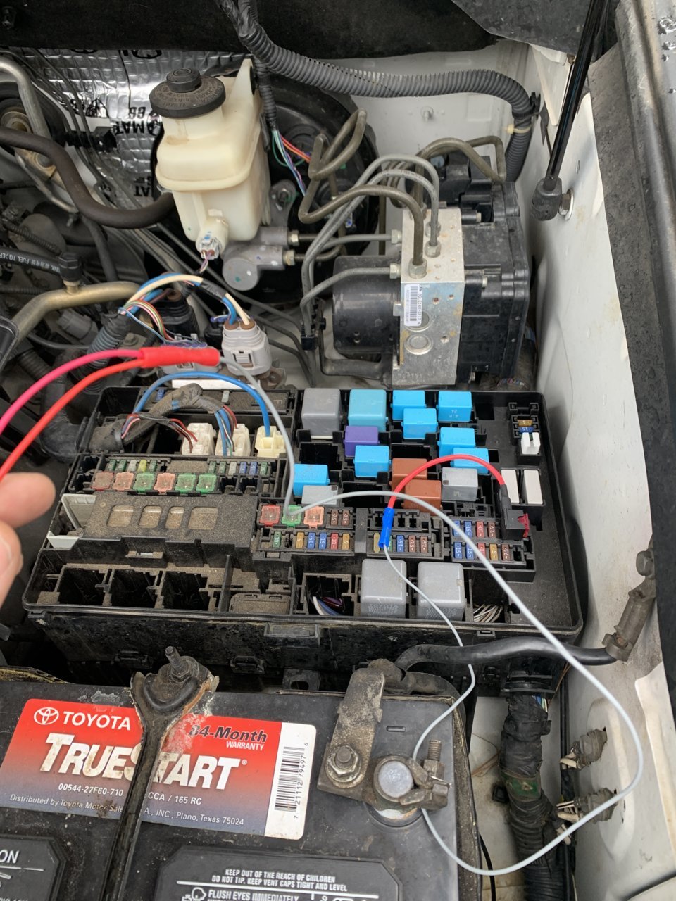

    DRL bright all the time mod complete....it was so easy, you really can't call it a mod. Basically, what I did was cut the whole "brain" part of the harness out and put the 2 red wires from the DRLs directly to the gray (ignition) wire. The DRLs turn on full blast all the time. It also has no effect on the "knight rider" startup sequence. IMG_9905.jpg Pics attached.

    There's no modification necessary to the fuse box. I had pic earlier in this thread that shows the wires draped over the side. The lid to the fuse box will clear no problem.
