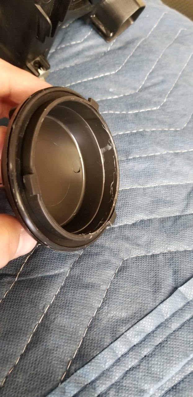

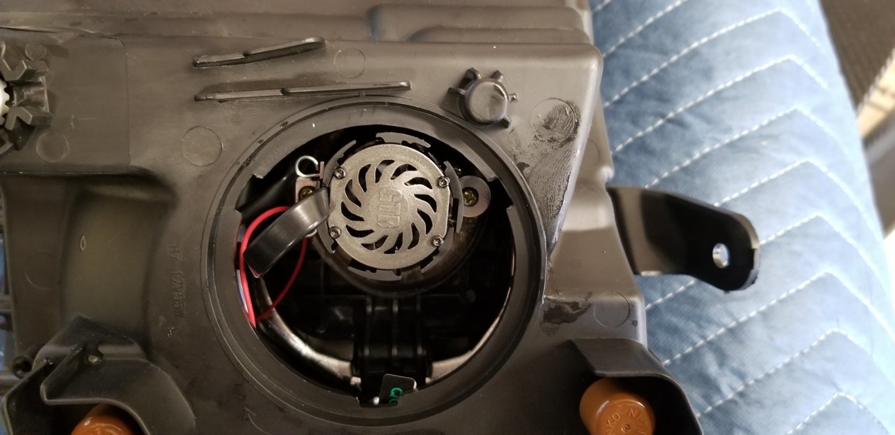

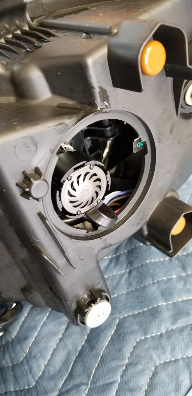

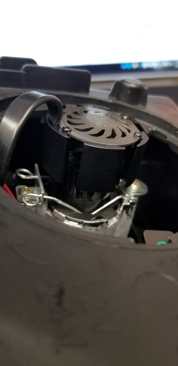

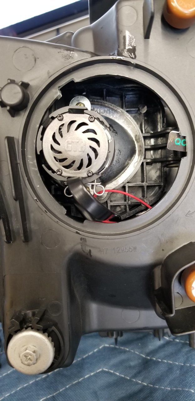

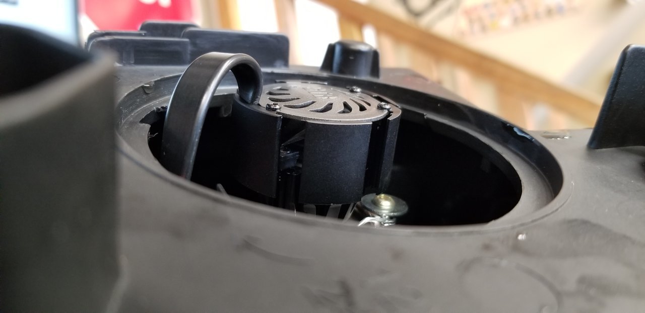

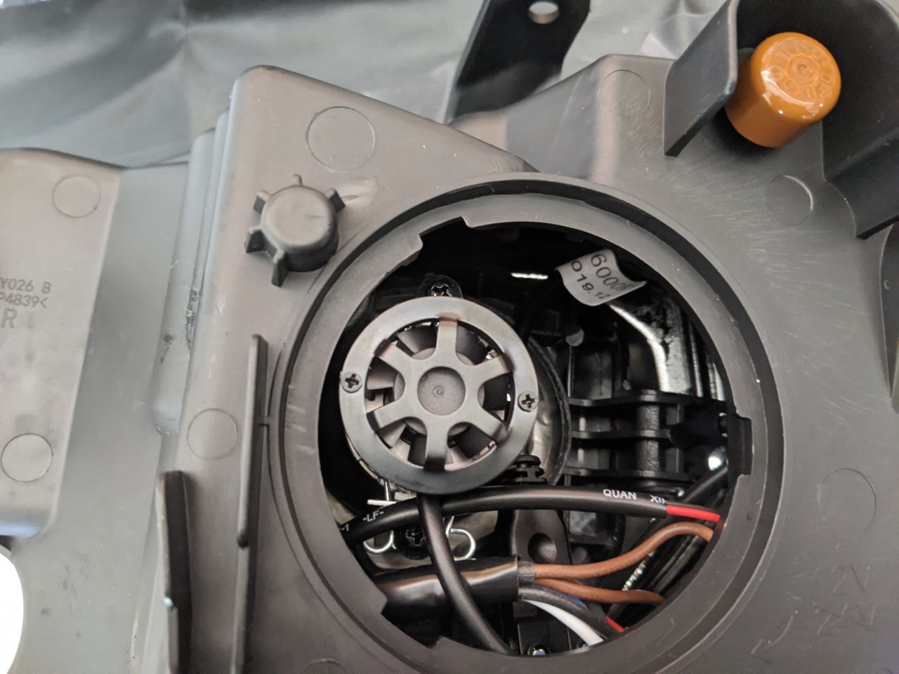

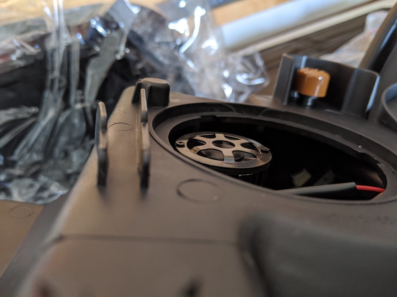

    Alright, I just took the headlight out to grab some pictures. These should better illustrate the tolerances between the dust cap and the LED heat sink. This should also give everyone an idea of the usable space inside the headlight housing. Notice you can see the scratches in the dust cap from it's contact with the heat sink.I hope this clears up what I was trying to explain.
    20200201_110807.jpg 20200201_110820.jpg 20200201_110848.jpg 20200201_110924.jpg
    P.S. It's quite nice to have a PC in the garage, you'll never regret it.20200201_110640.jpg

    Awesome pictures (including the PC setup)! That clears up a ton. So it's not axial clearance that is the major fitment concern - it's radial clearance.
    Based on the scratches on the inner diameter of the cap, it looks like the cap is deep enough that there is some airflow allowed behind the bulb. The scratches don't go past that step which is maybe 1/4" deep by the looks of it. While not the best case, it's certainly not the worst.

    Correct, that's exactly my feeling. If the dust cap was centered over the bulb I'd be happier but, the fitment could be much worse. As it is now I don't think Ill have to worry about it.

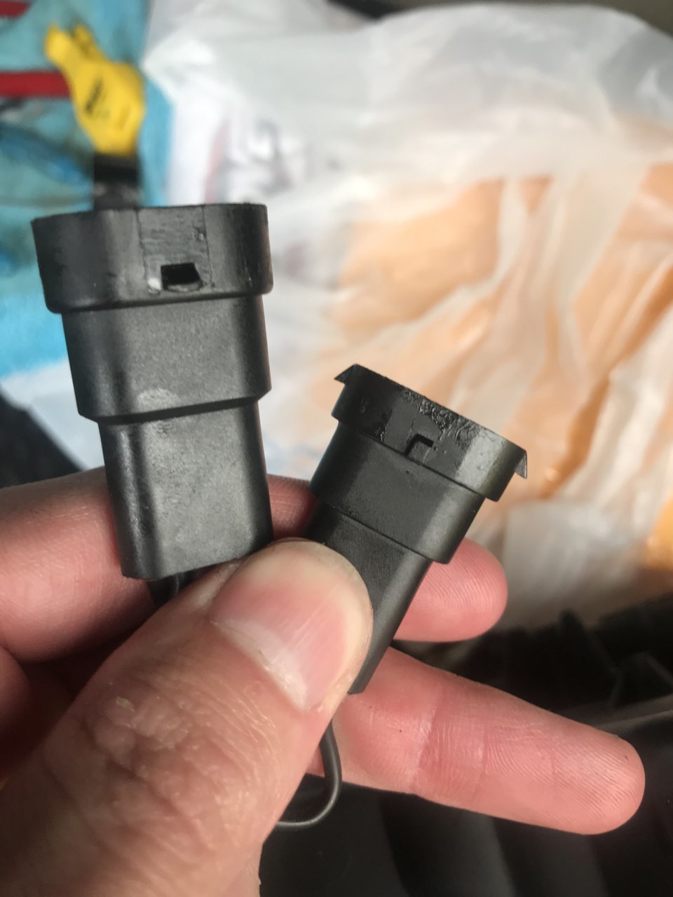

    For future clarification
    Can somebody pretty please post a picture of their plugs on their Alpharex lights? I was told by Alpharex that I should be able to reverse my plug ins and be good to go. However,my current plugs won’t let me do that. They have the “nubs” that latch onto the clips and I can’t get them plugged in if I turn them around
    The tech kept trying to tell me wires and color codes to look at and match up,but I politely told him I had already taken the lights out of the vehicle and was not going back out there since I was frustrated.
    They are sending out a new pair and hopefully that will eliminate The issue.

    I don't have a picture but I can confirm that I wasn't able to swap the hi and low beam connections due to the "nubs". I wasn't trying to swap the leads I had just accidentally tried to plug one into the other. That's when I discovered they couldn't be swapped. Now MAYBE they could be forced to fit but, but I won't be willing to try on my set.

    Couple problems I had:
    High beam connectors wouldn't engage on both sides. Ended up pushing a pin out on the Alpharex connector trying to force it and had to refinagle the pin back into the connector to engage.
