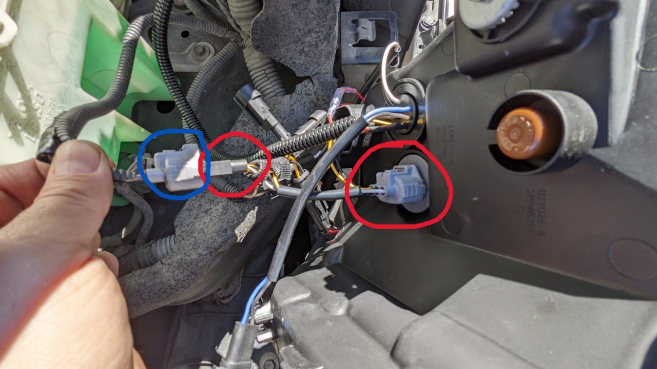

    Ok, I’ll have to look at it tomorrow, thanks!

    And make sure every harness on the headlight is connected. I had left a couple of harnesses unused thinking they were for other models because I watched the wrong YouTube video. My symptoms were similar to yours.

    thanks a lot, that was it! I was thinking my lights didn’t come with the sequential blinkers for some reason so I ended up plugging them into themselves. I will make a note if anyone wants to drive around with the amber halo on all the time, just plug the light into itself(of course you’ll have some other issues along with it)

    This is the same thing that happened to me. The listing from alpha when I bought was vague. I ended up retaining my leveling feature also. Very happy with mine so far

    I did not see anyone post a picture of how to wire the harness for the Alpharex Pro's. If it has been posted I apologize for a repeat. I just installed mine yesterday and started searching the Tundras.com forums to figure out why I was getting the dreaded amber halo instead of the bright white. Lo and behold I found my answer on this thread back in the 453 and 454 thread I think it was :monocle:.
    The instructions, as been discussed, are a little vague. It needs a diagram of this photo in them as well, in my opinion. To my point, the RED circles are the harness attached to the Alpharex assembly, the BLUE circle is the harness from the truck. The picture shows the grey plug from the assembly going to the bulb, and the black plug from the assembly going to the grey plug from the truck. This is the way.
    Another issue I have seen, is the yellow plug it says that is not used. If you read the instructions it does indeed tell you to plug in the yellow plug on the side closest to the DRL module as you can't plug in the other side as shown in my picture. I hope this helps, thanks!

    My harness must be different because no way I can hook it up like that. The arex connectors can only go together and won't fit my turn signal connector or vice versa. Not sure if there if the instructions are different for the sequential and non sequential turn but I have the sequential or I should have the sequential assembly.
    Man not sure why I can't get this high beam to properly click in place.. already spread the pins out and still won't turn on. On pic it looks like it should be fine to connect.. my old spyders click in fine and also have the the lines to align with the factory connector 2 slits.

    Finally got my high beam connector to click in place.. guess it needed even more separating or the pins. Now to adjust the beams they are aiming super high.
