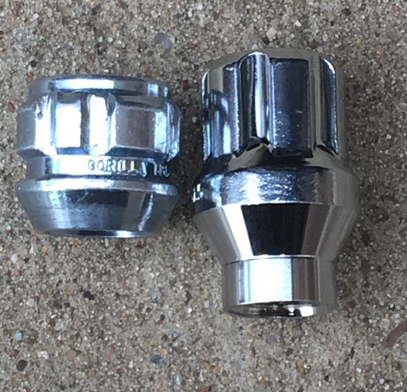

    May or may not be related:
    I had bought some aftermarket wheels for my 2014.
    I used the stock 285/55/20 KO tires on them.
    The stock lugs were quite a bit shorter with the new wheels.
    And the rear was shorter than the front.:confused:
    88C2974C-7D8E-4E7E-89B8-E5E7687F0FAE_zps_62889b6ae014528084ea587f9dce7115a72af0cf.jpg E429CC0D-E4A8-40C6-800C-DFD0FD96FBC8_zps_c43036d0e6b8c7f9da3bc1ba6be766a0f6d35813.jpg
    Ended up with extended lug nuts.
    D9151B90-57E2-46F2-8944-5AC340E7CF8C_zps_b8cae7f21307f72884238a14eecd64d6249b7f97.jpg

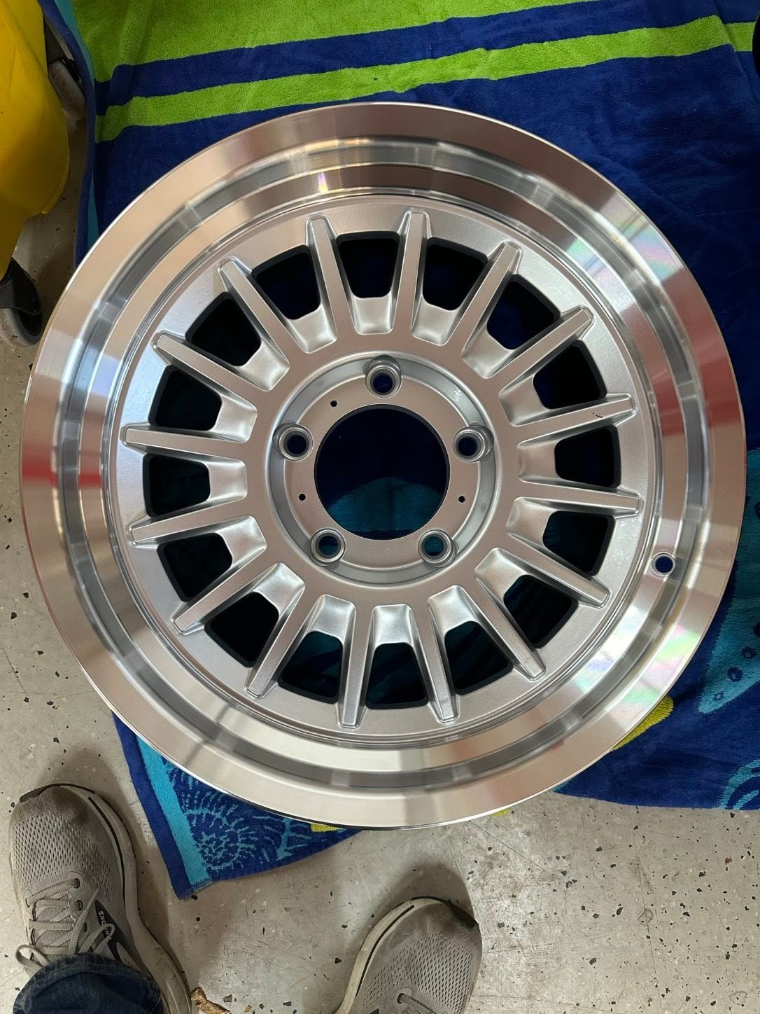

    Just an update: I got my new aftermarket wheels in about 2 weeks ago. Unfortunately two of the wheels were blemished, albeit pretty minor but I had to decide if I was going to keep them. I worked out a deal with the manufacture and decided to throw them on today.
    I wanted to use oem studs with this new set up. However once I mounted I didn't feel there was enough thread using the OEM. So truck is still parked and I'll be looking into longer aftermarket once again.
