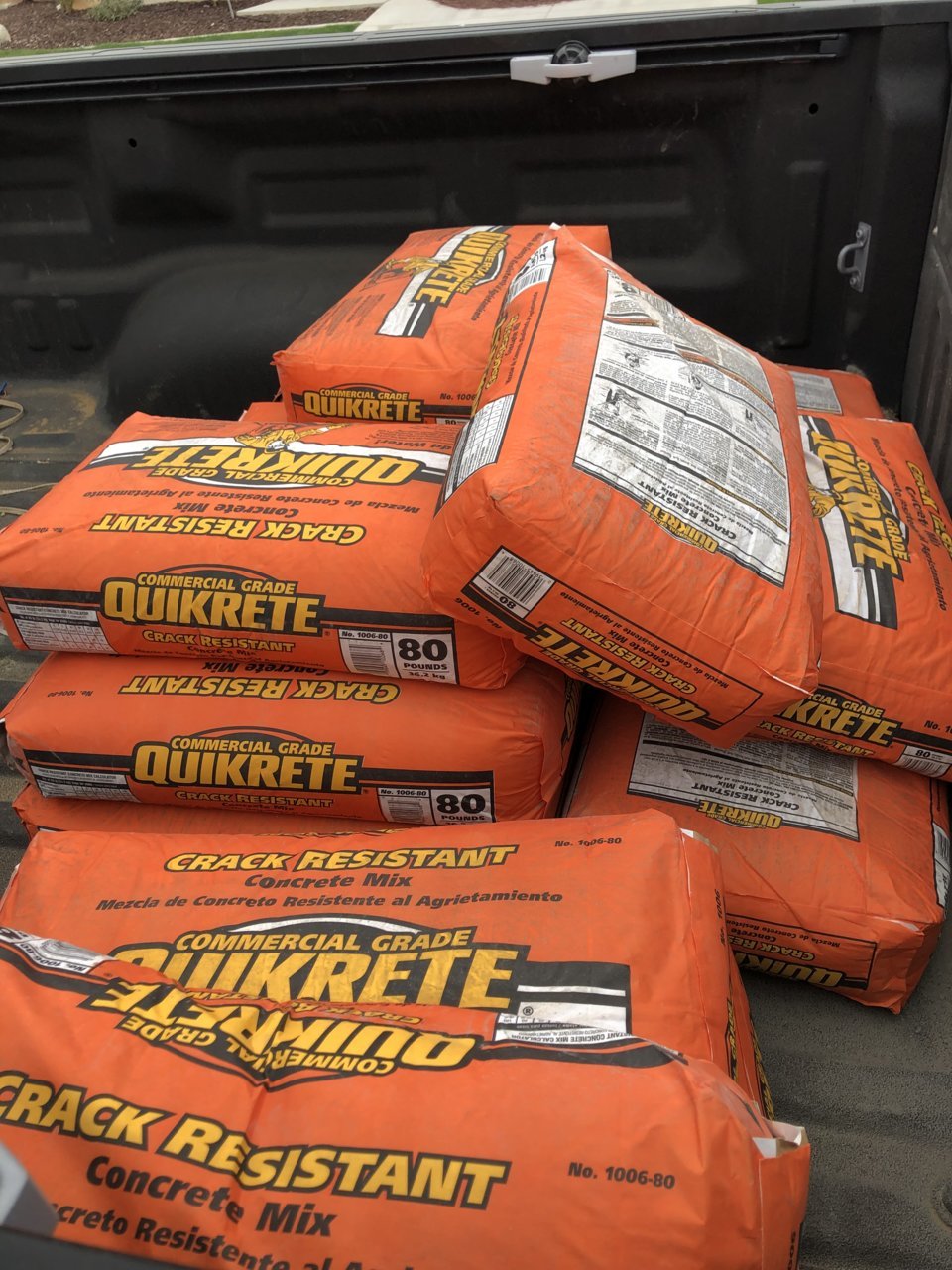

    Only 1200lbs. 7x1200 total tho. Would do more but unloading off truck by myself.

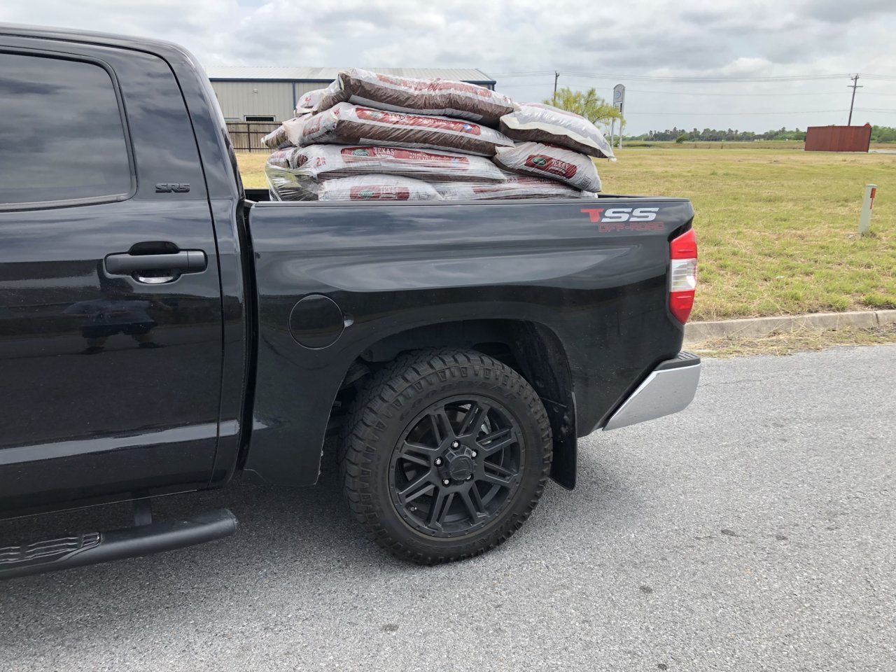

    Split it into two loads for the second pallet that’s what 30 bags looks like.

    I see that Texas mulch! What part of TX are you in?

    Still might be overloaded with you in the truck. There is a sticker on the driver's side door post that tells you what your payload is for your specific truck. On my '13 CM, the payload is 1325 lbs on the sticker. I added about 100 lbs of skid plates and a spray in bedliner, so it is a little lower than that.
    You said each bag weighs 44 lbs. 30X44 = 1320 lbs. Add your own weight to the mix, and you are pushing the limits of the advertised payload rating for a CM SR5 4X4 of 1560 lbs. I am betting that your payload rating is lower than what is advertised, since you have the added weight of the nerf bars.
