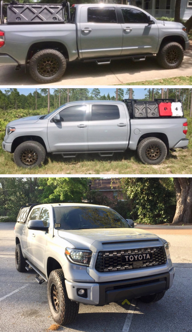

    do you happen to have a picture of your set up?

    Thanks, that looks like the perfect size. Does 285/75r18 fit under the bed for a full sized spare?

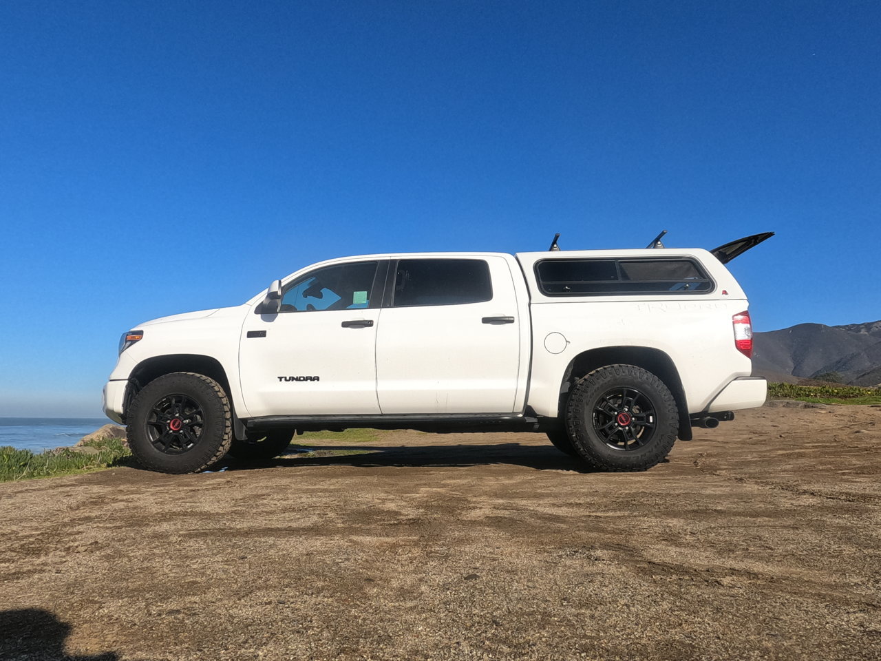

    I have 285/75/R18 Duratrac spare on the stock steelie tucked under the bed, fits fine but I don't think it will with a CB shackle.
    Really digging Duratracs, went from stock Mich to 275/70/R18 KO2s (which I also have on my 4Runner) and while they perform great off road they are stiff.
    I then tried 295/70/R18 KM3 and ditched them within a week, off road performance was not worth the ride on my daily commute. Compared to them, no AT tire is loud, braking distance was increased, handling/cornering sucked, did I mention they were loud?
    I now have 285/75/R18 Duratracs, will be putting them on my 4R as well. I've been in dirt, beach sand, snow (on and offroad) and daily them on pavement and have no complaints.

    Thanks @woofhauler I appreciate your insight. I'll probably go with this size but have been leaning towards the cooper at3 xlt. Is your suspension set up completely stock on your pro?

    Yes totally stock 19 Pro minus front flaps. No trimming, no rubbing.

    Yes it will fit. It also fits with coachbuilder shackles you just have to widen up a few spots with a hammer.

    Where'd you widen out? This is only reason why I'm stuck between 295/70 and 285/75 but want the narrower tire. I'd get 285/70 but don't want a MT or ridge grappler.

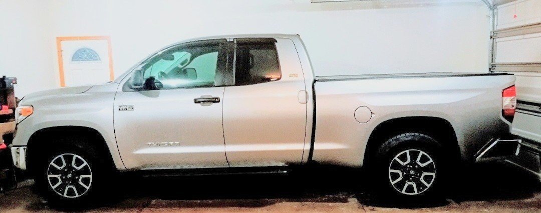

    can you post a pic of your new tire setup? Thanks

    Sure! Here you go.
    I like the 70's over the 65's because they fill out the wheel well better and ride even more smoothly.
