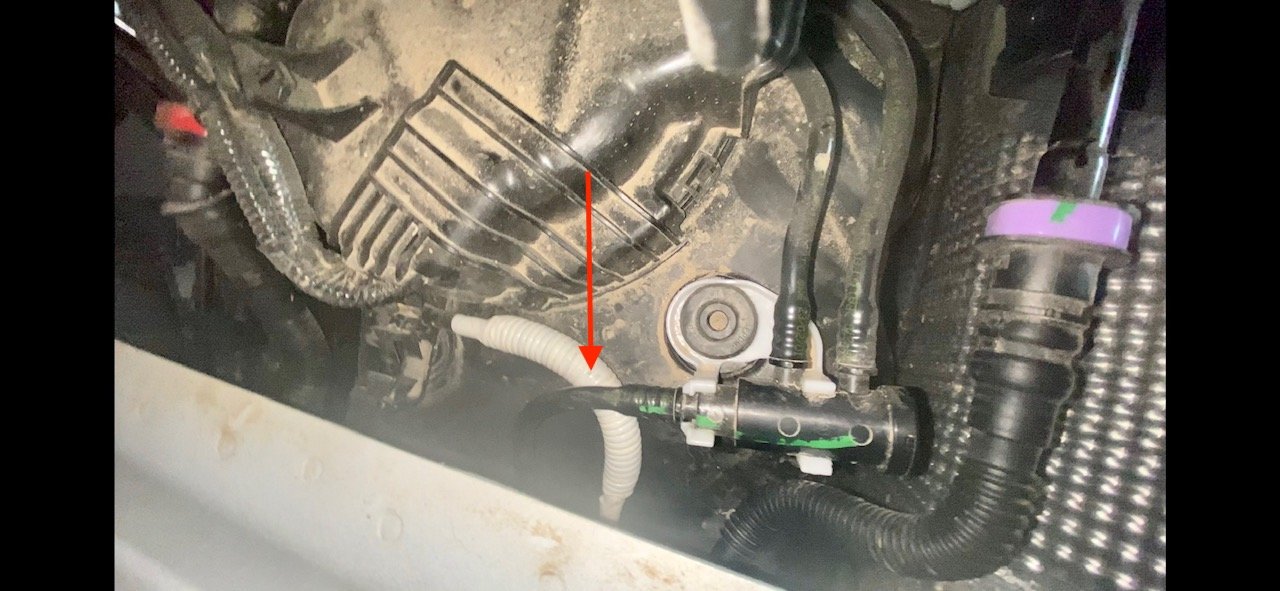

    My June 20, 2023 build isn’t showing this recall notice on the app. I’ll try to crawl under it tomorrow and get a pic of the area, if I can get my big mitts up there.

    OK, it took a few attempts, but I think I got a pic of the same area on my June 2023 build with no recall notice on this fuel leak problem.
    It appears their fix was to add a protective sleeve to one of the lines that I don't see on the previous pics.
    Hope this helps.

    Thanks! I really appreciate this. Going to share with my sales guy and service manager, I wonder if something like this will be the temporary fix for the recalls or the permanent fix. I got the impression permanent will be a new line from the documents but I'm sure that's still up in the air.

    As I see it, Toyota was clearly aware of the problem when they built my truck in June. I can’t imagine they would build it with a temporary fix, only to have to recall it later. My guess is this is the permanent fix, but Toyota is dragging their feet because it will require dropping the fuel tank to add the sleeve, which is going to be labor intensive.

    Seems odd to me they covered the metal brake line and not the plastic fuel tube. Now the plastic fuel tube can still rub on that sleeve which might not be as harsh as metal, but still. Sleeve should go on the plastic line. Methinks Toyota needs some new engineers.

    That was my first thought too. Then I considered that brake fluid can get hot, and even boil, in extreme situations. Perhaps the sleeve serves more as a heat shield than a rubbing shield? Who knows. I’m just happy my truck has some kind of fix, so I don’t have to waste another day at the dealership.

    From the driver's side of the fuel tank, look for a square shaped raised flap in the heat shield about 18" forward of the rear axle. The area in question is right behind that flap. I reached up and over the exhaust and driveshaft. I used my phone on video mode set to 0.5 magnification, and kinda just waived it all around while recording. Then I captured a screen shot from that.
