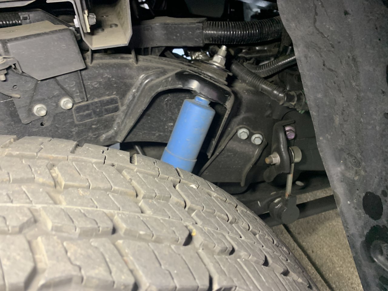

    The posts with the pics on the previous page tell you where it is. Looking at the rear passenger wheel well from the side, going straight towards the center of the truck. Just on top of the frame. One of Tony's later posts shows exactly where to approach this. You can't get in there with a cell phone unless you pull the wheel. Maybe not even then. My photos were with a borescope camera with the wheel still on.

    Matt,
    Here are some more views for the vicinity of the location:

    I believe that would be the temp fix. Permanent fix seems to be a new plastic line that avoids that interference.

    I actually made a nice little 3D printed clip that would snap onto the metal line and then separate the two lines. But I don't think I can get in there to snap it on. :-(. Maybe I'll try one of these days but I am not as spry as I used to be.

    interesting there’s an empty hose clamp right there near the intersection. (Green arrow)

    Love to see and compare what your June trucks look like in the same spot.

    What would be interesting is for one of you guys with no recall get a photo of this area. I'd like to see what is different.
    Edit: I just saw that Mike asked this same question a few posts above. So, I'll say, ditto.
